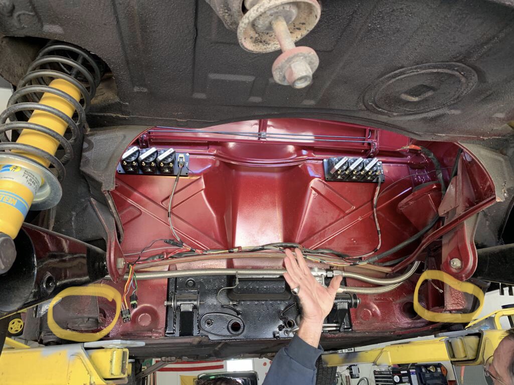

Things never go as fast as you want, waiting on my new PMO's for the 2.7 twin plug crank fire. Thanks Joe O for all your hard work.Attached Image

Why are the 4 cylinder engine mounts still in place?

QUOTE(maj75 @ Feb 5 2021, 05:40 PM) *
Not sure where you are seeing 4 cycl engine mounts?

The weld in mount came from Patrick Motorsports

Yup- what is circled is how the 4 cylinder engine mount. Those can be removed now that you are installing a 6 with the PMS mount. Give you a little more room. (IMG:style_emoticons/default/beerchug.gif)

But not strictly necessary.
