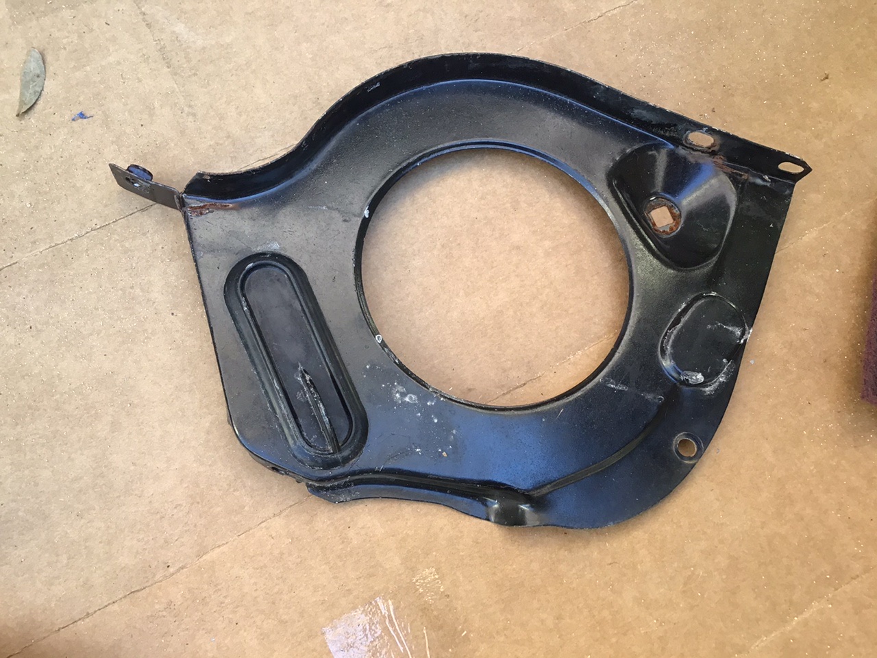

I have the plastic adjustment window covers, and the tin, I was just not sure how it all fit together because I did not take it apart.
Here is the tin piece. Which side of the tin does the plastic ring go on?
914werke
post Feb 16 2021, 09:00 PM
Posts: 11,298
Joined: 22-March 03
From: USofA
Member No.: 453
On the inside with the flared side out. Just like youve picture it above. The cover will hold it in place once screwed/bolted together
