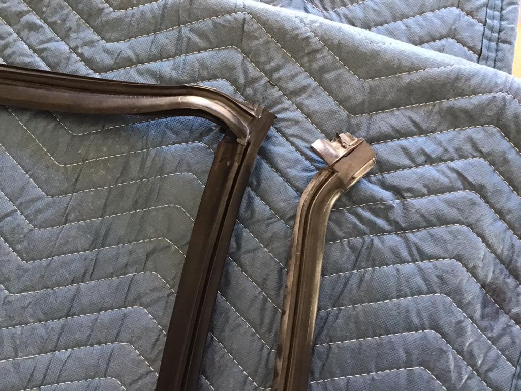

I would take installing the air box 5 times, over putting this seal in. I cannot get it to conform at the top where it makes the bend. (IMG:style_emoticons/default/headbang.gif)
I have tried heating the rubber in this area to get it to conform to the bend without any luck. The 914 rubber piece is reinforced in the exact location that it needs to make the bend. Not sure what to do at this point. (IMG:style_emoticons/default/hissyfit.gif)
You can see where the original piece is bent.

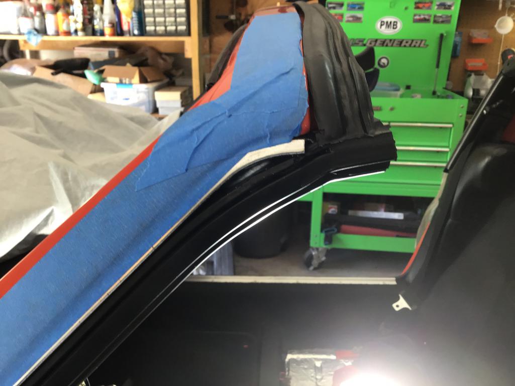

I did this about a year ago, work from the top down, fit the curve in first and don’t stretch it, eventually there should be extra that you will trim at the bottom. Take your time, tape the edges.
Your photo shows that the top corner is not installed correctly, the edge of the rubber should be perpendicular to the ground so the roof weatherstripping butts up against it.

QUOTE(mgphoto @ Apr 3 2021, 11:39 AM) *
Exactly, if the piece fit up into the curved area it would pull that piece down into the proper location.

I did this fix very recently and found that there is a small tab or blade of metal on the body at the two channel tops that became my starting point for installation. I pushed the 914 Rubber piece onto that tab, (and there may be a screw involved on some cars) and then proceeded to manhandle the corners into their correct fit.
The middle top of the seal was dangling as were the two channel pieces at that point but the two corners were tight and felt and looked rightish.
I used a mixture of fruity soap, hand lotion, green liquid dish soap (color matters) and beer to lube the vertical channels and me and then pushed the interior side into the channel inch by inch with a well rounded 9" long plastic tool (used in the Tiffany method of stained glass/ copper foil artwork).
Then with the careful application of more and more beer, and a careful dousing of the lube recipe noted herein, i pushed the exterior side of the channel-rubber into the aluminum channel. From the factory the aluminum channel is crimped to trap the factory seal so gently pry open that part of the channel or you will not get the vertical all in.
Lastly, dont have any more beer and get out your new sharp 4" long blade and clamp it in vice grips, dip it in your lube solution and gently saw off the extra seal at the bottom AND NOTE HOW THE DOOR CLOSES TO FIND THE PERFECT ANGLE FOR THE BOTTOM CUT.

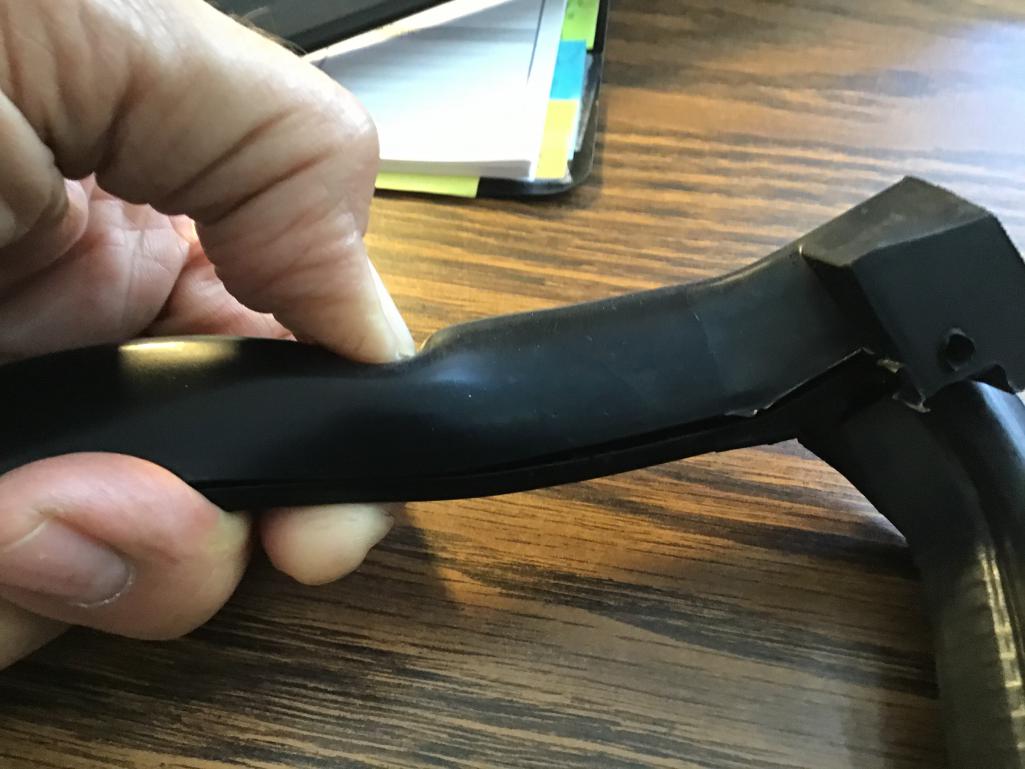

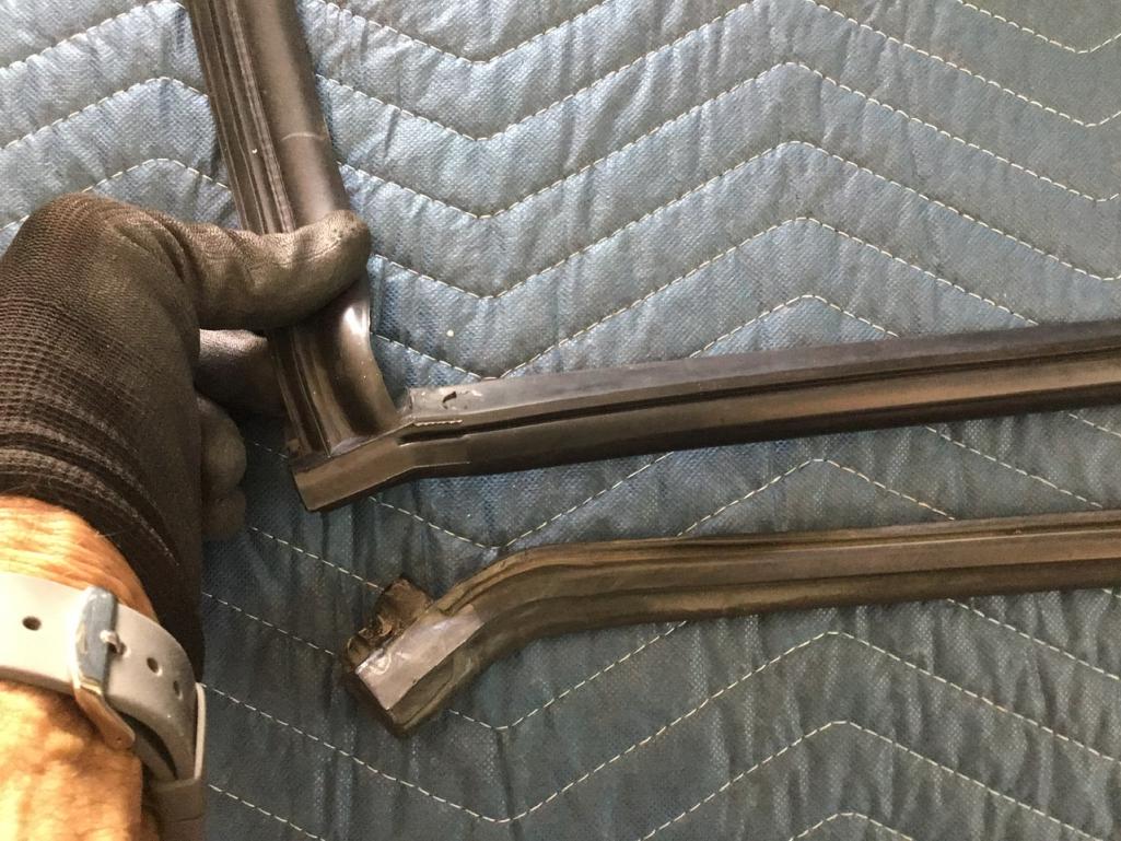

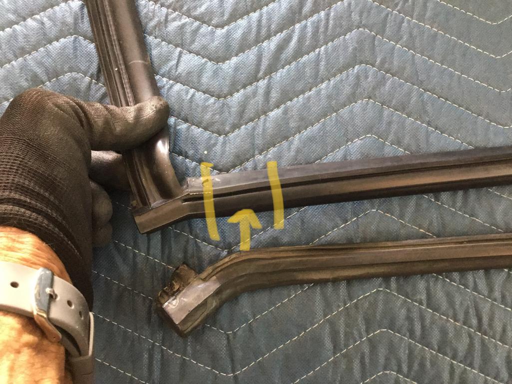

I have had success in getting the backside interior lip into the grove using soft soap but it will not stay in at the bend even after getting the exterior lip started. Once I release pressure it simply pops out of the track at the bend. My seal has a hard piece inside that is about 2” long on the left side and smaller on the right side at the exact spot where the bend is supposed to happen. It looks like this is where the top blocks was molded to the vertical part of the seal. This is not allowing it to have flexibility to stay put.
I am sorry to be a PITA but out of this entire build this piece has so far given me the most grief. I am not a dumbass hack, this should not be this difficult.
In the picture, I have marked where the hard piece is inside the rubber. Is this normal?
Thanks for taking the time.

QUOTE(Morph914 @ Apr 4 2021, 12:33 PM) *
@Mikey914 - can you please address whether the hard internal structure is normal where Morph's picture indicates it to be?

QUOTE(Literati914 @ Apr 4 2021, 06:48 PM) *
The hard internal structure is the top section. No metal or internal structure there.

Ok, I guess I will need to exchange mine for one that does not have this hard piece, because it will not bend and stay in the track.
You can clearly see in the picture where the hard section starts just to the right of my thumb.
