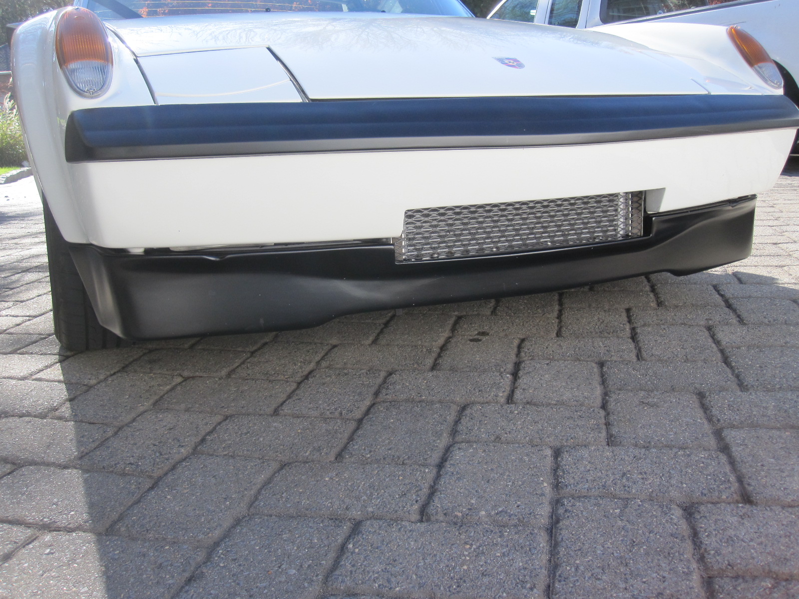

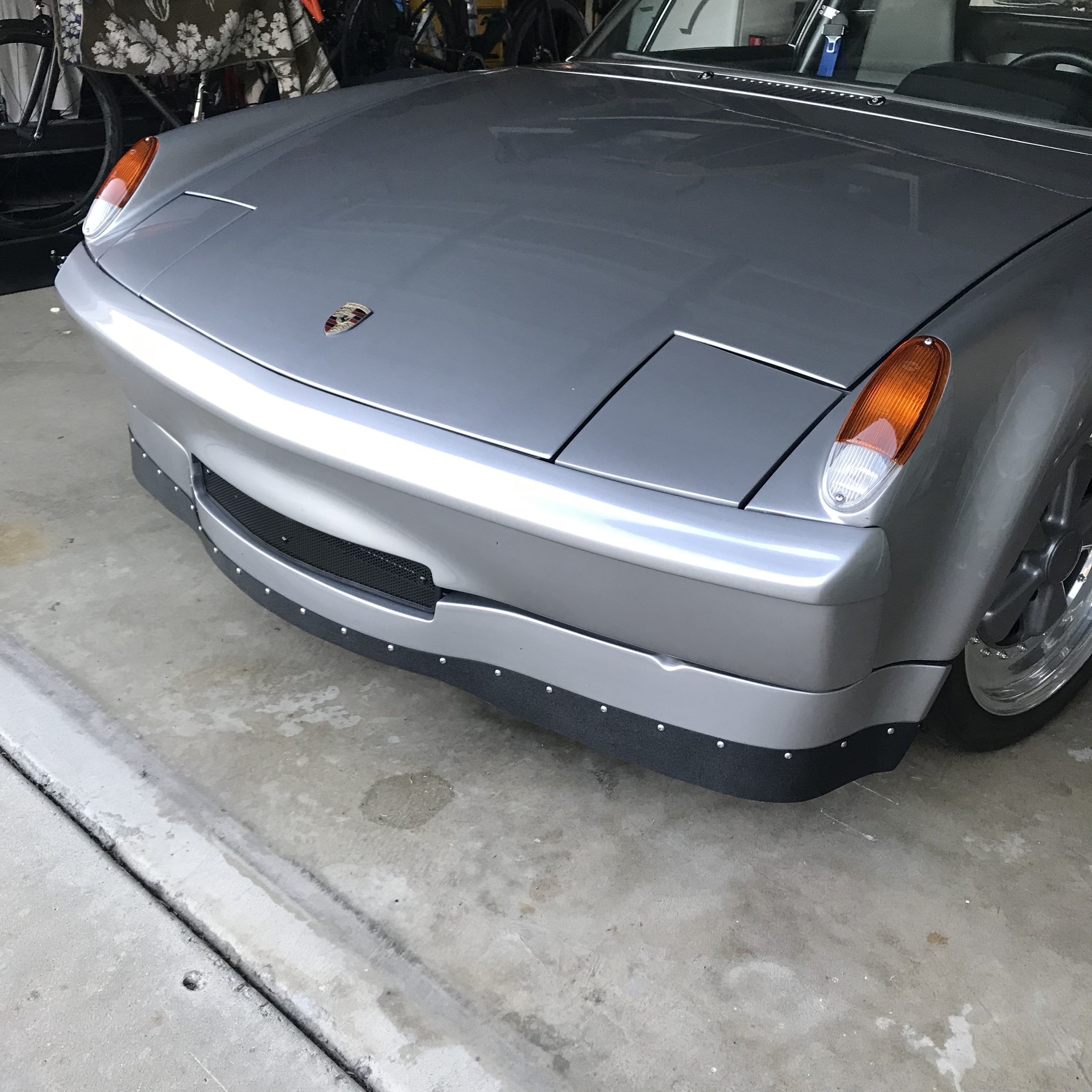

Here is mine. Front bumper one off fiberglass, lower valence steel.

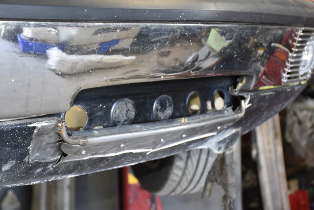

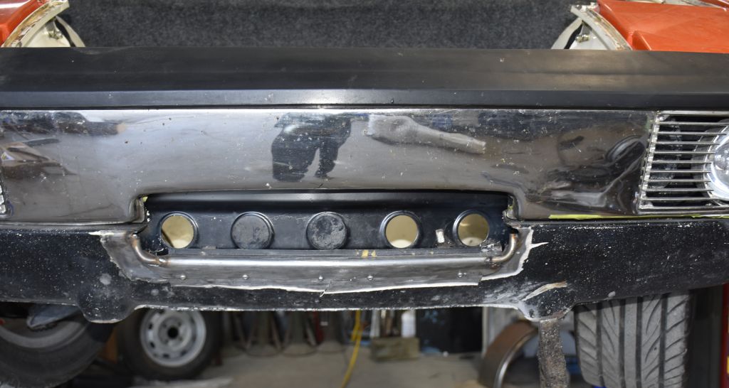

I used hammers a slap and dollies to roll the metal over, trying to get a pressed factory look.
Then welded a plenum on for the finish. Gave it the break to follow the factory stiffening breaks.
Need to make it pretty now. Steel is real!
