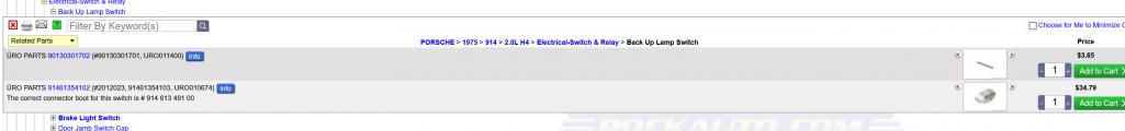

URO makes a replacement part. About $4 Cheap insurance. Screenshot from Rockauto, click to open
