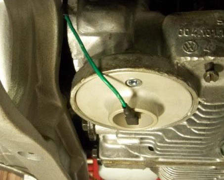

(IMG:http://www.914world.com/bbs2/uploads/post-2744-1568713265.jpeg)

QUOTE(simonjb @ Jul 10 2021, 08:39 AM) *
Sorry about that !! Too many T’s. So can I add a taco plate and install a sender unit ?
Absolutely. First check that you dont already have one installed (IMG:style_emoticons/default/shades.gif)
If not you will have a blank plate in its place.
Im biased, so Id consider the billet unit I offer over the OE piece unless you want to keep it all original. (IMG:style_emoticons/default/smile.gif)
