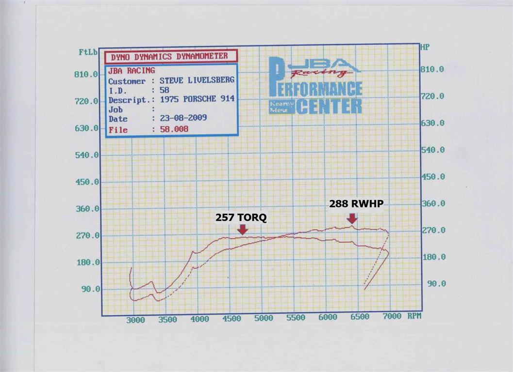

Heat is the death of transmissions and I was working it hard with a 3.4 liter twin plug at nearly 290 rwhp.

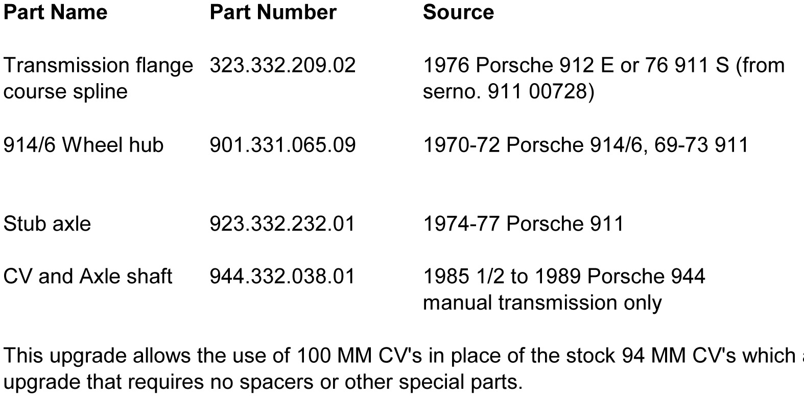

My CV joints and axles were 100 mm CV's sourced from a 944. Direct bolt-in if you also source the trans output flange and hub flange from early 911/912. Never had a CV failure.

Regarding cv's, I put this together years ago:

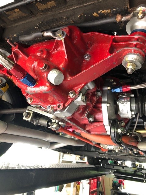

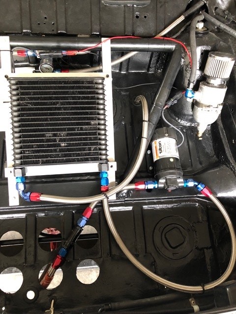

Since keeping a 901 in one piece is an old and ongoing challenge for many of us, can I add my modifications for your review and suggestions for what I've missed? I've had my vintage race 2L single plug, narrow body 914 for almost 25yrs. For the first 5yrs I ignored advice to install an alum intermediate plate, as I never had an issue. Then the gearbox seized solid, mid corner, mid race, destroying the R&P and more. I discovered the mainshaft starts dancing in the loosening main bearing, and it all blew up.
Since then I've added the following [from front to back]:
[1] Renn shifter
[2] solid firewall bushing
[3] full Tangerine shift linkage kit
[4] Patrick clutch pulley
[5] CMS intermediate plate, side cover, and mainshaft bearing retainer
[6] and new this year, trans cooler with fan [i race mainly in Canada, on faster tracks, so super hot temps are less of a problem].
More on the cooler:
You can't see in the pic, but it has an enclosed fan on the backside. I know mounting it in the trunk without ducting isn't ideal for air circulation, but I wanted it where it would be protected from damage, and as far forward as possible. And because it's a biggie [it was given to me], mounting options were limited. It only squirts the R&P, through the side cover. Activated with a manual dash switch. Driving improvements: so far, it has eliminated the baulky shifting typical late in a race. Hopefully longevity will follow.
Anything I missed? Any changes?
Thanks!
Gavin

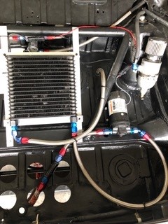

BlueRidge914
post Aug 12 2022, 12:17 PM
Posts: 12
Joined: 18-January 21
From: Ontario, Canada
Member No.: 25,093
... oops let's try for a more useful pic size
