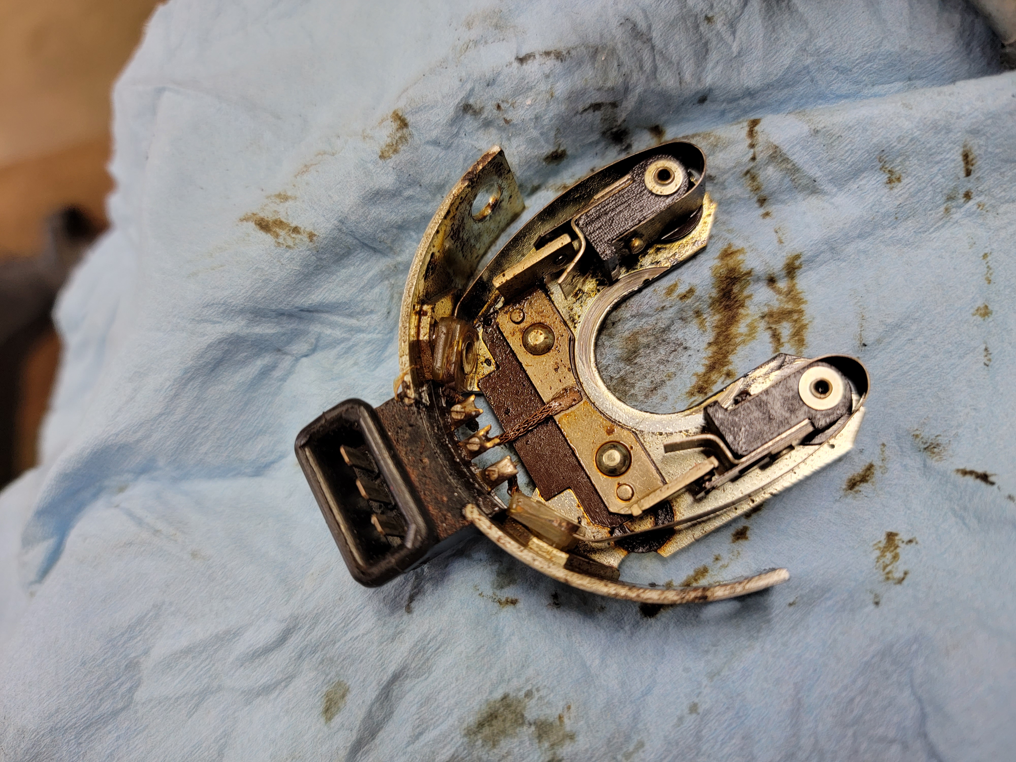

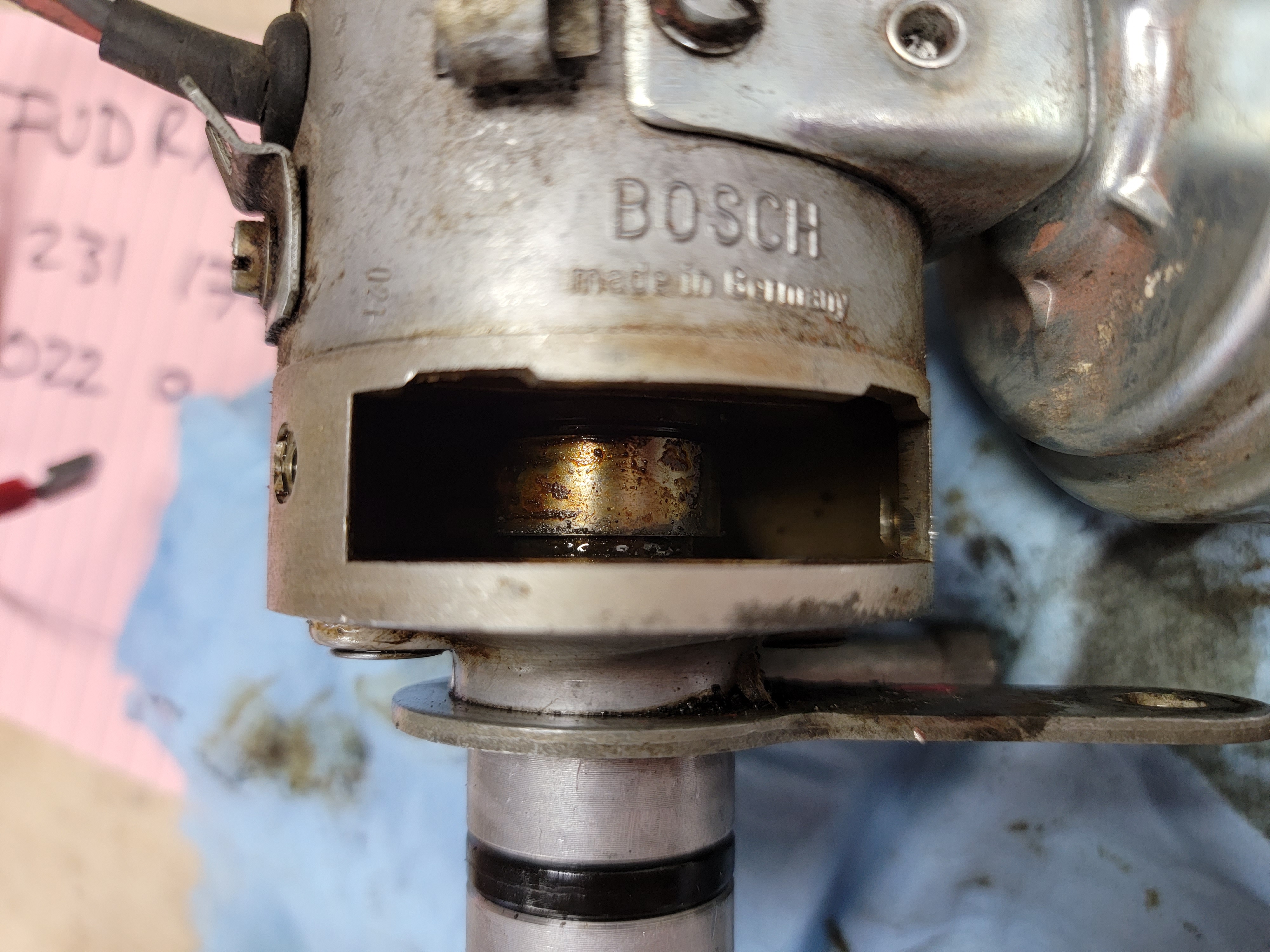

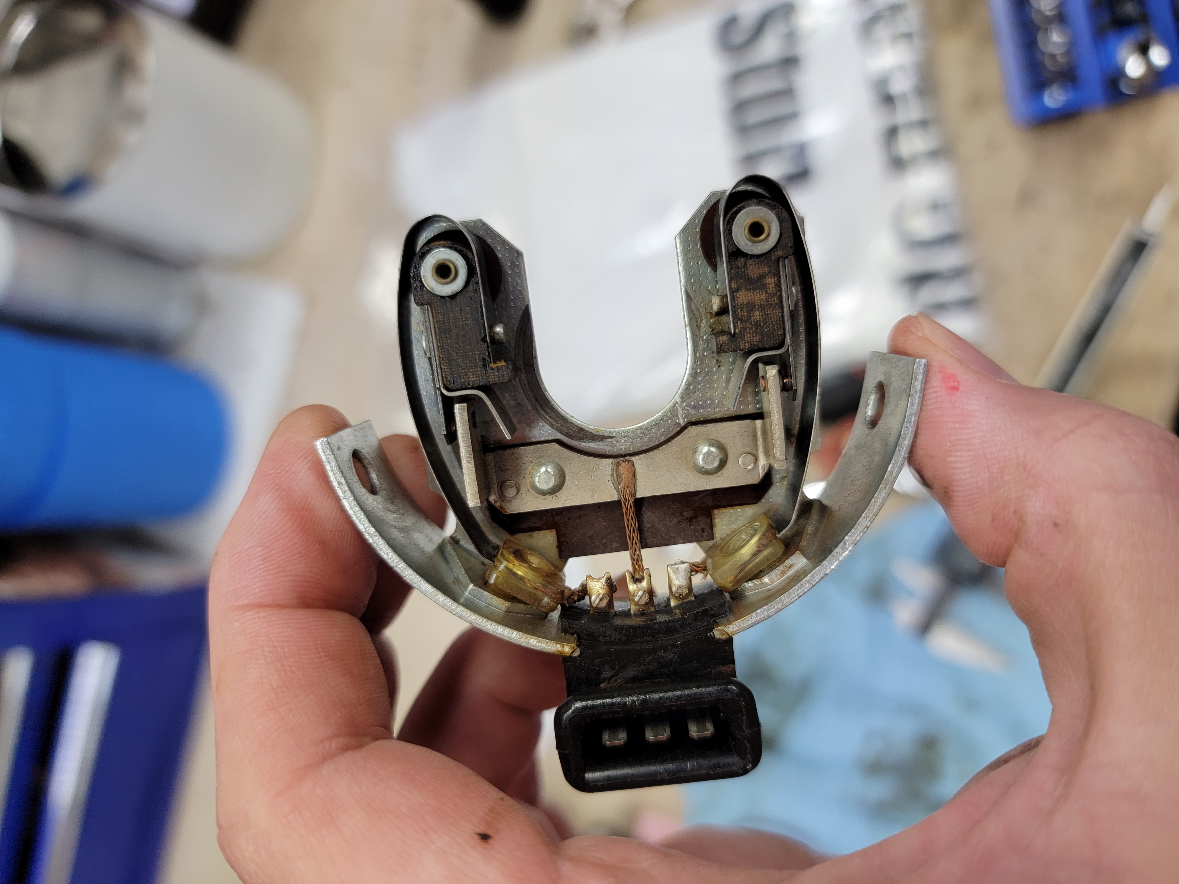

Which brings me to the trigger points. I pulled the dizzy and took a peak. The shaft and points were oily and gunky with some chunky oil clods on both. (I have never removed or touched this so it may have been a while).
Points were slightly worn and over spec. Thanks to @nordfisch I was able to fabricate the jig to re-center the points to spec. I am now waiting on some proper points grease to lube the shaft and points. Then re-install, timing and test drive.

Shaft crud upon removalAttached Image
tvdinnerbythepool

Clean baby!Attached Image
914_teener
post Sep 14 2021, 10:02 AM
Posts: 5,270
Joined: 31-August 08
From: So. Cal
Member No.: 9,489
That dizzy is worn.
Look at the plate on the trigger points.
I'd pitch it and get an electronic distributor to answer your question.
You'll be chasing your tail otherwise. BTDT.

914_teener
post Sep 14 2021, 04:13 PM
Posts: 5,270
From: So. Cal
Member No.: 9,489
What do you think? That's normal?
So you think you want to spend near $100 for a set of trigger points and what is the expectation?
Since you have the dizzy out and you see there is a problem, take care of it.
I have but only one conclusion from looking at your pictures....the shaft is worn and putting a new set of trigger points will accomplish....not a whole lot... since you asked. I could be wrong but that what it appears to be. What about the advance plate that Rich posted about....has that been cleaned up?
BTW...have you tested the vaccum advance pots on it? Because if you haven't, there could be a vaccum leak there causing your mixture to run rich and advance curve to be retarded.
So if you haven't tested the dizzy....you haven't tested all of the FI components.
When I restored my car I took ALL the FI components off it and redid or cleaned everything and tested everything....except checking the dizzy. I cleaned it but it would not idle steadily. Once I replaced it with an electronic unit....it ran like a raped ape and I didn't touch it for years with expection of cleaning the engine bay every so often.
With D-jet you need to check else everything first before you start messing around with the mixture on the MPS if it teste good.
Replace....or rebush and rehab the dizzy. That'd be what I think. Anything is salvagable just depends how much time and money you want to spend on it.
I don't mean to dampen your enthusiasim, good for you for tinkering, but seems like you are spinning your wheels and throwing parts at a problem.
Post a pic of your wiring harness. What is the condition of that component? I chased a cracked wire for a month and then just said screw it...took everything apart and got a new one from Jeff Bowlsby.
That dizzy is probably 50 plus years spinning at high RPM'in heat, moisture ect.
Good luck.

r_towle
post Sep 14 2021, 09:03 PM
Custom Member
Posts: 24,705
Joined: 9-January 03
From: Taxachusetts
Member No.: 124
So, does the odd idle condition still happen?
Advance plates with 40+ year old grease will do that.
Btw, far too much grease on the FI trigger points, not normal at all.
