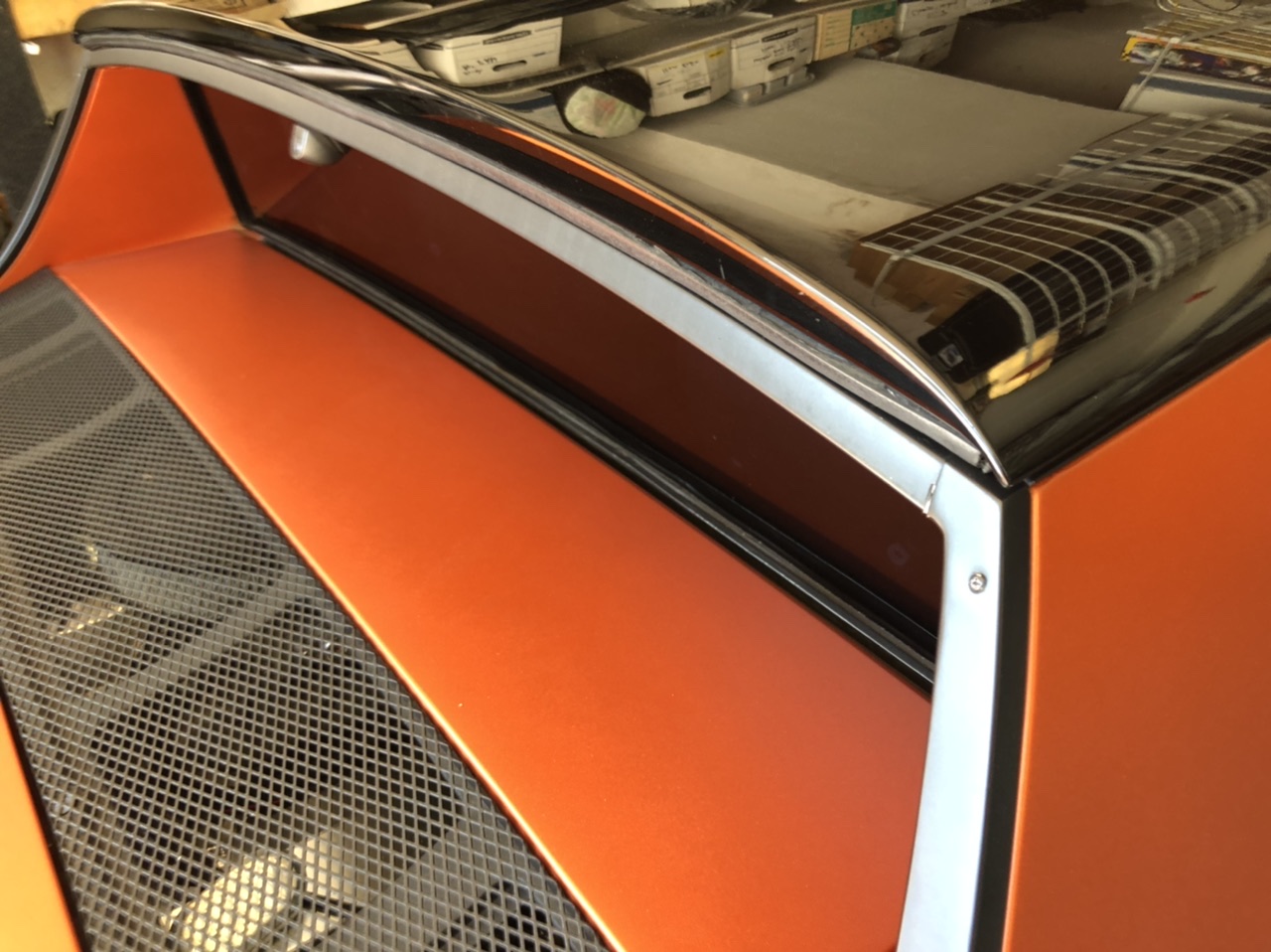

The targa top is way cool and matches the paint on the pillar. Only downside is that it’s cut short in the rear, so it won’t stay in the trunk properly.
