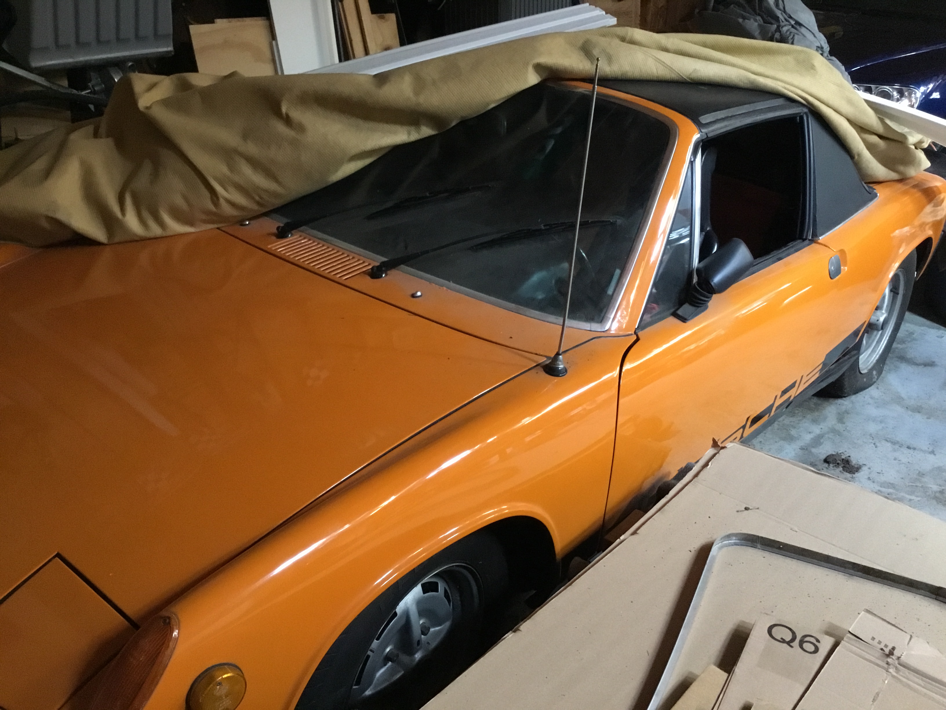

Peter, I asked for advice and I thank you for your opinion. By no means do I consider it to being a downer. It’s being realistic. Good work doesn’t come cheap. I fully understand that. It’s been awhile since I’ve really looked over the car. Probably best to get a closer look before any decisions are made.Attached Image Attached Image Attached Image

Looks a lot like where mine started. Nice on the topside but was rotten floorpan all the way round about 1" up. Passenger long was gone. Driver side was solid.
Looks to be worth saving. I think I maybe see a bit of rust though on the driver side door sill? Pictures of longs and hell hole would tell the tale.

I'm in the area. PM me if you'd like me to take a look and show you what areas to assess more closely. Almost everything is fixable now that there are replacement panels available.
