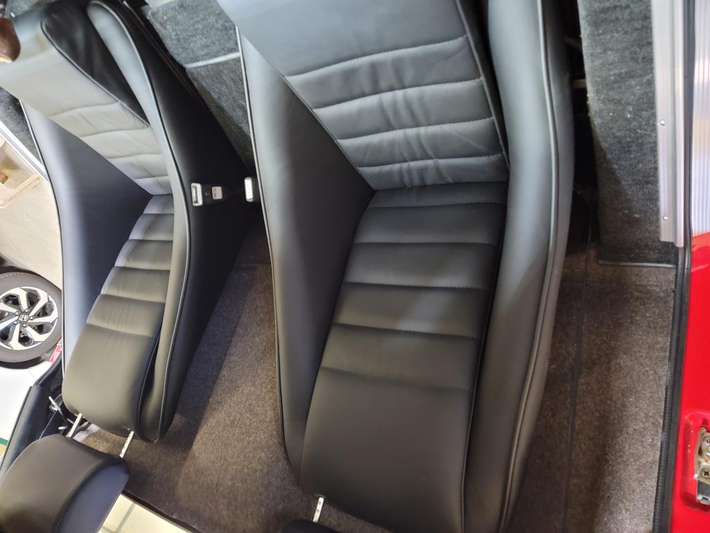

I did this on my car. Very carefully cut Dynamat directly on the firewall. You'll never get one big piece on at once... I think I did three. Then glued 80% wool felt to that in two pieces sliced vertically down the middle. McMaster Carr had the felt. I used the same felt glued to the bottom of the roof.
roblav1
post Feb 20 2022, 06:35 PM
Posts: 528
Joined: 18-September 12
From: KY
Member No.: 14,943
Here... somehow, it went upside down! Hopefully, you'll get the picture, pun intended!

Check out my build thread. I put a layer of Dynamite high-density on the inside of the firewall, followed by low density, and then a custom-sewn perlon carpet. On the engine side, I installed a layer of reflective heat/noise material.
I am very happy with how it looks, and how it opens up the space around the seats.
