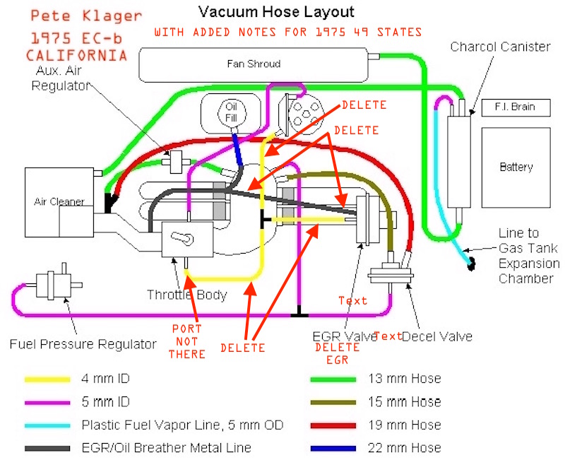

@nditiz1
correct vacuum hose diagram posted below.
courtesy of pete klager who drew it years ago - was posted on pelican parts forum.
for the 75 calif spec car.
that engine you have is the 49 states car.
did not have exhaust gas recirculation.
i made some notes to assist with what is different.
this will help with hoses.
