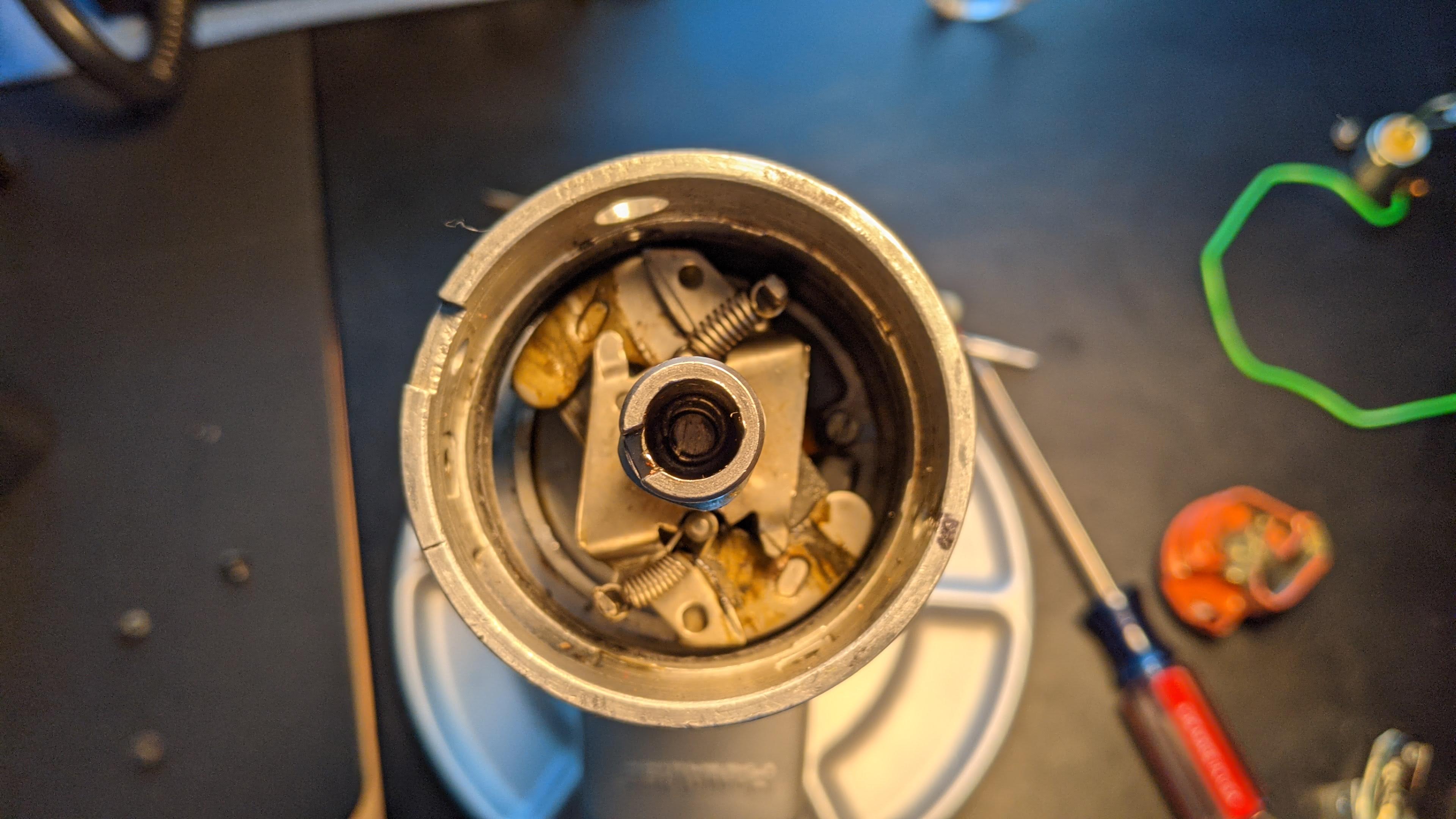

FYI, here's a pic of the C-clip I'm talking about, and how I found it when I removed the felt oiling pad. You can see the clip lying on top of the shaft.
You can also see the jammed mechanical advance mechanism. One thing that's interesting to note is that the two springs are different, one heavy and one light. This allows the advance to progress faster at lower RPM's (lighter spring) and more slowly as it approaches full advance (heavy spring).

QUOTE(pbanders @ Apr 30 2022, 08:08 AM) *
Can you share some tips on cleaning and lubricating the mechanical advance mechanism?
