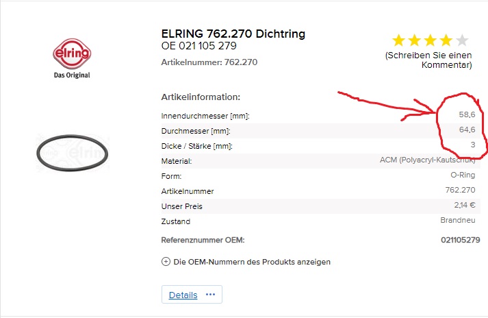

Which o- ring is correct?
914fahrer
post May 26 2022, 11:46 AM
Posts: 103
Joined: 12-November 14
From: Berlin/Germany
Member No.: 18,115
Region Association: Germany
I hope this the correct one .The vw nummer is 021 105 279

Thanks everyone for the clarification. The thicker o-ring on the left is the correct one.
