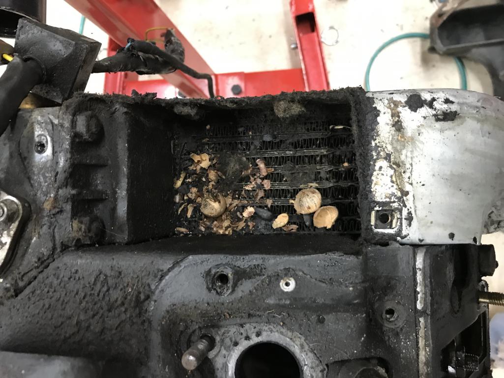

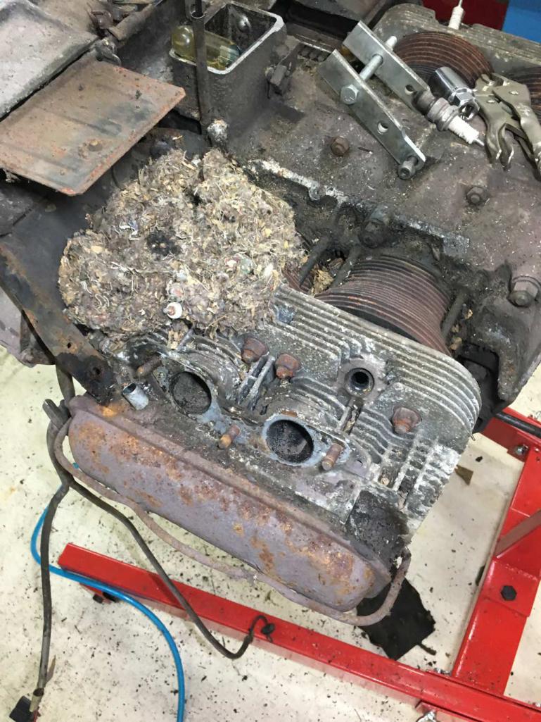

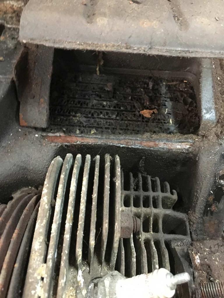

My gut (and my eyes with limited pictures) are telling me the cooling tin has never been off of that engine.
If it is otherwise running good I dont think i would mess with anything else until I pulled the motor and cleaned it out.

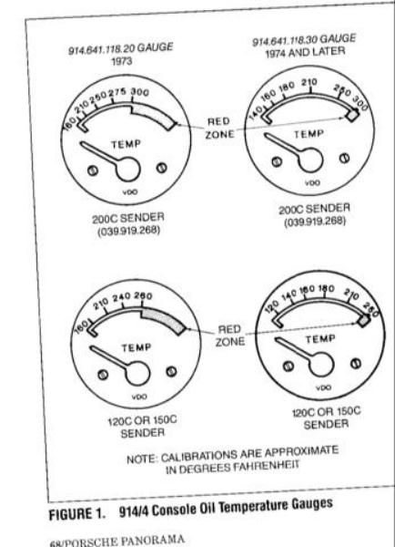

Here's the weekly posting of oil temperature gauge vs. calibration vs. which temperature sender.
For reference:
Take note that if someone has replaced the temp sensor with the 120 C / 150 C sender on the 74' (late) gauge that the OP has, the oil temperature can be around 210-220F (great oil temperature) and the gauge will look like its running very hot but there is no concern what so ever.
More concerning if the 200 C (OEM original) sender is in place but still not crazy (300F +).

Make sure you don't have the oil cooler plugged with debris or one of these situations (all 3 came from my own tear down core engines -- 3 of 3 had what would be fatal blockages if you tried to run like this):
Blocked oil coolers are amazingly common on these older cars and there isn't an easy way to clean them as annual maintenance. The rodent problems are very real for vehicles stored a good part of the year. Likewise, mice can build one of these nests very quickly - just a matter of a few days.

QUOTE(JamesM @ Jun 6 2022, 02:11 AM) *
QUOTE(SVG223 @ Jun 5 2022, 10:28 PM) *
QUOTE(JamesM @ Jun 5 2022, 11:39 PM) *
This could be SO many things its hard to find a place to start, especially on a 76. Need a lot more information here.
It could be cooling air flow related, but it could also be related to the tune of the engine or overall engine condition.
I think its worth noting though that the gauge you are looking at is showing your oil temps which are not always the best indicator of if your engine is killing itself or not (im always more concerned with head temps) especially given the vagueness of that particular gauge setup. It may not even be an actual problem unless this is a noticeable change from where it was previously running.
FYI your engine is the only one I have ever seen in 25+ years of 914s that has an intact grommet on the thermostat cable, so I have to ask, has this engine ever been out of the car? If not (and given the fact that im looking at a small leaf in your fan, I would venture to guess that you could have a lot of crud in your engine fins/oil cooler.
The engine seems stock to me, not sure if it has been rebuilt. Odometer has 58k I'm guessing 158k. I took off the smog pump.
The change I noticed when it got hot was a drop in idle speed and it didn't seem to run as well.
Crud in the engine fins/oil cooler sounds possible.
