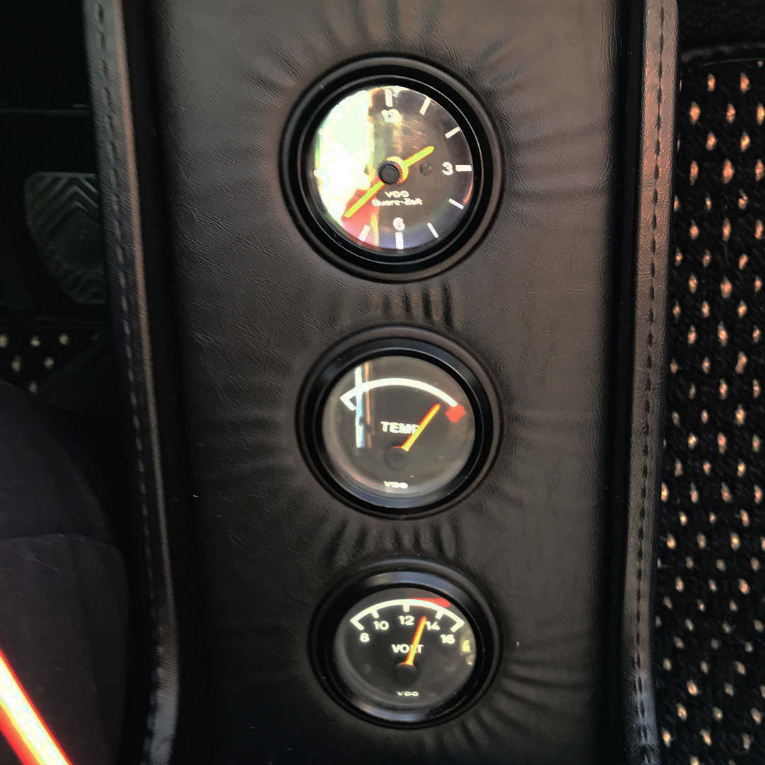

My 914 overheats on the highway. I had concerns about the air flap, but I think the thermostat has broken and it stays in the open position. I thought something might be clogging the fan but it looks clear. I wonder about the heater air hose that goes over the motor. It could be blocking some air possibly. I may try to tie it out of the way. After exiting the highway and stopping at a stopsign the idle was extremely low, I was surprised it was still running. I turned the engine off for a while and it ran better after it cooled down. Any ideas would be appreciated.

Did it actually go into the red zone? If not then it technically is not overheating.
How long did it take to get to that position?

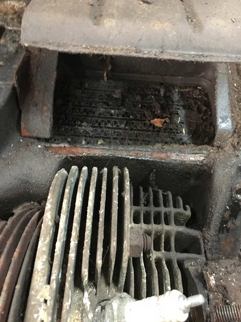

This could be SO many things its hard to find a place to start, especially on a 76. Need a lot more information here.
It could be cooling air flow related, but it could also be related to the tune of the engine or overall engine condition.
I think its worth noting though that the gauge you are looking at is showing your oil temps which are not always the best indicator of if your engine is killing itself or not (im always more concerned with head temps) especially given the vagueness of that particular gauge setup. It may not even be an actual problem unless this is a noticeable change from where it was previously running.
FYI your engine is the only one I have ever seen in 25+ years of 914s that has an intact grommet on the thermostat cable, so I have to ask, has this engine ever been out of the car? If not (and given the fact that im looking at a small leaf in your fan, I would venture to guess that you could have a lot of crud in your engine fins/oil cooler.

I don't think it quite made it to the red zone, it almost touched it. While it was still hot the idle was 200 rpm it's normally 1000 rpm. I'm guessing loss of compression from the heat, don't know.

Crud in the engine fins/oil cooler sounds possible.

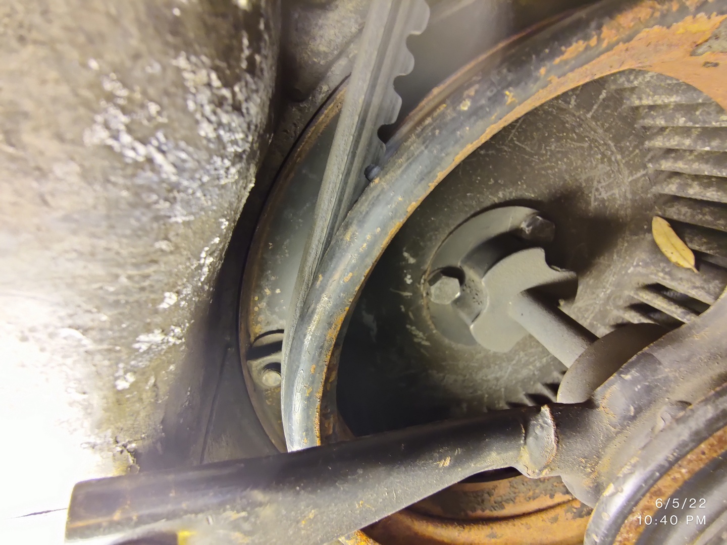

I noticed the belt was missing for the smog pump, if you are not running it you should probably consider removing the pully assembly for it as well as the bearing in them tends to seize up. Also FYI haven't seen one of those that wasn't totally trashed as
well.

While we are on the subject of missing bits, minor issue but the tab that holds down the cooling flap rod is also missing.

My gut (and my eyes with limited pictures) are telling me the cooling tin has never been off of that engine.
If it is otherwise running good I dont think i would mess with anything else until I pulled the motor and cleaned it out.

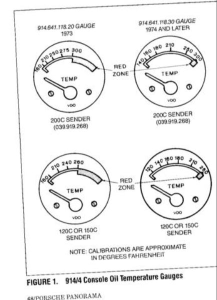

As James said that is the oil temp. Porsche actually changed the gauge markings at one point because it alarmed owners. I've got a '76 and it has always read just as yours shows. Well for the past 13 years anyway. Get a head temp gage if your concerned about engine temps. beerchug.gif

Here's the weekly posting of oil temperature gauge vs. calibration vs. which temperature sender.
For reference:
Take note that if someone has replaced the temp sensor with the 120 C / 150 C sender on the 74' (late) gauge that the OP has, the oil temperature can be around 210-220F (great oil temperature) and the gauge will look like its running very hot but there is no concern what so ever.
More concerning if the 200 C (OEM original) sender is in place but still not crazy (300F +).

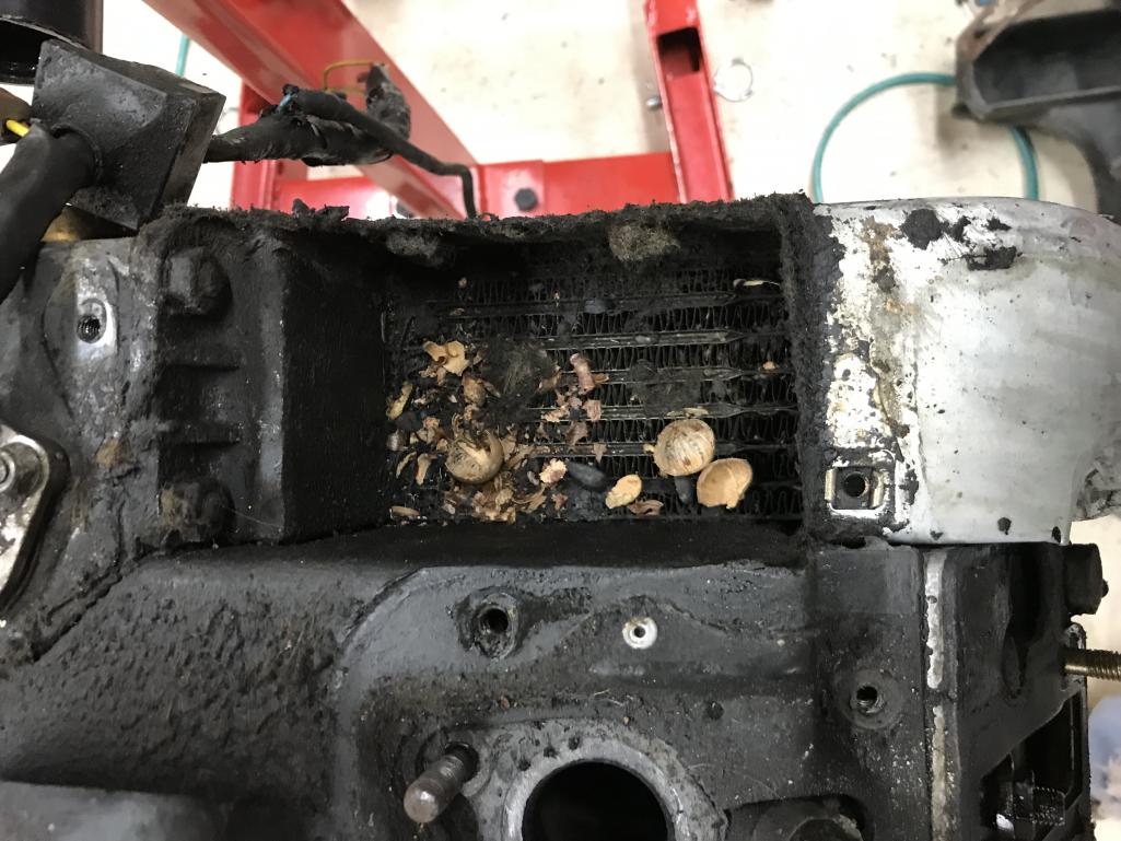

Make sure you don't have the oil cooler plugged with debris or one of these situations (all 3 came from my own tear down core engines -- 3 of 3 had what would be fatal blockages if you tried to run like this):
Blocked oil coolers are amazingly common on these older cars and there isn't an easy way to clean them as annual maintenance. The rodent problems are very real for vehicles stored a good part of the year. Likewise, mice can build one of these nests very quickly - just a matter of a few days.
well.
Yes sounds like a good idea. I didn't realize that until I took the picture.

sounds like a good tip @JamesM re whats under the tin and on the fins since you guys on the top of the world seem to suffer from mice nest problems? sad.gif
Indeed, we are lacking in enormous mouse eating spiders to help keep the population in check.
Thanks! Good info!

Don't know if anyone else has mentioned this, but make sure the fan belt is tight. If it's slipping, you won't get the air flow over the heads that you need to cool them down.
emerygt350
That's a Porsche/diff type thing. Our fans are direct mount. Belt only runs the alternator.

Delete/Replace the cat converter and clean the oil cooler. The cooler will be a bit of a chore. Purchase new cooler seals (I would get 2 sets. They keep.) before you start the process.

Yes the cylinder fins and the oil cooler. I had to have help with the cooling flaps to get them in the right position to flush the oil cooler with diesel. I suppose the engine would have to come out to do a thorough clean. I'm still hoping that the new ignition timing will allow me to drive it this summer.
VaccaRabite
Just clearing out all the crap on top of the oil cooler may be enough to bring temps into check.
