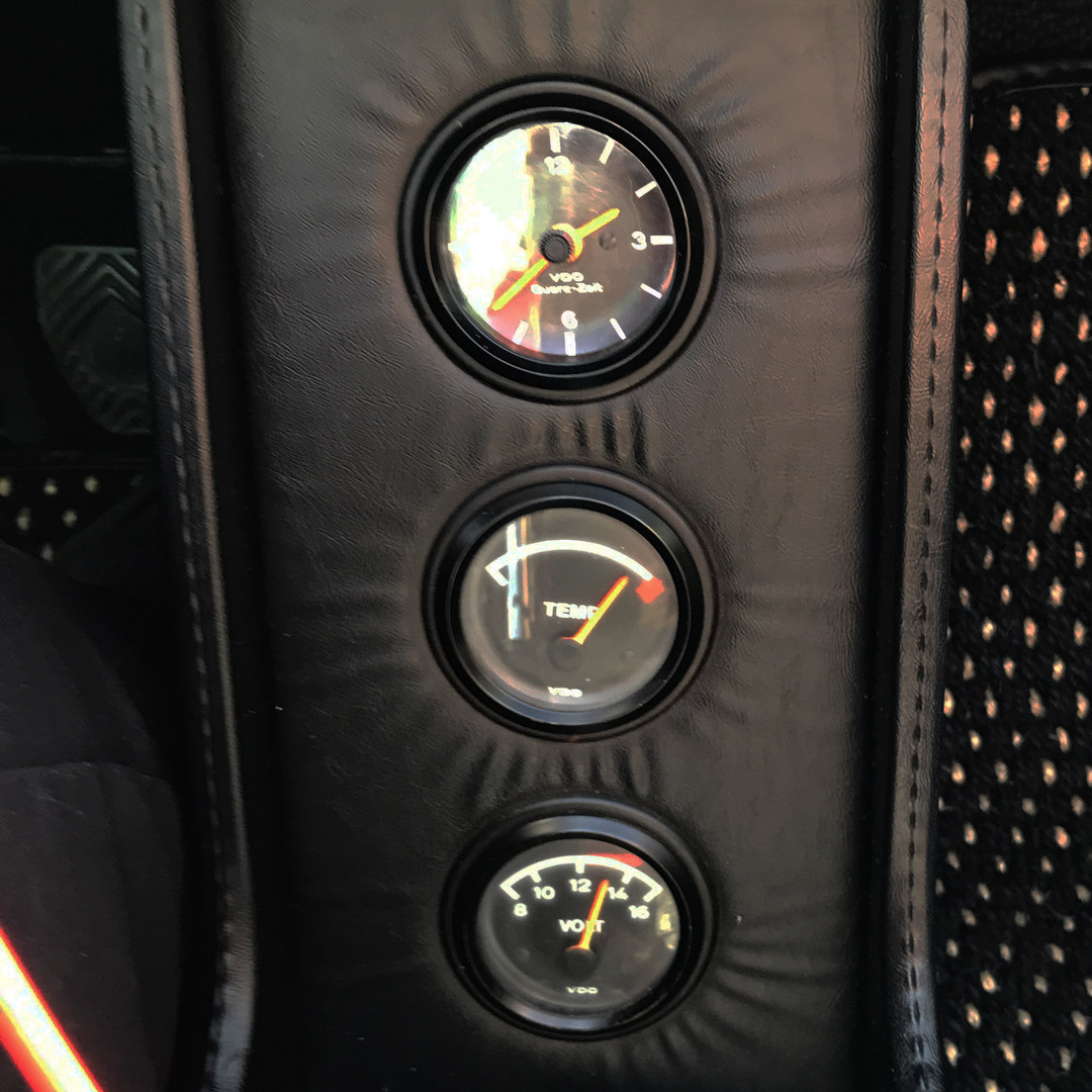

My 914 overheats on the highway. I had concerns about the air flap, but I think the thermostat has broken and it stays in the open position. I thought something might be clogging the fan but it looks clear. I wonder about the heater air hose that goes over the motor. It could be blocking some air possibly. I may try to tie it out of the way. After exiting the highway and stopping at a stopsign the idle was extremely low, I was surprised it was still running. I turned the engine off for a while and it ran better after it cooled down. Any ideas would be appreciated.

I think its worth noting though that the gauge you are looking at is showing your oil temps which are not always the best indicator of if your engine is killing itself or not (im always more concerned with head temps) especially given the vagueness of that particular gauge setup. It may not even be an actual problem unless this is a noticeable change from where it was previously running.

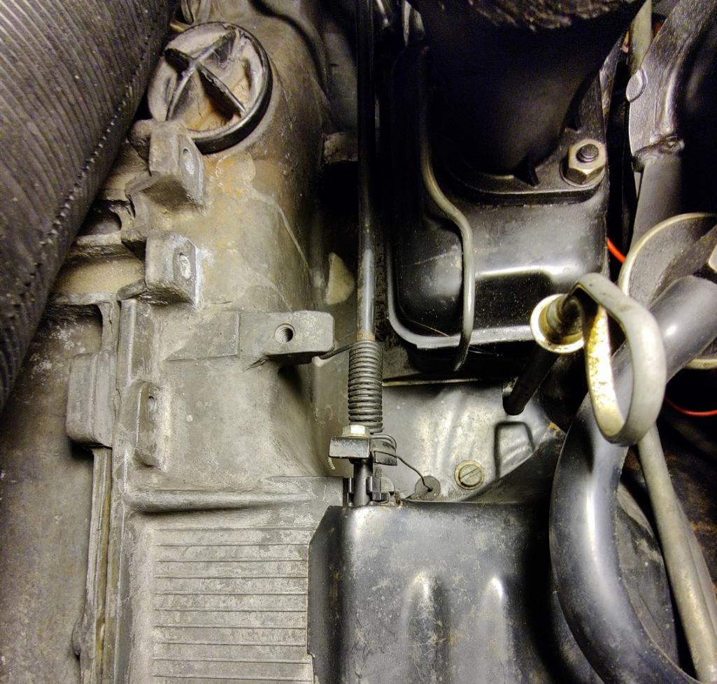

FYI your engine is the only one I have ever seen in 25+ years of 914s that has an intact grommet on the thermostat cable, so I have to ask, has this engine ever been out of the car? If not (and given the fact that im looking at a small leaf in your fan, I would venture to guess that you could have a lot of crud in your engine fins/oil cooler.
Good eye on the grommet. (IMG:style_emoticons/default/shades.gif)

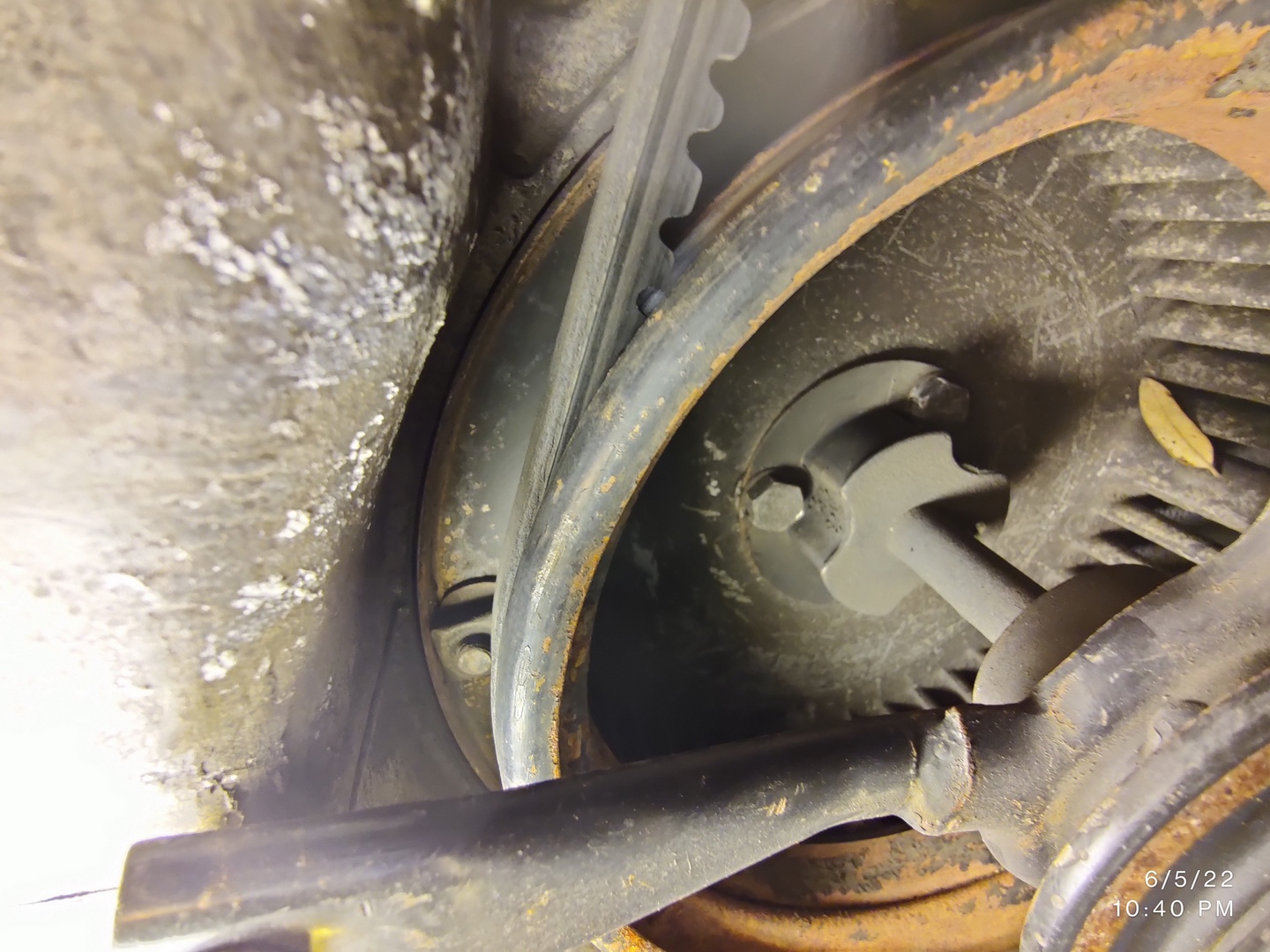

I noticed the belt was missing for the smog pump, if you are not running it you should probably consider removing the pully assembly for it as well as the bearing in them tends to seize up. Also FYI haven't seen one of those that wasn't totally trashed as
well.
Right now I honestly wouldn't be surprised if it actually was a 58k mile car. I would love to see pictures of the rest of it.
While we are on the subject of missing bits, minor issue but the tab that holds down the cooling flap rod is also missing.

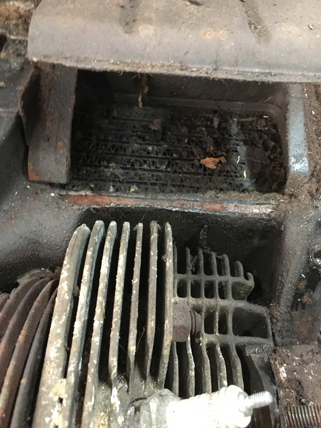

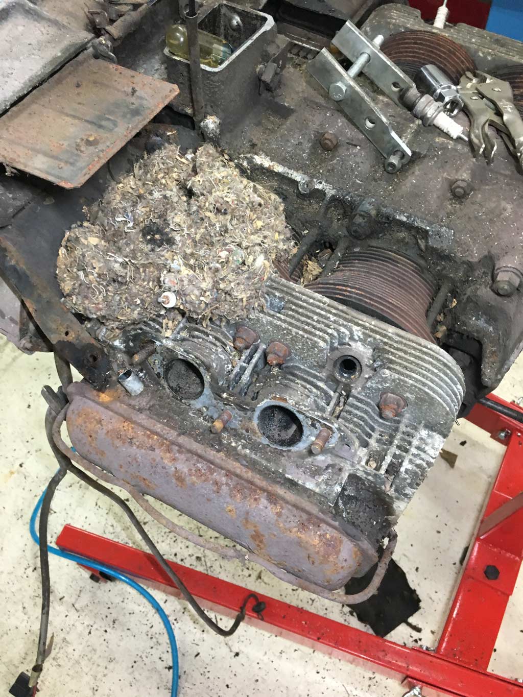

My gut (and my eyes with limited pictures) are telling me the cooling tin has never been off of that engine.
If it is otherwise running good I dont think i would mess with anything else until I pulled the motor and cleaned it out.

As James said that is the oil temp. Porsche actually changed the gauge markings at one point because it alarmed owners. I've got a '76 and it has always read just as yours shows. Well for the past 13 years anyway. Get a head temp gage if your concerned about engine temps. (IMG:style_emoticons/default/beerchug.gif)

Here's the weekly posting of oil temperature gauge vs. calibration vs. which temperature sender.
For reference:
Take note that if someone has replaced the temp sensor with the 120 C / 150 C sender on the 74' (late) gauge that the OP has, the oil temperature can be around 210-220F (great oil temperature) and the gauge will look like its running very hot but there is no concern what so ever.
More concerning if the 200 C (OEM original) sender is in place but still not crazy (300F +).

The engine seems stock to me, not sure if it has been rebuilt. Odometer has 58k I'm guessing 158k. I took off the smog pump.
The change I noticed when it got hot was a drop in idle speed and it didn't seem to run as well.
Crud in the engine fins/oil cooler sounds possible.
well.
Yes sounds like a good idea. I didn't realize that until I took the picture.
Thanks I didn't know anything was missing I will have to look that part up.
