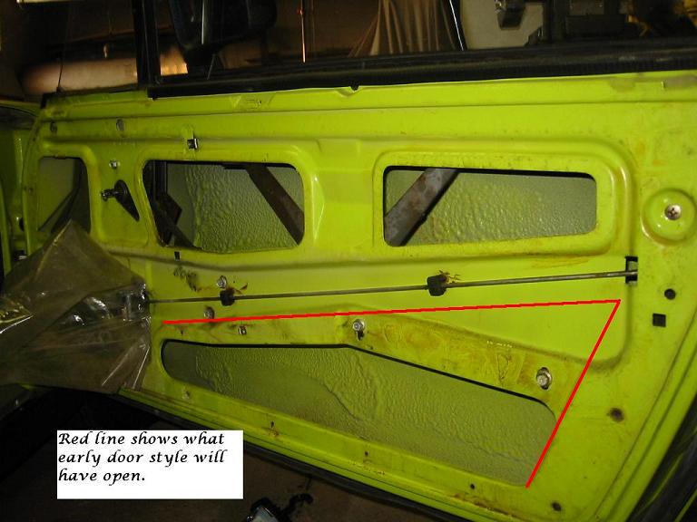

Are u sure u have the early door. The picture below is from the later 73 stronger doors. You can tell by looking at the bottom half. The early door does not have the bend on the bottom half (see red line). Beyond that it is not all that notcable that the doors are reinforced on the inside.

Your picture is a early 73 door with late regulators and no impact beam.

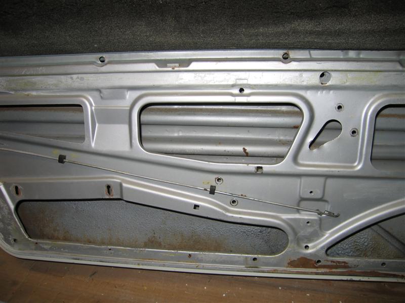

The photo below is of a late door. The impact beam is substantial, looks to 14 or 16 gauge steel. You can tell the difference between a early and late door in the way they close. The late door is obviously heavier.

That is correct, there are three door styles in 1973. The late style unreinforced was in use only for a very short time.
