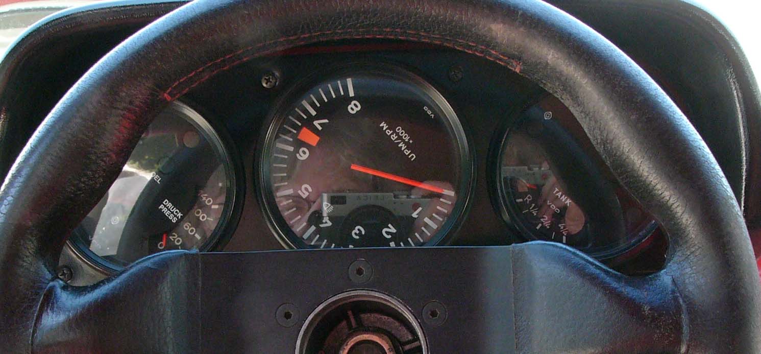

Dad,
Nice reflection of mom and her digital Leica in the Tach. How come all those gauges are turned like that? Can't you get them in there straight?
I just had to chime in to prove how dysfunctional my family is. All three of us writing in this thread instead of TALKING to each other.

Johnman,
I can never catch you on the phone,
and don't ask me why the guages are all cocked like that, you put them in that way.
Really I sent the picture so someone would ask about the camera.
A whole family full of 914 nuts, the disease is genetic, or at least contagious!
