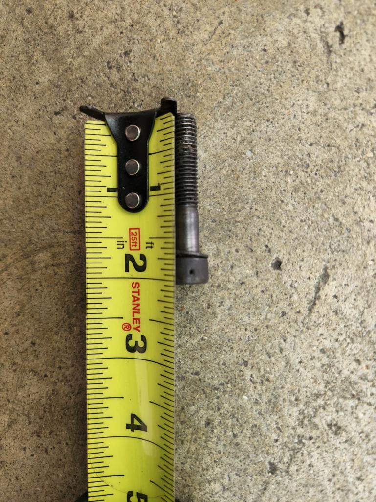

Got the passenger side CV joint off. Surprisingly it did have the schnorr washers. The bolts were snug tight with no brackets. They are 2" long, are these the correct length? Image below for reference.

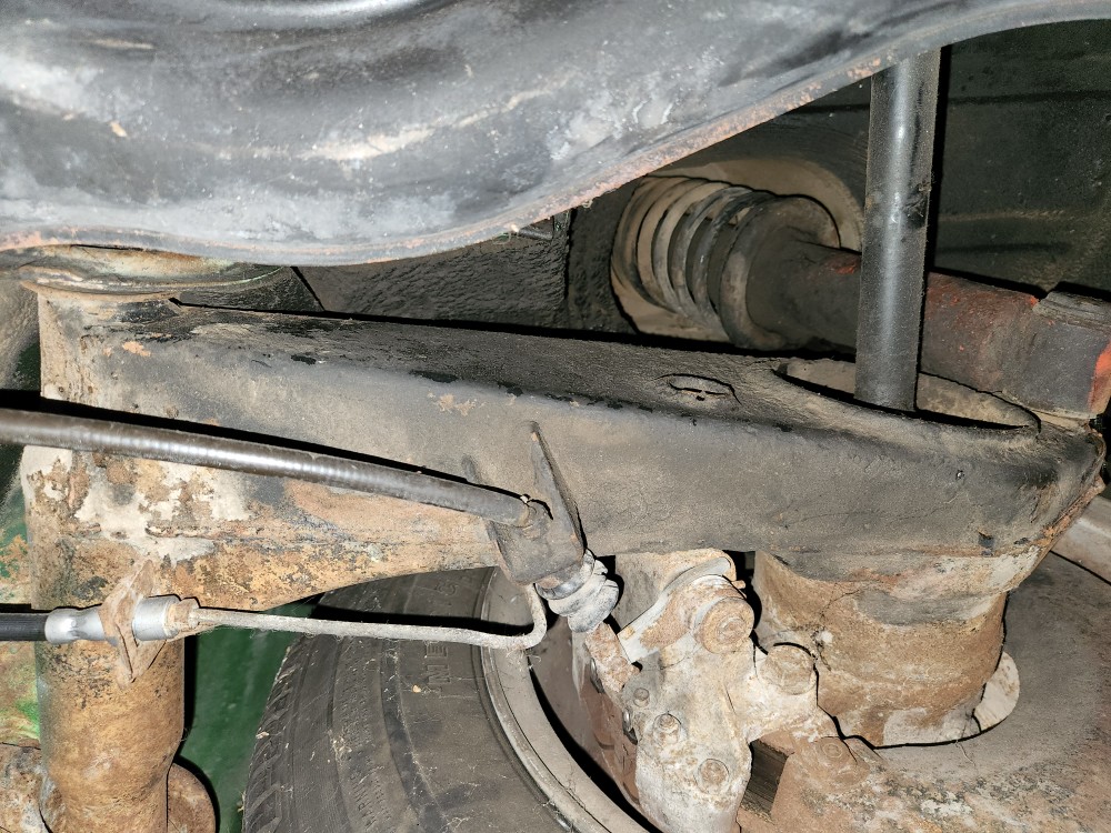

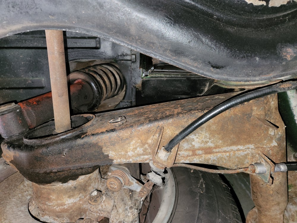

I'm also posting images of my trailing arms. I'm concerned they are too rusty to refurbish. Anything in specific I should look at to see they are still ok?
From what I've read it's a media blast, weld any issues, powder coat, add rubber bushing, add zerk fitting, reinstall. Did I miss anything?

QUOTE(narino @ Jul 2 2022, 02:38 PM) *
Thank you!
The threaded part should be 45mm long, which is about 1-3/4" long.
It is hard to tell from the pictures, but it looks like mostly surface rust on the trailing arms. I would take a wire wheel to them, if they clean up fairly smooth, they should be fine.

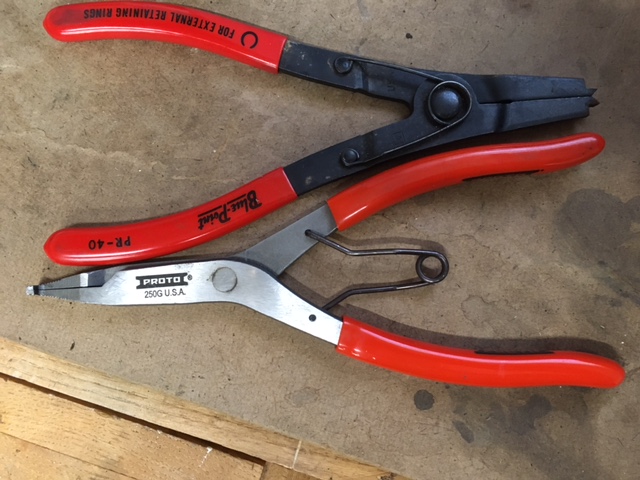

Crap. So one CV had hex bit bolts. So i STUPIDLY assumed they all had been replaced from M8 triple square to hex bit. Nope. Bad eye sight and crud convinced my eyes the outer CV to be hex. Naturally I stripped that bolt. My extractor tools didn't help, I'll need to take the axle nut off. $#$@!
Anyone have a trick to get the C-clip off on the axle end? I got one off, no issue, but the second one spins when I tap it with a flat head screw driver. Thoughts?

QUOTE(narino @ Jul 4 2022, 04:02 PM) *
Thanks all. Hope everyone is having a great 4th!
I had to look back at my old build thread. My daughter rebuilt the axle that needed cv boots a few years back. Maybe I can talk her rebuilding the other side side the transaxle is out.
I would get new C clips while you are at it at least one will end up feeling loose.
It looks she used Proto 250g retaining ring pliers.
I had the same thing happen to me, one side was hex when I removed the transaxle about 2 weeks ago. Maybe CV joint kits at one time, supplied replacement hex socket bolts. Even worse two of the four CV joint bolts were finger tight. If they had been on the other side they would have spun out. I bought replacement bolts from 914 Rubber. predrilled for safety wire.

@914e finger tight CV bolts is a scary thought. Glad you guys caught that. Thank you for the pliers recommendation! Did she need the other pliers for something else on the car?

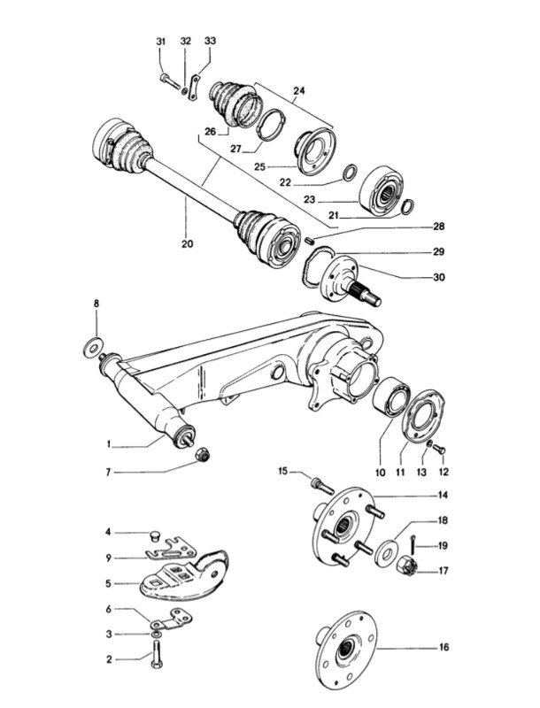

I got the axles off! 1/2" breaker bar with 6ft black iron pipe for leverage, and a few rounds of PB blaster. (IMG:style_emoticons/default/piratenanner.gif)
In looking at the CV joints only one had the concave washer that is supposed sit behind it. Anyone have some locally I could buy and pick up this weekend?

The washer I'm looking for sits behind the CV on the axle. #22 in the exploded diagram below.

The concave washer?

Yep, i need 4. Only one CV had the concave washer, might as well replace all 4.
