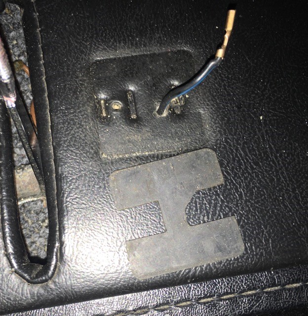

Odd ball question, in the center console (as well as non equipped cars) there is a small square illuminated indicator for the heater lever, this is on anytime your lights are on.
When installed on the center console it originally had a odd H shaped seal beneath it.
Does some one have one or an image they can share?

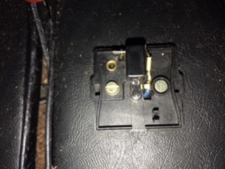

Here’s mine. Just the plastic plate and bulb. Is the seal below the plate, or above (then mine is missing or not on a 74).

Supposed to be below, I only found one in soooo many years.

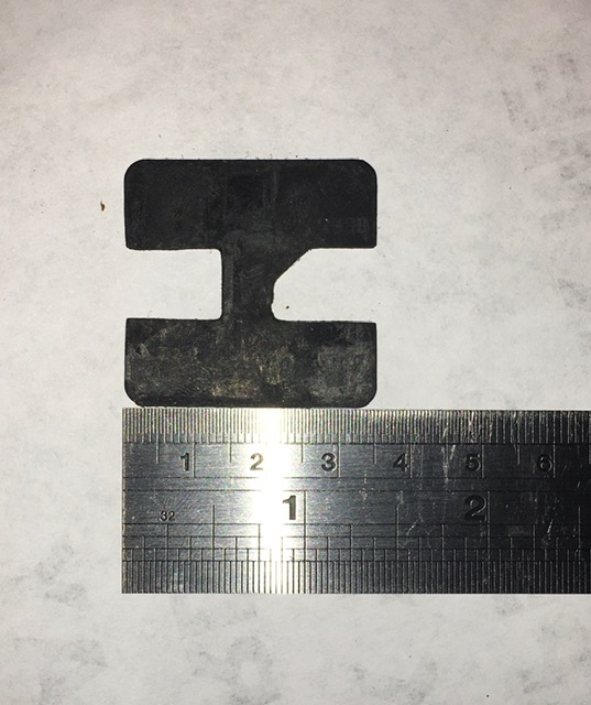

Here ya go, Rich:
Correct orientation:

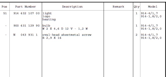

I like the idea of going LED for brightness, what is the stock incandescent bulb for the OE indicator?

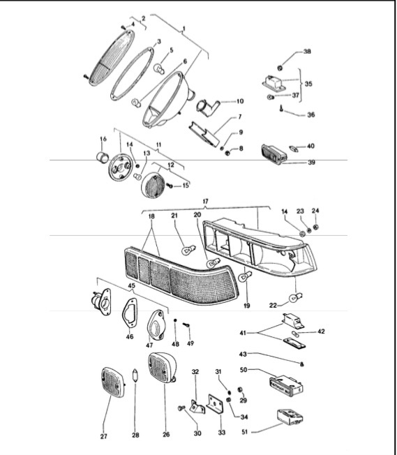

post Jul 22 2022, 07:39 AM
Posts: 11,292
Joined: 22-March 03
From: USofA
Member No.: 453
Thanks!
Ive looked at that page IDK how many times & never noticed the indicator was on it.

wonkipop
post Jul 22 2022, 07:47 AM
Posts: 4,800
Joined: 6-May 20
From: north antarctica
Member No.: 24,231
QUOTE(914werke @ Jul 22 2022, 07:39 AM) *
Thanks!
Notice there is no part for that little seal?
you are not the only one.
only reason i know is i had to track the bulb down 2.5 years ago.
searched through that parts catalogue 20 times before i finally saw it.
so i knew where to go for you.
yep no gasket.
its a mystery part.
EDIT
its not even on the console parts page.
i just went and had a look there.
