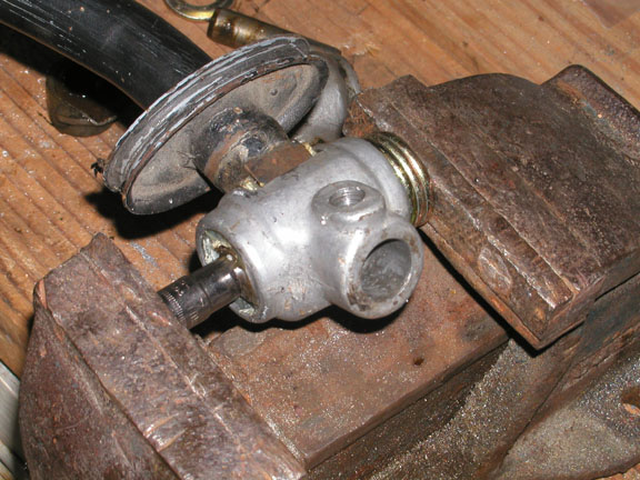

Pulled the boot cover back at firewall and this fell out. What is it and where should it go?
And what are these "cone screws" you guys are referencing? Thanks guys!
Rick986
post Jul 21 2022, 03:43 PM
0-60 in 14 seconds!
Posts: 141
Joined: 31-August 21
From: NE Ohio
Member No.: 25,869
Sorry I'm being lazy! I'm doing my homework and see the piece that fell out is the bushing from the coupler! And I think the one on the other side is gone completely. Checking...

QUOTE(Rick986 @ Jul 21 2022, 02:18 PM) *
See the Allen-head fastener in your second pic? That is the cone screw. Or rather, one of them. The other screws in through the shift rod head that goes on the rear end of the rear shift rod, hiding up above the plastic boot on the side of the transmission.
--DD

i saw this late last nite, just getting some time this morning to log on and give you some info and advice,
You are on the right track, this is what happens that bushing will look just fine and then it just crumbles. Its not all gone so you have some leverage to get some gears but it hast to be pulled and replaced. I have some pictures i posted on my build thread from doing this about 2 year ago. i had the same senario . I did the brass bushings for the shift coupler bushing i think thats the best way to go. you also ordered the new cone screws, but i also would recommend the new brass bushing for the shift console and the new plastic cup that goes on the console coupler and i would do a new firewall bushing, you dont want to do this 2 or 3 times. Get a new console cover as well.
914rubber has most of those parts, but Rich at 914werke , he is a member here too and has some cool parts, has a brass console bushing, and Rick at RIX914parts.com or Chris Foley at Tangerine Racing both have a version of a better firewall bushing. Tangerine version is big and beefy more for racing. you will find lots of infor use the search function here to look this up . if i have time i will post a few links for you.
you will completely remove your shift bar by removing that cone screw at front and back, pull that cover off the console and the one at the fire wall- get new ones, pull the bar out and you will have to press out the metal pin that holds the coupler on the end of the bar. DO NOT HAMMER IT. you will mar it and it wont come out or go back in , you have to press it out and press it back in . it has several splines and its not perfectly cylindrical that is so it will stay in once pressed into place.
