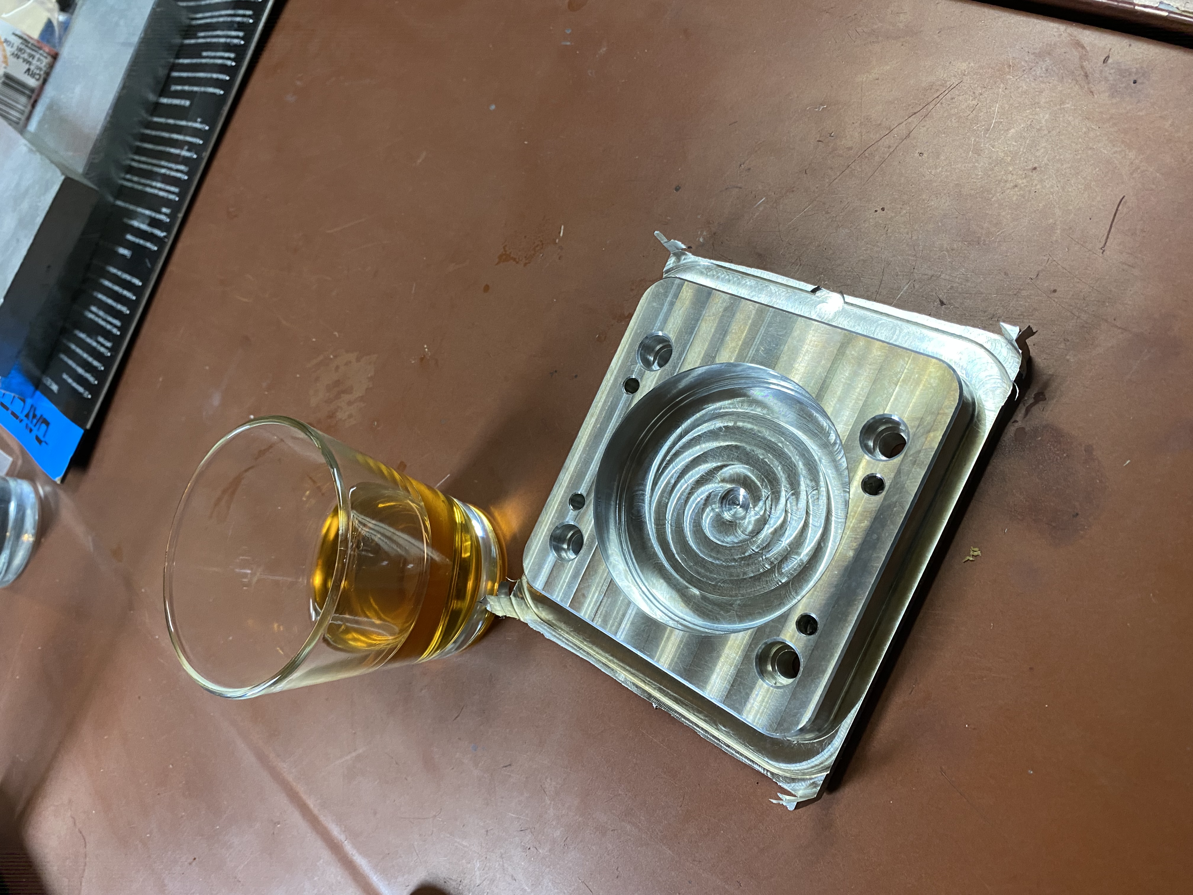

First is the Throttle Body adapter. Replacing the factory e-gas with cable. I currenly have this partially drawn in CorelDraw and design is not absolute (still searching hardware). 96mm x 99mm. TB (red) bolts to piece_1 (blue) which bolts to piece_2 (green) which bolts to IM (yellow).
(IMG:http://www.914world.com/bbs2/uploads_offsite/live.staticflickr.com-431-1658826257.1.jpg)

I may be able to assist with the block off plates. What thickness of aluminum? The plasma table can’t compete with a mill for edge finish, particularly on thicker material but let’s at least explore it. Feel free to PM me, too.

Hi Chris,
Just need to machine off the excess material on this one and tap it.

Used the drill press to file down the TB adapter cap screws from 10mm to 9mm to make @Mueller happy.
(IMG:http://www.914world.com/bbs2/uploads_offsite/live.staticflickr.com-431-1662075425.1.jpg)
