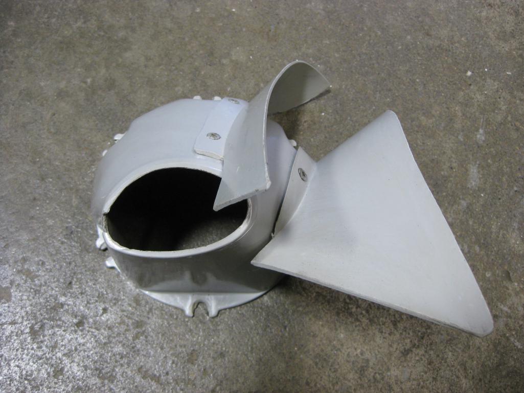

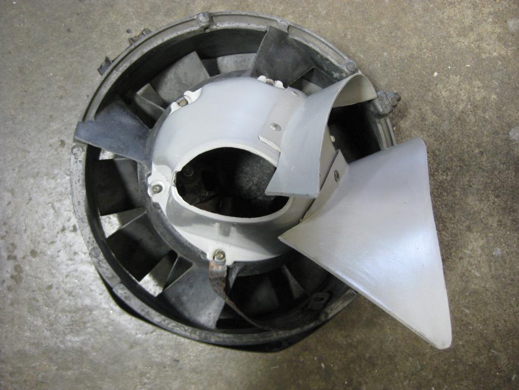

johnhora
post Sep 16 2022, 12:08 PM
Posts: 909
Joined: 7-January 03
From: Derby City KY
Member No.: 107
DennisV
Here is the one with the fiberglass fins
It fits the stock Bosch alternator for the 914-6
The one on my six has the metal fins that are very similar in shape and pop rivet on like the fiberglass one.
I think this one came off a 71 911T CIS engine.
The problem with these is that the plastic cone is not very strong and many have broken mounting tabs where someone has torqued down the nuts way to much and either broken off or cracked the tabs.
Remember that this is internal to the fan housing and is not even seen from the outside.
So find a good one and use it no matter whether metal or fiberglass fins.
