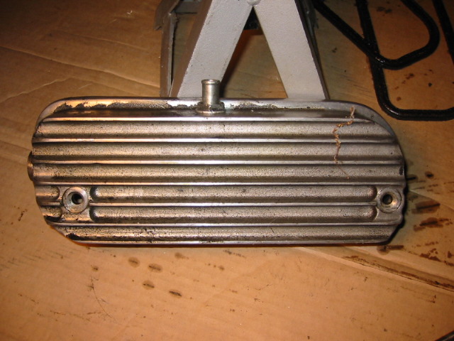

hey all,
Well I decided to take a look at the valves but removing the valve covers is proving to be a pain.
I have a '75 2.0l in my '72 914. The valve covers are bolt on finned aluminum with metal vents on the top that pass through the engine tin and stick theough about 1.25 inches. The vents hook into the oil fill breather.
I could not get the cover off without removing this vent. The problem is that the vent is through mounted on the valve cover and there is no way to put the vents back in? I thought the vents were supposed to face the tranny and come through the engine tin past the valve cover. The covers have holes that face that way but are threaded holes plugged with screws. It does not look like anything the directions show.
Also after getting the covers off my valve adjustment locking nuts need at 14mm not a 13mm what gives?
Any thoughts

Here are the pics

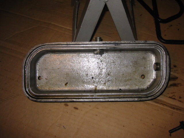

The inside pic. You can see the second port. SHould I get these welded up or something?

I would swaP in a stock set.

I agree with Miles--swap in a stock set.

I gotta agree that it looks like a scary attachment- the rocker assy & bolts were not designed to be loaded that way. Seems like it would mess with valve clearance and cause some weird thermal stresses too.

The ones I have seen, needed machining to get them true enough to seal.
I have seen, like in the roaring '80s, whole magazing articles on how to modify them to work...
(IMG:http://www.914world.com/bbs2/html/emoticons/confused24.gif)
Is it not hard enough? heh
M

Guys all humour aside I really need to get these covers back on the car.
How much for stockers with the bail wire? When I looked quickly they are crazy expensive new. How about used?
What about using the Other port in the covers? How about other ways to close off these holes?
Can I really close off the vents? While I was checking the motor I did notice on the drivers side that the connection at the vent hose would "bubble" a little Because the hose was a little loose. Does that mean that I have a positive pressure in the crankcase and I need a vent?
