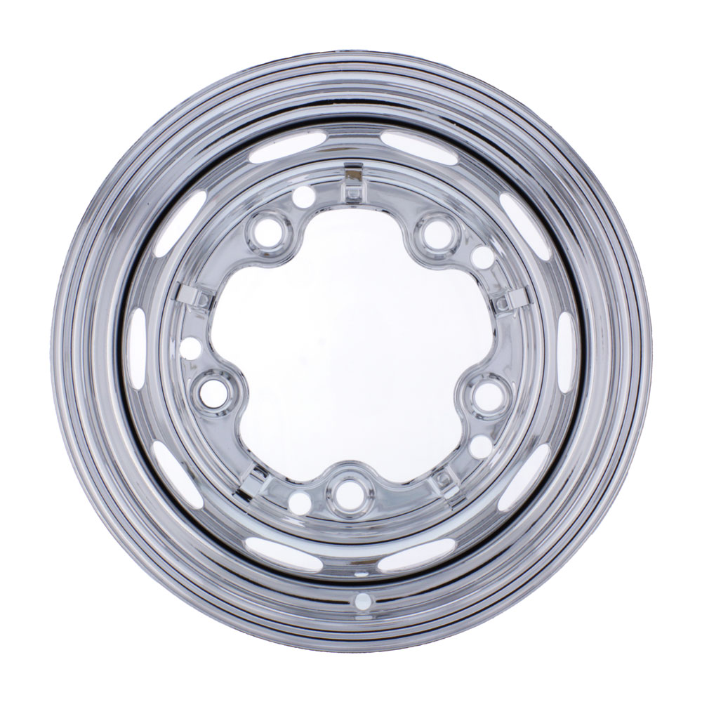

QUOTE(Montreal914 @ Sep 28 2022, 03:28 AM) *
Question: How do you balance these wheels? The wheel balancing machines I am familiar with needs a round hole to center the wheel. Do you need some kind of round ring adaptor temporarily mounted to it?
The RoadForce machines that use the hub to mount have a large cone and several adapters so that they can fit almost every wheel. Same could be used here.
This is essentially the old aircooled VW T2 wheels done in aluminum instead of steel (and 4 lug, for a beetle instead of a bus).
(IMG:http://www.914world.com/bbs2/uploads_offsite/www.jbugs.com-1435-1664371471.1.jpg)

QUOTE(VaccaRabite @ Sep 28 2022, 09:24 AM) *
Zach
The 4 lug wheels the guy is asking can take a center cone adapter to balance the wheels. The picture you have is a wide 5 wheel and that one needs a center hub adapter....
