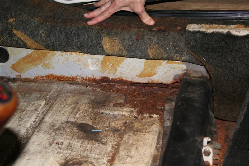

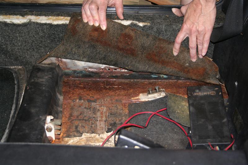

I don’t view them as really, really bad, but the Longitudinals are the worst part of the car. Rocker panels were on the car and I was unable to remove them and examine from that side. Jack point seemed to be pretty solid however. Both seats were out, so I was able to look on the inside. The inside driver side has perimeter rust around floor board. There is some evidence of stress in this area as there is a visible crack (see photo). One of the front bolts that holds the drivers seat down has pulled out and/or rusted out. There are some odd bolts that pass through the floor on the rear of the driver seat area. I ran out of time and didn’t inspect that. I suspect it might have been where a harness was attached to the body. The jack point on the driver side seems a bit weak. The passenger side is worse. It has been repaired. It may have been at the same time as the Hell Hole surgery. It mostly consist of a strip of angle iron about 1 foot or more in length that his holding the floor to the longitudinal toward the rear bulkhead/firewall. Closer to the front of the car (not previously repaired), I was able to push a screw driver into the longitudinal. The rail that runs left right (don’t know name for this) was rusted where it met up with the passenger longitudinal. Under the car on that side showed another angle piece that joins the rear firewall and the floor. Two or three additional small pieced of plate steel (a few inches in length in each direction) was probably covering up holes in the floor or was added to increase strength in this area. Jack point on bottom had been removed and a new one fabricated and welded to longitudinal.

More of the passanger side. Rusted through.

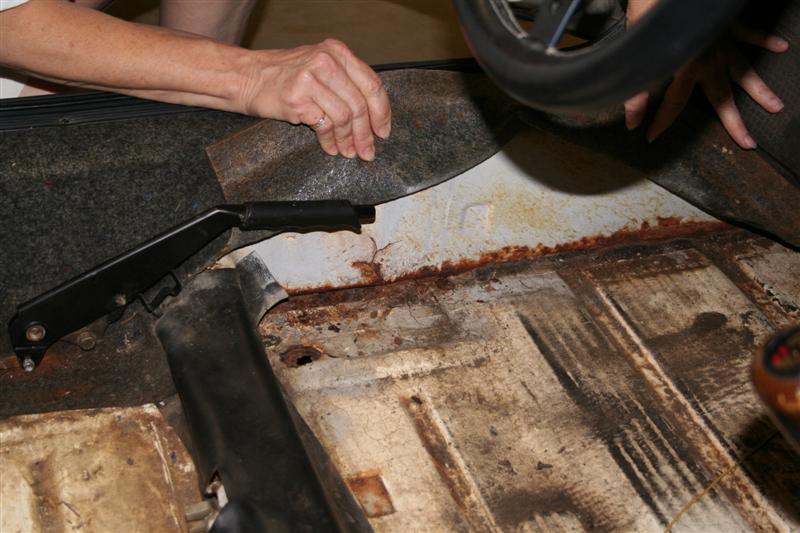

Driver side. Note crack in longitudinal and rusted out bolt hole in floor. Was unable to look behind e-Brake lever.

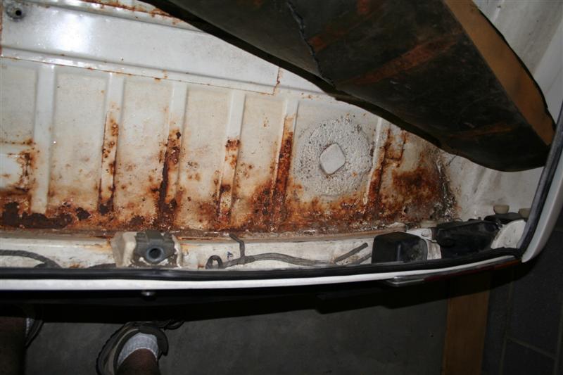

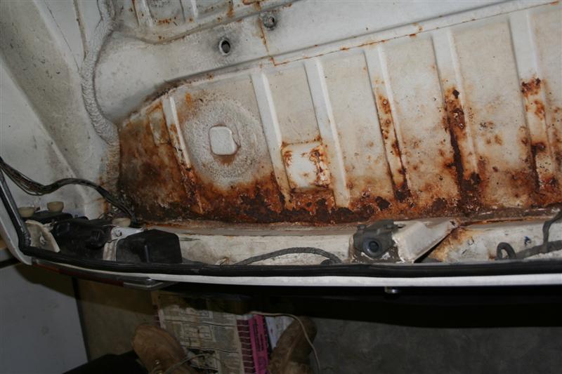

Trunk

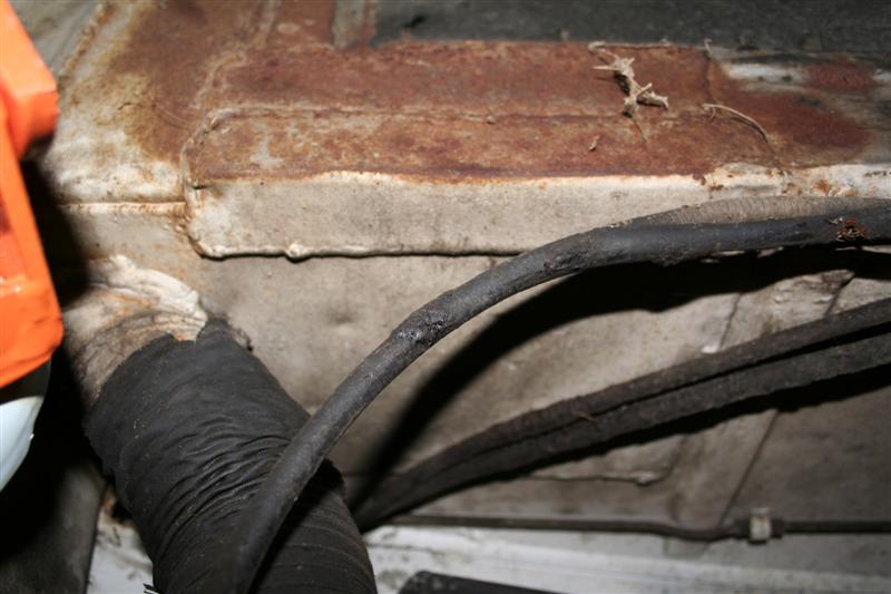

more trunk

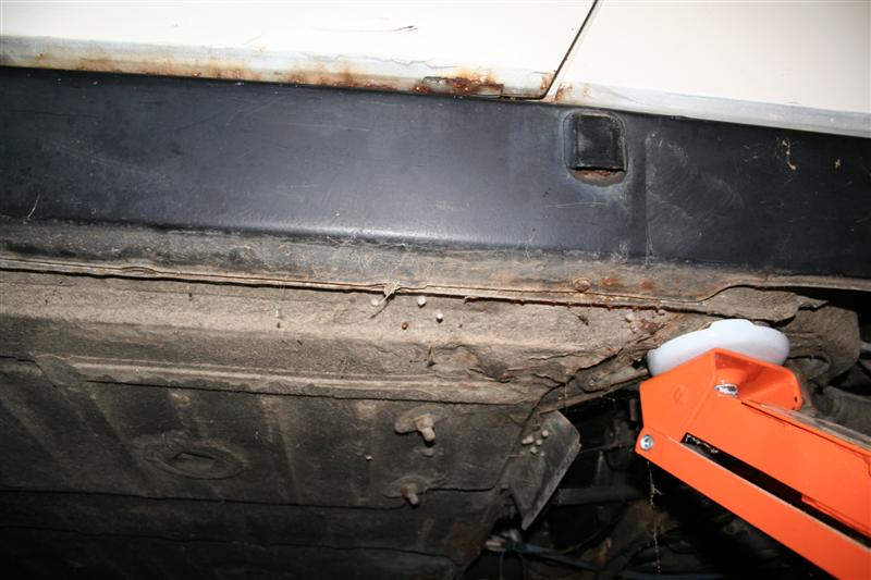

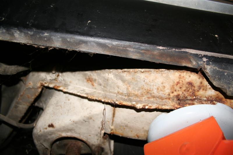

Repair right below Hell Hole. Jack is covering up newly fabricated jack point.

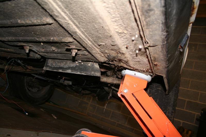

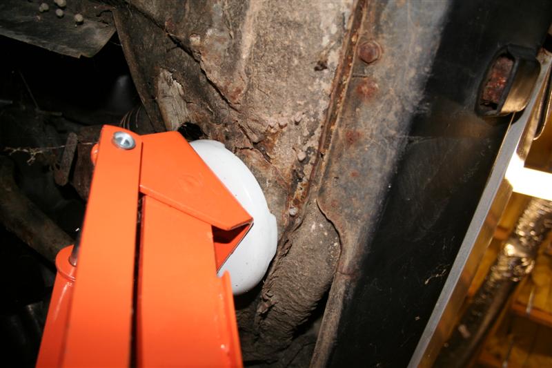

Driver side jack point. Jack is covering up, but it is not as strong as it should be...

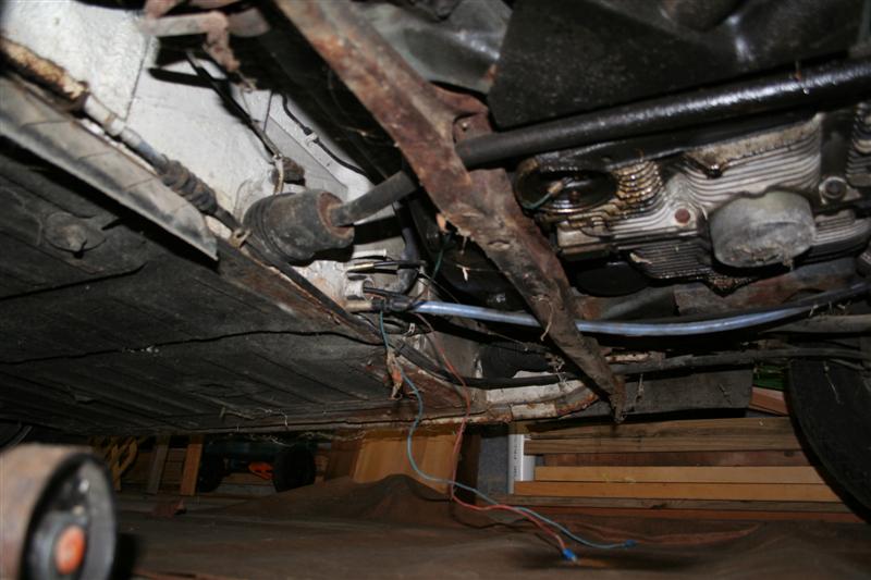

Last photo... Good shot of firewall and repair on passenger side (in background). There may have been a repair of the clutch cable tube as well. I didn't want to crawl under car due to lack of jackstand, so I am not sure about what might have been done here...

There is alot of stuff hiding in that thing. What you see appears, by experience, to be likely.. 30% of the actual damage.

The suspension ear repair scares me. I don't like the method of other repairs, too quick and dirty.. tells some tales. The owner's attitude, not fixing a 'clutch cable problem' and letting that all happen.. hmm.
