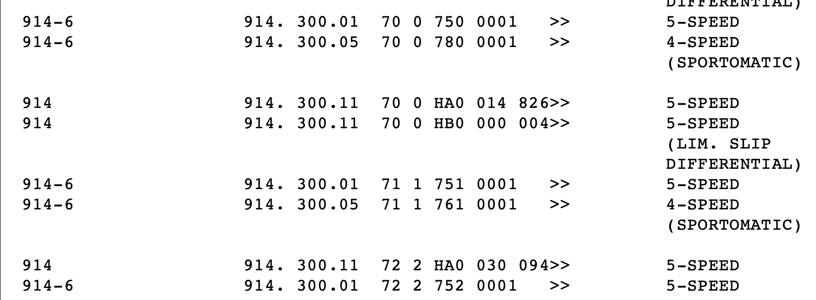

Did any 914-6 come from the factory with limited slip differential?
Based on what I see in the factory parts catalog, there is no reference to 914-6 that includes LSD.
If the answer is "yes" some came with LSD, is there a way you can tell by looking without opening the case?

yes - it was the option M220
you can see it on the tag where the tranny-type and number is stamped in
I can show you an example pic, as soon as I'm home from office

Search for the user Gustl he asked the same question and the answer was the number 914/01 10 for the first line says LSD 10 indicates 80/20 whereas 12 would indicate 60/40 slip settings.

QUOTE(mgphoto @ Nov 3 2022, 08:19 AM) *
Thanks for that suggestion. I think I found the thread you're referring to. Since there are no numbers following the 914/01, that suggests it is NOT LSD. Thank you.
