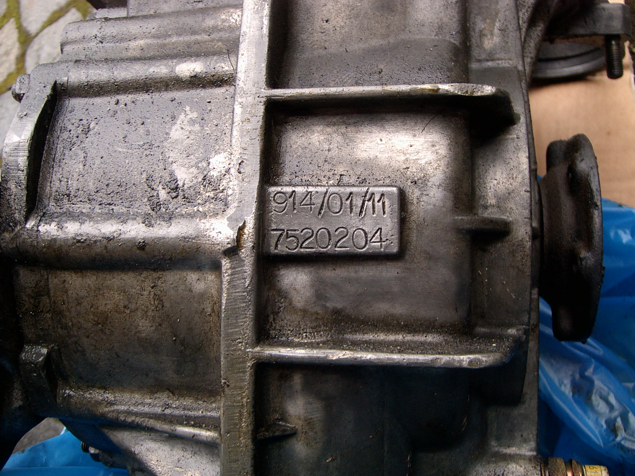

yes - it was the option M220
you can see it on the tag where the tranny-type and number is stamped in
I can show you an example pic, as soon as I'm home from office

Search for the user Gustl he asked the same question and the answer was the number 914/01 10 for the first line says LSD 10 indicates 80/20 whereas 12 would indicate 60/40 slip settings.

here is an example for a 914-6 transmission with LSD

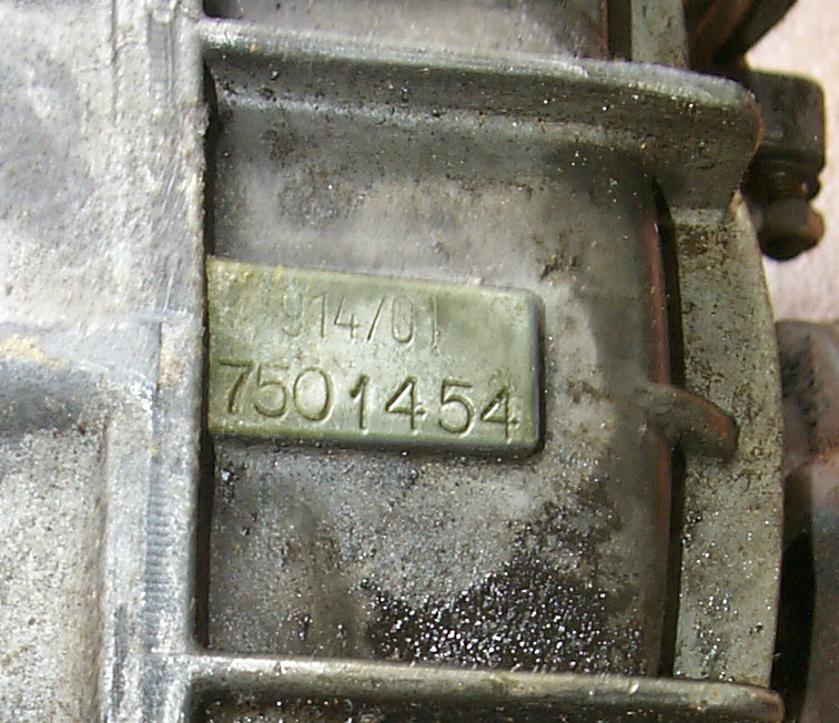

and this one for a standard 914-6 transmission

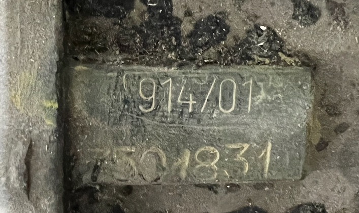

914werke
mgphoto
QUOTE(914werke @ Nov 3 2022, 10:54 AM) *
Anybody remaking this tag?
I would really like to get one.
Cairo94507
@mgphoto I would shoot CarBone in Poland an email with that picture. It would not surprise me if they could get it done. beerchug.gif
DennisV
QUOTE(mgphoto @ Nov 3 2022, 08:19 AM) *
Thanks for that suggestion. I think I found the thread you're referring to. Since there are no numbers following the 914/01, that suggests it is NOT LSD. Thank you.

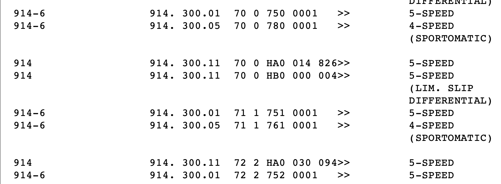

I just purchased a 1974 2.0 liter - it has over 100,000 miles (odometer is broken - I plan to repair.)
Transmission code is "HB 02 05 3" which tells me it has limited slip. To my knowledge the transaxle has not been repaired; when on a lift the rear wheels rotate in opposite directions - implying no LSD evident. Is it possible that the LSD is still present but "worn out"?

It doesn’t sound like it has an lsd.
