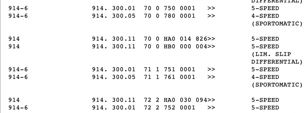

Search for the user Gustl he asked the same question and the answer was the number 914/01 10 for the first line says LSD 10 indicates 80/20 whereas 12 would indicate 60/40 slip settings.

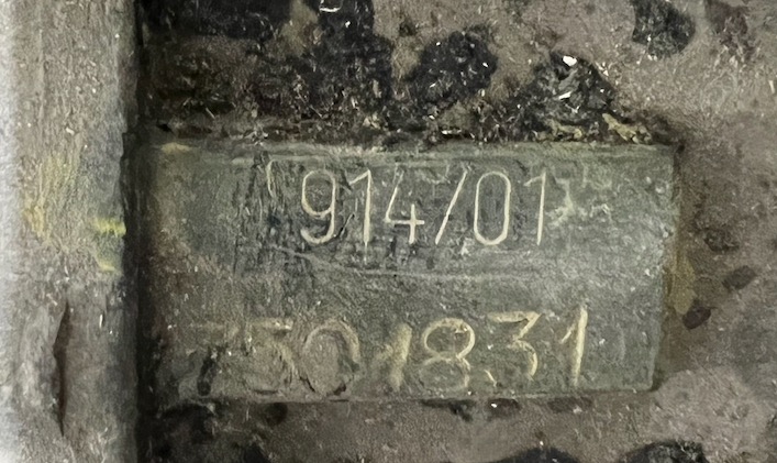

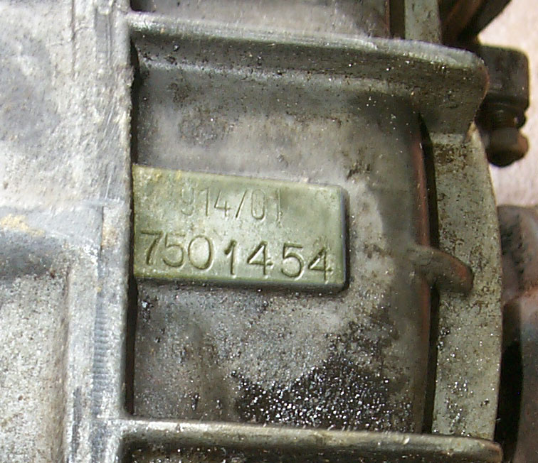

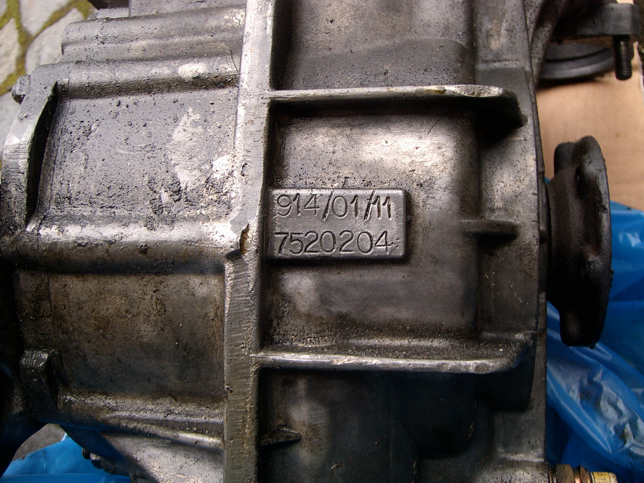

here is an example for a 914-6 transmission with LSD
and this one for a standard 914-6 transmission
914werke
post Nov 3 2022, 11:54 AM
Posts: 11,800
Joined: 22-March 03
From: USofA
Member No.: 453
mgphoto
post Nov 3 2022, 01:50 PM
"If there is a mistake it will find me"
Posts: 1,511
Joined: 1-April 09
From: Los Angeles, CA
Member No.: 10,225
QUOTE(914werke @ Nov 3 2022, 10:54 AM) *
Anybody remaking this tag?
I would really like to get one.
Thanks for that suggestion. I think I found the thread you're referring to. Since there are no numbers following the 914/01, that suggests it is NOT LSD. Thank you.

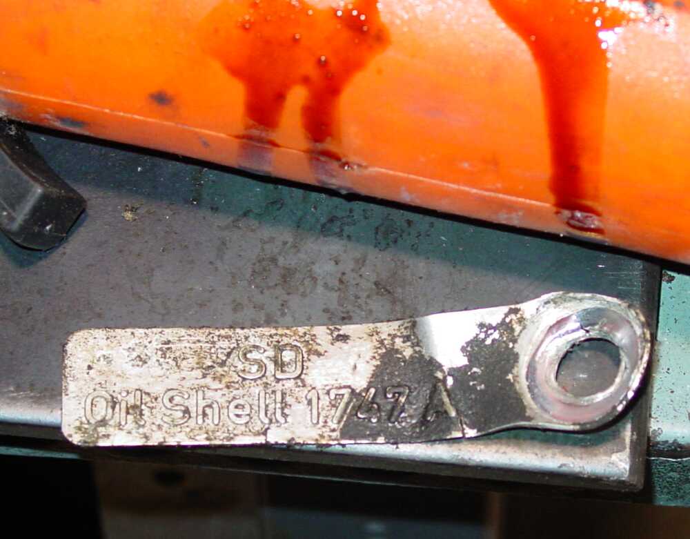

I have a 914 4cyl. trans (stamped HB, with Shell lube tag and
LSD diff carrier) that spins both hubs in the same direction.
So very likely clutches kaput.
