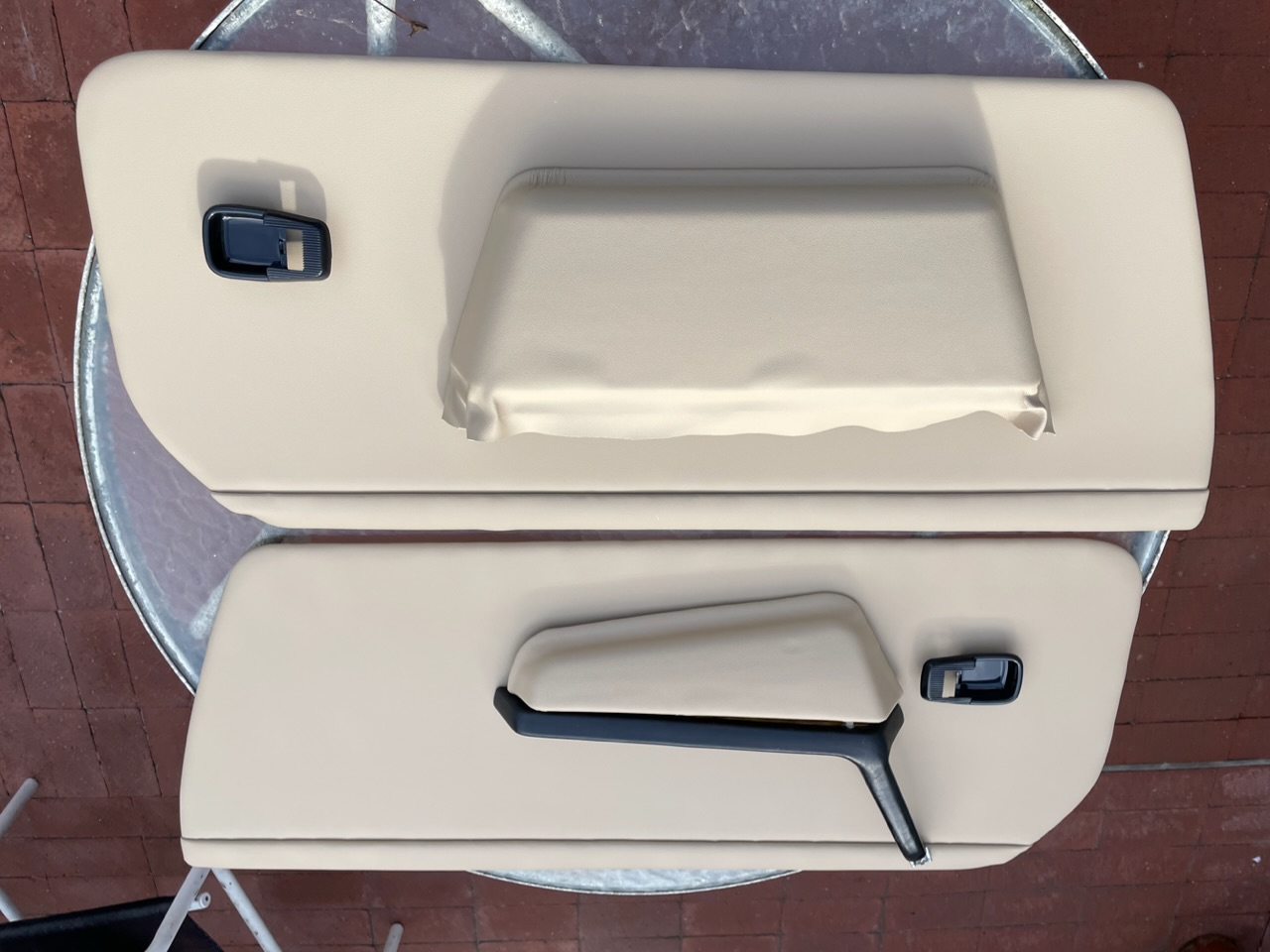

Just got these today. Really nice looking and matched the beige leather seatsI have a little finish up work to do and have a couple of questions:
1. PSsenger side looks straight forward; need to locate a cover for the handle
2. Driver side, got the cubby, but forgot how it gets attached to the panel
Suggestions will be appreciated

Need to know how this gets attached to the door panel
I’m going to trim and glue the edges; not a problem

QUOTE(jim_hoyland @ Nov 7 2022, 04:57 PM) *
It should have small screw holes to screw it into the door card. Door card should have small metal inserts. The screws set into a little recessed trim washer
Show us a pic of the back of the door card.

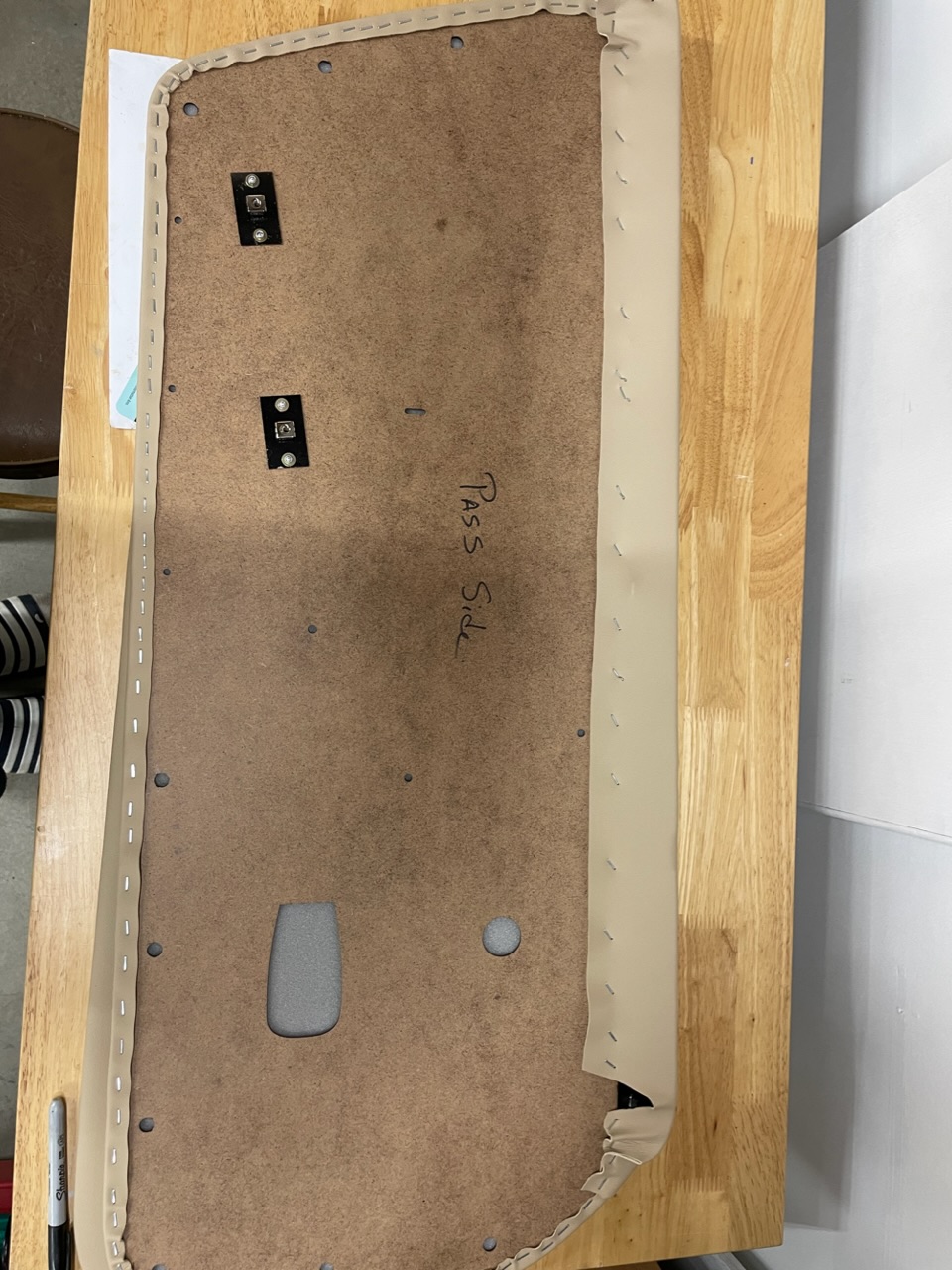

QUOTE(mepstein @ Nov 7 2022, 02:19 PM) *
This is passenger side

Member No.: 822
Looks right to me. The three small holes are for sheet metal screws that hold the door pocket. The large holes are for the panel clips.

Member No.: 3,348
The holes 3, 4 and 5 are for the passenger lower secton of the htop habdle section.
You can see this on the passenger side. The 4 and 5 holes have an additional 2 holes that allow mounting of the 2 plates that hold the cage nuts.
We cut the panels the same so they can be used either left or right.
I predrilled the holes on the drivers pocket. They will line up nicely with the panel and screw holes in the door.
Hope this helps.
