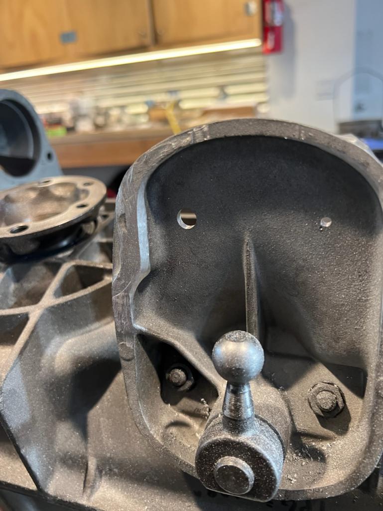

Motosan
post Jan 18 2023, 12:04 PM
Posts: 33
Joined: 14-October 22
From: California
Member No.: 26,919

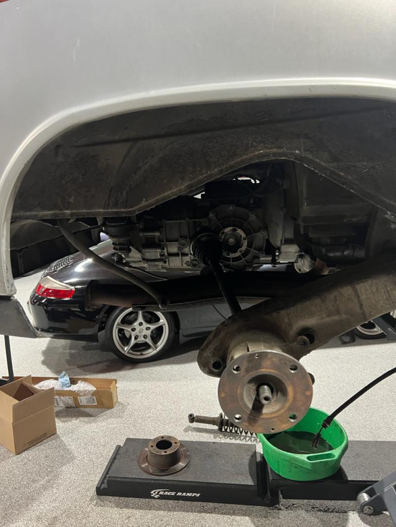

Finally getting some work done. Trans is rebuilt and going in, a few tangerine racing/jwest parts going in, and some interior pieces getting removed.

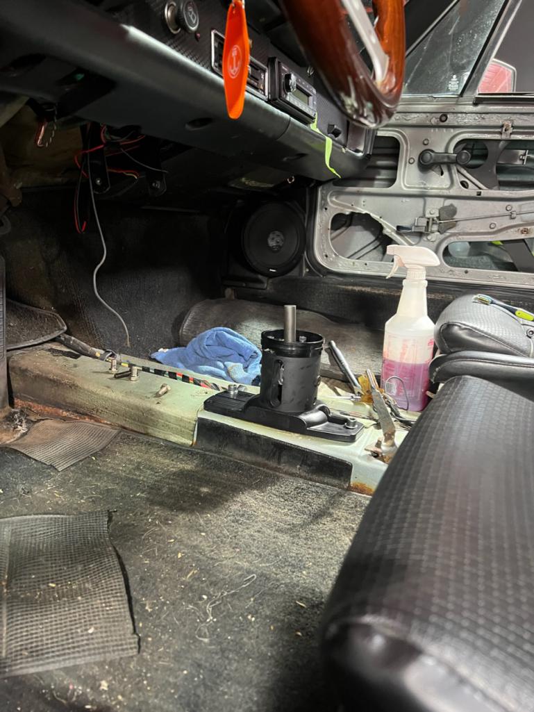

Motosan
post Jan 18 2023, 11:37 PM
Posts: 33
From: California
Member No.: 26,919
Have the center console out for the shifter install and trying to decide why I would put it back in. Anyone regret not having put it back? Seems like a very big box that holds a couple gauges. Looks like I can replace all the gauges and consolidate them into one dash unit.

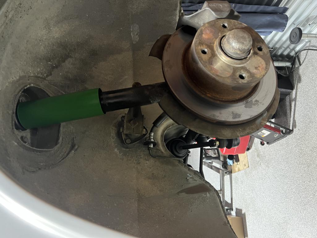

Motosan
post Jan 21 2023, 10:17 PM
Posts: 33
From: California
Member No.: 26,919
Torsion bars were very stuck but turbo tie rods and a arms went on according to plan.

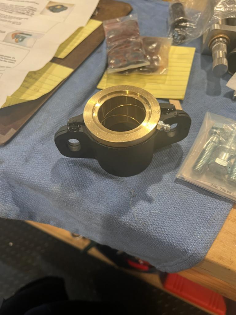

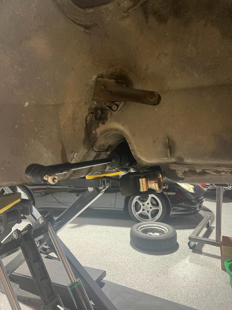

Motosan
post Jan 25 2023, 11:16 PM
Posts: 33
From: California
Member No.: 26,919

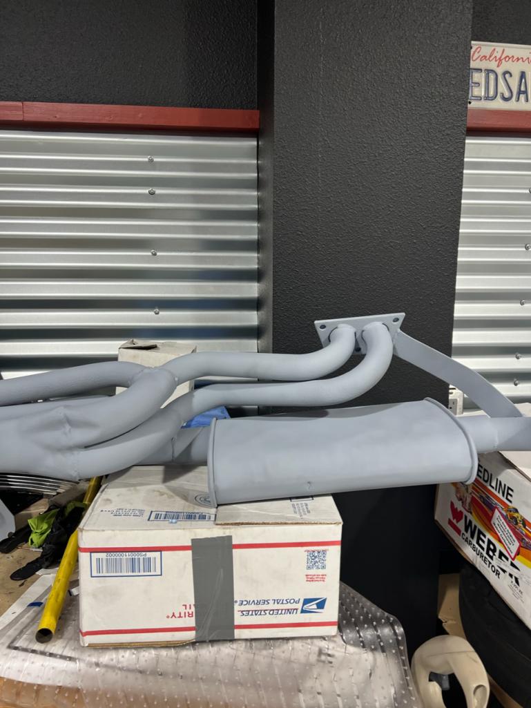

Front end almost done, rear end started, and a very rusty/dented exhaust blasted/primed.
Couple of small bumps in the road but making progress!
