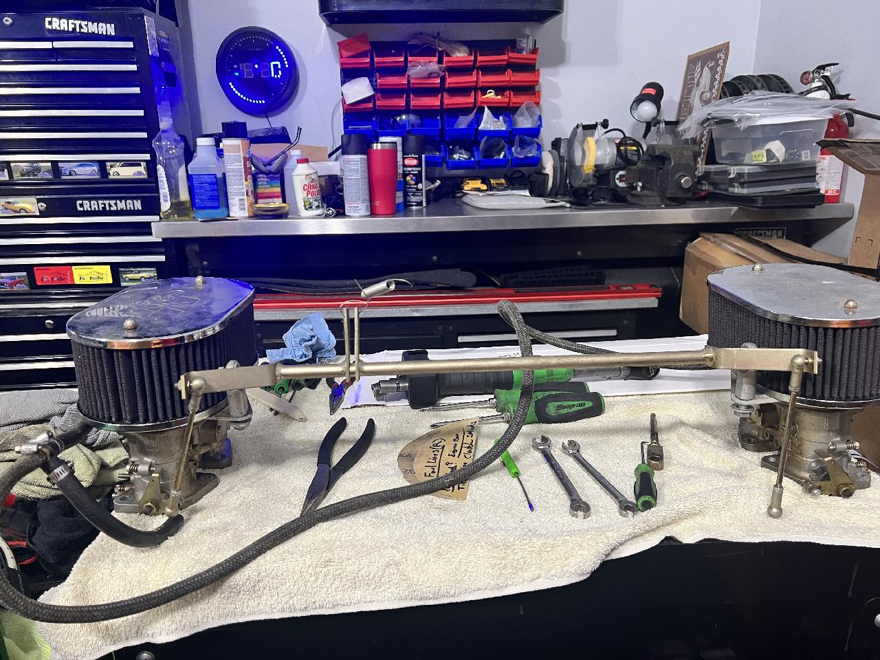

pictured is the carb setup from when I took the engine out.
It was a single line feed but I want to put a return line back to the tank.
Where would I T that in the plumbing?

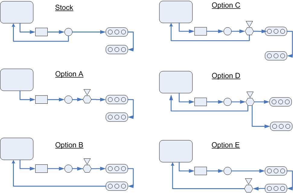

Plumbing options

Option E

What do the symbols stand for.
914werke
post Dec 9 2022, 01:28 PM
Posts: 11,624
Joined: 22-March 03
From: USofA
Member No.: 453
QUOTE(JmuRiz @ Dec 9 2022, 11:06 AM) *
Tank Carbs Pump Regulator Tee Lines
brant
post Dec 9 2022, 01:45 PM
Posts: 12,179
From: Colorado
Member No.: 47
QUOTE(914werke @ Dec 9 2022, 12:28 PM) *
Plus fuel filter before the pump
GregAmy
post Dec 9 2022, 01:59 PM
Posts: 2,654
Joined: 22-February 13
From: Middletown CT
Member No.: 15,565
Oh the rectangle is the filter? I thought it was the pump. Makes a lot more sense now.
Rectangle = filter
Circle = pump (stock is internal bypass)
Hexagon = pressure regulator (some bypass, some not)
Ovals w/circles = 6-banger carbs.
Only option B or E with full-flow banjos will give you the vaporlock-proofing you want. I personally don't see it as necessary but it certainly will be better. - GA

What does having the regulator after the carbs do for the system?

QUOTE(NARP74 @ Dec 9 2022, 03:19 PM) *
Maintains desired pressure at the carbs and allows full fuel recirculation as close to the carb inlet as possible.
This is how the stock D- and L-Jet do it (as well as most legacy EFI systems) but at a higher pressure of course.
OEMs are moving to returnless systems for reduced hydrocarbon emissions and reduced complexity (my '08 Civic Si race car is returnless.) - GA

I've used that option picture before and really like "E". Circulating fuel back to the tank and grabbing cooler fuel to feed the carbs helps make for a stable system.

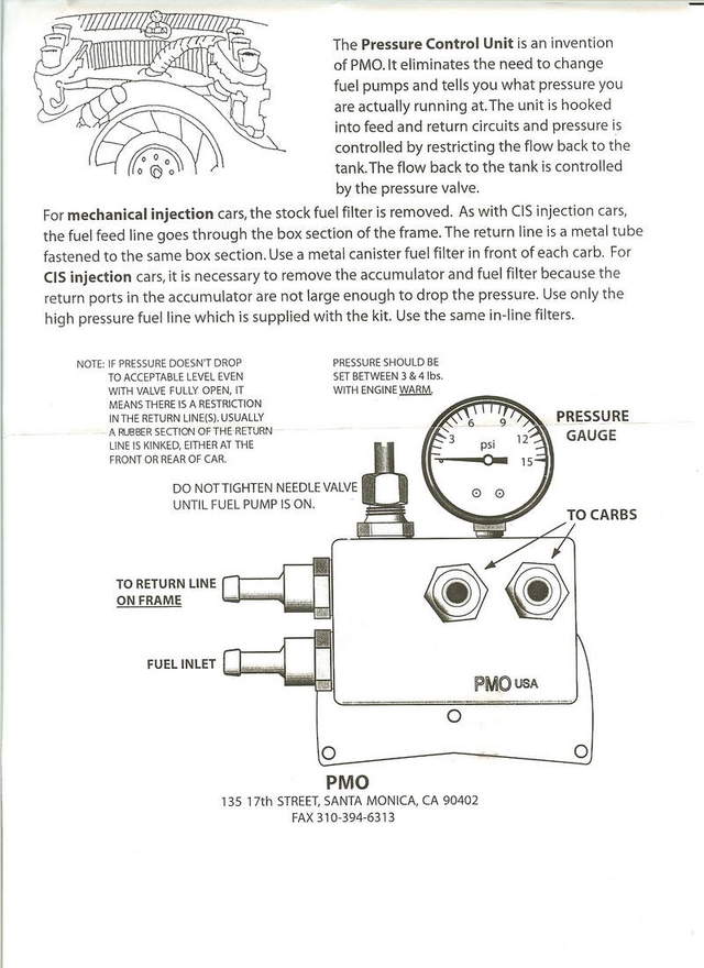

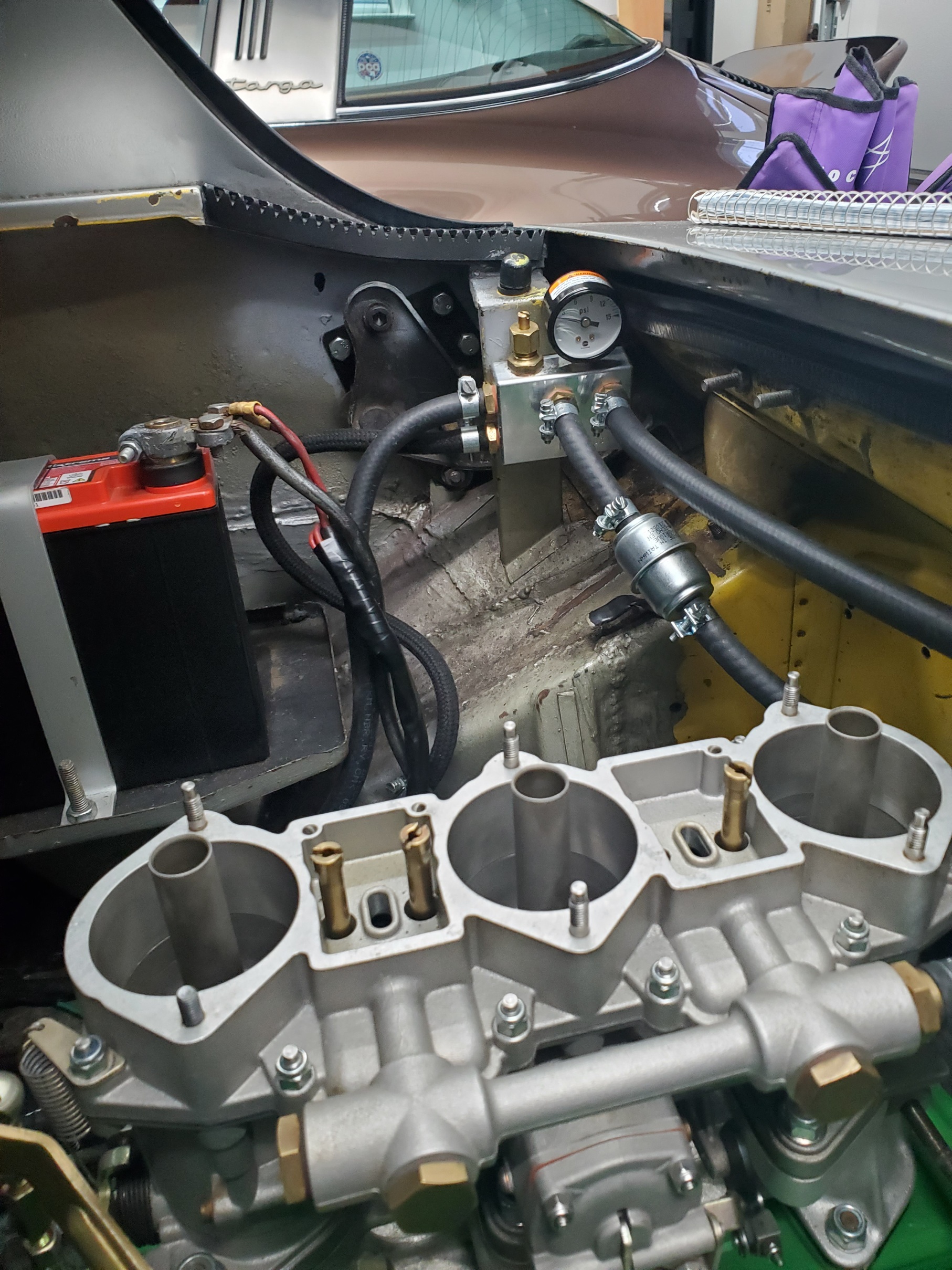

Here is how I mounted my PMO regulator. Originally when I had Zentihs I wasn't running one and even before that with dual dellortos I wasn't running one. I already have the cb performance rotary FP up front so this is a little overkill, but it allowed for a return and it came in my PMO kit so might as well.

I also like the "E" option but have been running "C" for 7K miles and it works well. Here's the regulator I'm running and it has worked well. The pressure to the carbs hasn't budged since originally setting to 3.5 psi.
