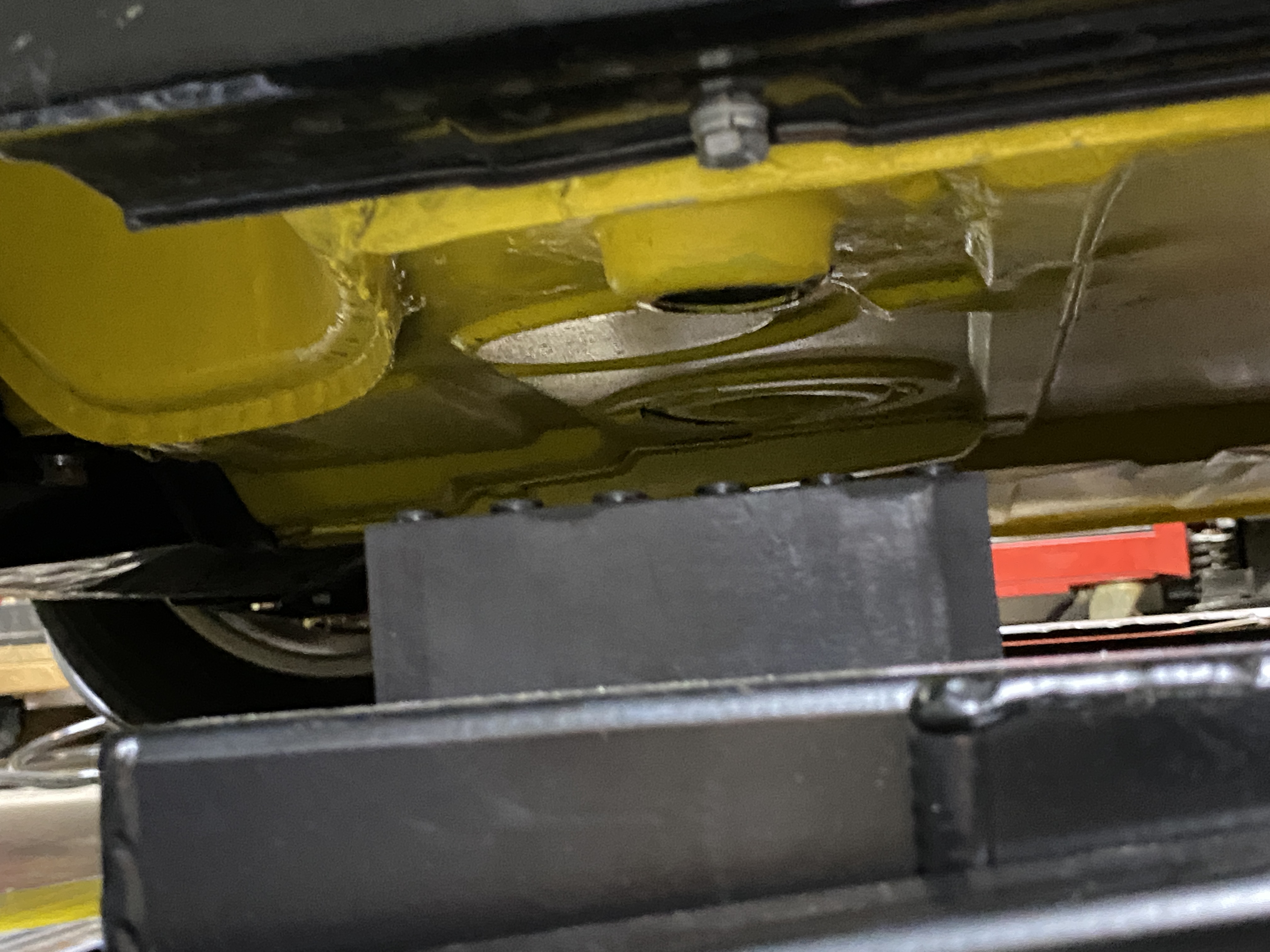

I recently got a Quickjack 7000 TLX. I need the long X model to reach the jack points on my other vehicles. But I have failed to lift the 914.
My first attempt had the Quickjacks in the "official" positions, i.e. with the lower base pivots forward. Note this is not what I consider safe for 911s and probably for 914s, since the car center of gravity can end up outside (behind) the end of the lower base.

But the rear jack point is far forward of the lifting pad, even with the pad as far forward as possible.

And the rear lift pad, as far forward as possible, does (barely) reach the jack point.

But as the car lifts, and the suspension drops, the front wheel makes contact with the jack, and becomes impossible to remove.
I know that the jacks can be used sideways. What have you all found?

Bob, It has been pointed out to me that those aren't necessarily jack pads but rather attach points used during assembly. Just as long as your under the long your OK. (IMG:style_emoticons/default/beerchug.gif)

You should have the pinch weld rubber pads. You can use those and go under the longs. Or the sideways method works, I have done it too. But can't engine drop easily on the sideways lift. Good for oil changes and brakes etc....
If it didn't come with the pinch weld pads, look them up on their site.

I agree, If you can lift it at the longs, you are good. A set of 4 hockey pucks with a grove cut down the middle to accept the pinch welds would be great. I've never used a quickjack so I don't know what works best. It never hurts to use a 5th point of contact, like a deadman or a tall jack stand, to help guard against a weight shift if you are dropping an engine. tires will do in a pinch.

Do not try to flip the lift sideways. As it lifts, the car normally moves forward as it leaves the ground. If lifting sideways, the car drags the wheels sideways against the tires and makes an unsafe lift. ask me now i know!. I use the longs with the pads on the pinch area.
You can use the engine crossbar ok. Pictures look like that's a fit. I think the 7700 is too long however.

Only if it is the later solid mounts. On early side-shifter cars, that will destroy the outer rubber mounts.
And as mentioned above, those round "donuts" aren't jacking points. Neither of them is supported by anything structural on the backside and you will buckle your floor-pan if you lift there.

I’ve been using the donuts….. So just to clear the pinch weld on the longs would be the best place to support the car?

On both front and rear I use a larger board over the pad that meets both the donut and pinch weld, very stable.

Seconded (thirded?) for NOT putting any significant load on the front donuts. You will just bend the floor. Ask me how I know.... conversely the rear donuts are better structurally secured, but agree that the pucks that pick up the vertical pinch feature are preferred.
