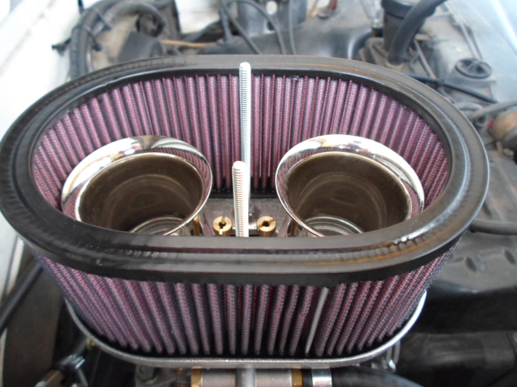

My 2.4 L with Weber 44 IDF carbs, came with no name air filters. Could not find a source for the weird sized ovals and decided to replace the entire assemblies. I found a kit from K&N made for the Weber 44s (K&N 56-1170). Didn't think much of the flimsy quality but better than nothing - or so I thought.
After I installed them I drove around very little, maybe 50 miles at most before the 914 went into winter storage. I noticed one of the tin caps had lost the screw - I hope like hell it fell out onto the road and not someplace where it can do damage.
I know I tightened them down to the point where I was afraid I would crush the filter or bend the tin cap. Checked the other side that still had the screw, it was not as tight as I had originally made it. It too had backed off. Took off the cap and pulled out the filter element on the carb where the screw went missing... WTF? it is warped? Looked closer and the damn thing is full of holes. Like some have said an old sock over the carbs would be better than a K&N filter. See the photos.
Not going to have the screws fall out again - I replaced the taper flathead screw with a screw from below (with red loctite) and jam nuts on top of the tin cover.
I have joined those who hate K&N - never again. So much so, that I want to get rid of them and replace them with something more reliable that actually filters air.

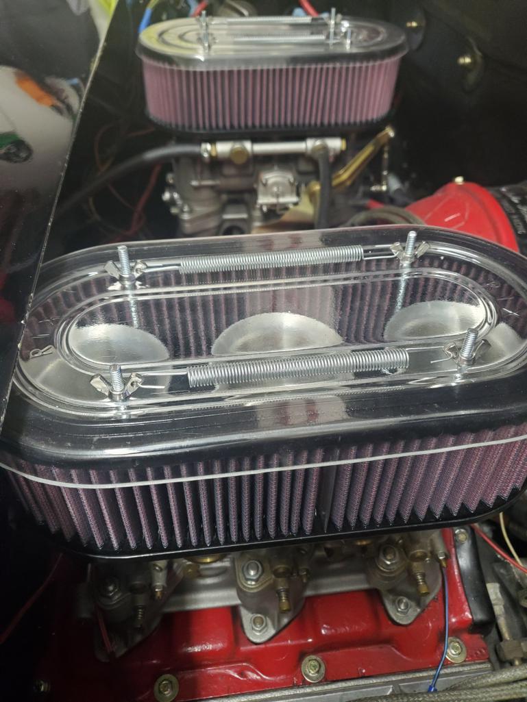

Yeah i am used to seeing the two bolt versions. One is weak. Did yiu use blue loctite? May be helpful. See below how i did them for my six. Drilled holes in the wing nuts and use spring as retainers. Effective and easy.
The holes in the filter are purposeful but totally get your frustration.
ITG makes a nice product and elinates you warping issue. However they dont offer much rain protection as they are a foam like material without top shield as i recall.
Good.luck!

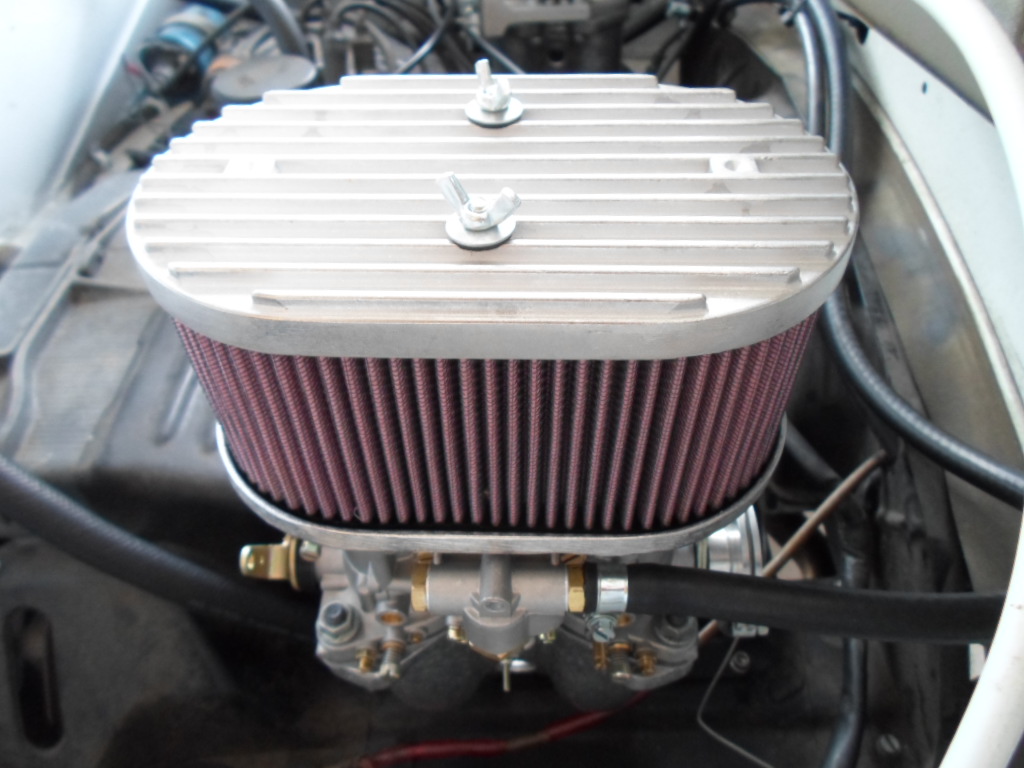

I got my stuff through CBPerformance. I haven't had them on that long, but they aren't coming off, and, so far, the filters have held up well. The only caveat is that these housings have a much thicker baseplate, so you will almost definitely need to buy the longer studs, which are as follows:
7218 Long Velocity Stack Securing Stud (6 x 50)

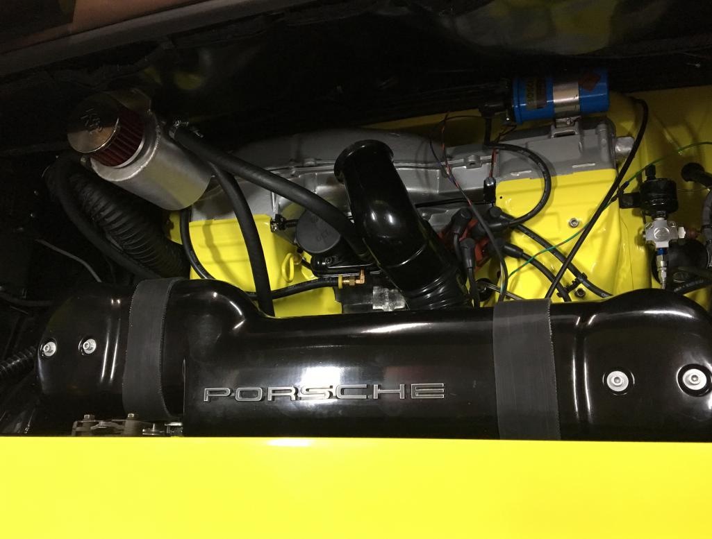

There are a couple of high dollar solutions on the market ($1000+) out of Europe if I recall. Or you can do like @bbrock and custom fabricate your own. Brent’s is impressive but I know he put a ton of work into its fabrication and getting it to fit properly with a rain tray.

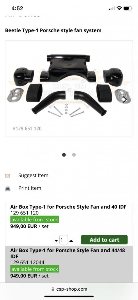

Ancient thread but it will give you an idea of the high dollar CSP thing I was referring to.
http://www.914world.com/bbs2/lofiversion/i...hp?t110167.htmlAttached Image
@vitamin914
No idea how well this works or fits, just aware of its existence.

Where does that ship from? Individual, conventional paper filter, assems cost a lot less than 1k+ a pair. What is a ‘Porsche Style Fan’? Like the
FAT style one? Free shipping for a set from CIP1.
Superhawk996
post Feb 1 2023, 07:30 PM
Posts: 8,096
Joined: 25-August 18
From: Woods of N. Idaho
Member No.: 22,428
QUOTE(rhodyguy @ Feb 1 2023, 08:11 PM) *
CSP is out of Germany I think.
Yes it is for a Type 1 engine with an upright Porsche style shroud. I have no idea how it will fit to an 914 with an engine lid or rain tray but I would expect that it is probably made of ABS plastic or fiberglass and could be a starting point for modification.
Brent definitely hand fabricated something similar and made it fit so I’m sure the concept is valid.

The CSP air box is an interesting setup. Expensive and it may or may not fit the 914. It would be a gamble and having to modify it to fit is not something I want to add to my list.
