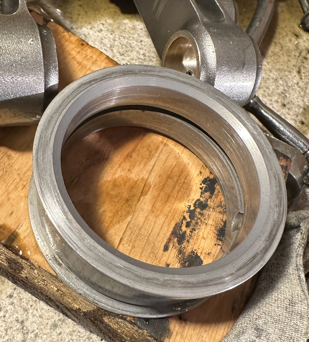

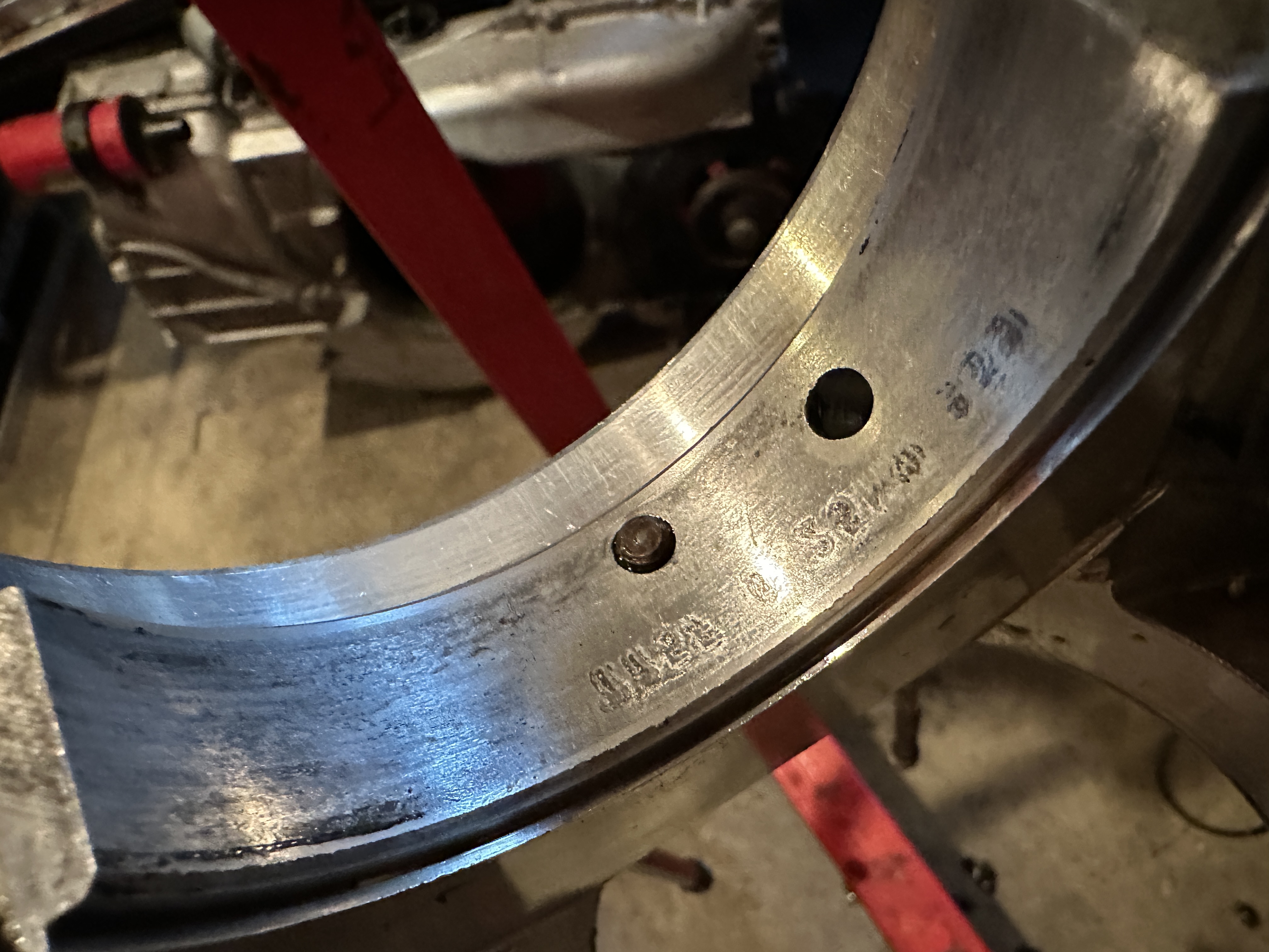

Here are come pics of case split and inspections Attached Image

another of the saddle and low pin locator

rear thrust againAttached Image

so what are your impressions of your observations pictured here? how many miles since it had been rebuilt, it seems like just recently you completed that rebuild?

This build and the last build had a total of less that 100 miles the Failure again was the top end intake valves and guides. Ill post pic of the worn out valve guides
The bottom end seemed OK. but erratic oil pressure problems I am sure added to the guides issue
Also The Crank end play had .0045 when assembled and CHECKED
I added the rear main and the play went to zero . Sound like a familiar thread others have seen.... I continued any way thinking the seal was adding the buffer to the clearance. I had howling bear noises and the wear pic on the side of the thrust confirmed it was tight. Looks like new bearings and pump for bottom end I will check the saddles for possible line bore

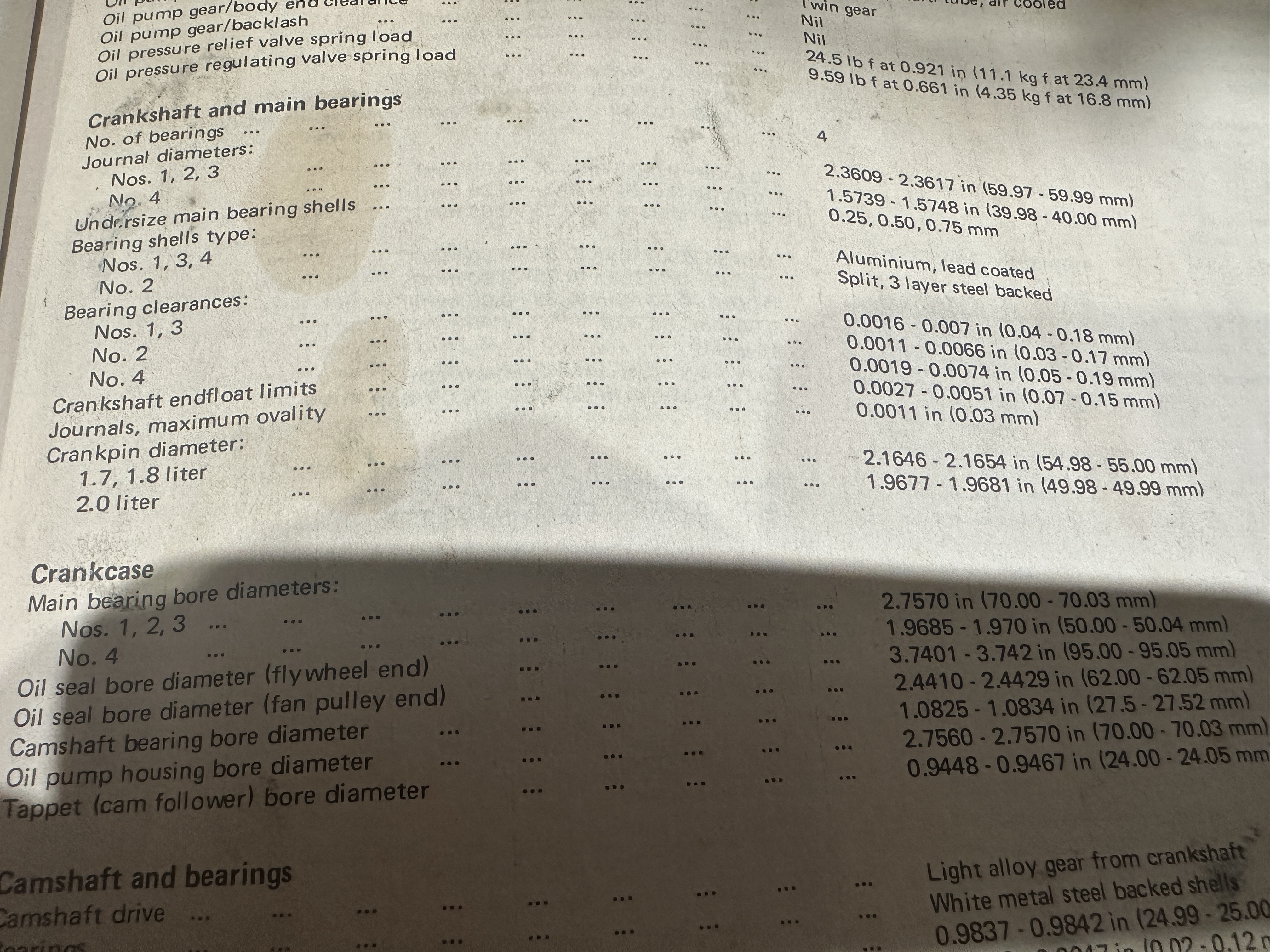

PHil- what is hte proper end play i am looking for for the crankshaft end play?

Crankshaft float s/b .004" plus or minus .001".

check in without seal and again once the seal is installed. should be the same.
0.0027 to 0.0051. most shoot for 0.004”
Place the thinnest shim in the center of the three shim pack.
