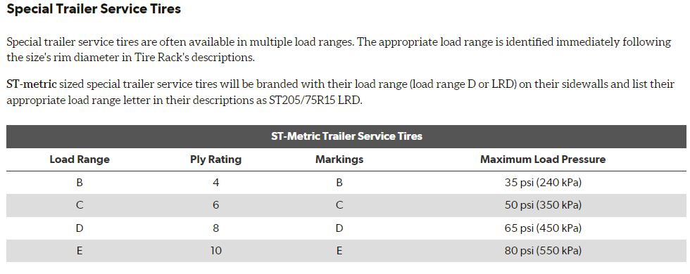

I just bought tires. I went with "D" Load range, because I have a dual axle trailer, and the tires are engineered to hold up to 2500# of weight per tire. That's a lot of 914s. (IMG:style_emoticons/default/rolleyes.gif)
6 ply is probably enough, 8 ply is plenty, and 10 ply is for lots of extra stuff. Open or closed trailer should probably be a deciding factor.

Having towed race car and horse trailers for more than 24 years, I am a believer in quality trailer rated tires that are sized for your load. Load range D (65 psi) or load range E (80 psi) are what I use.
