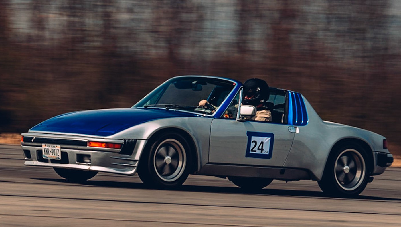

I love the look of those wheels. Of course, there are other ways to fit them under a 914 without rolling the lip...
