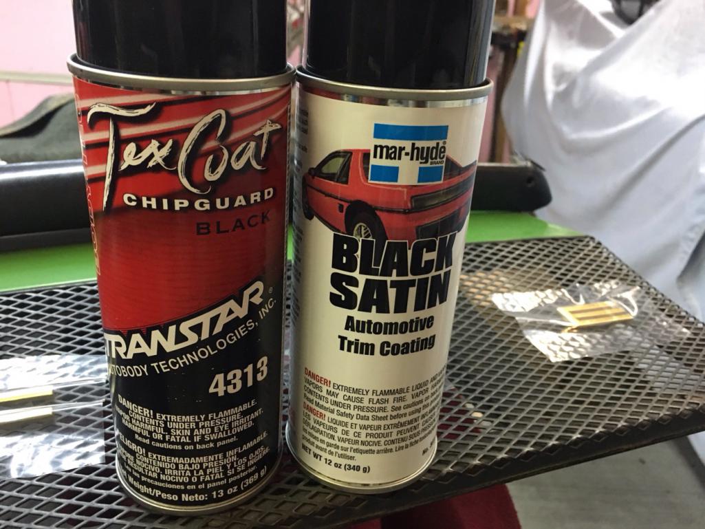

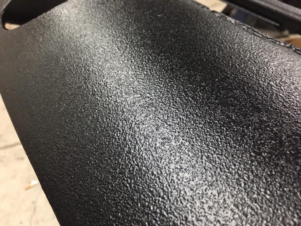

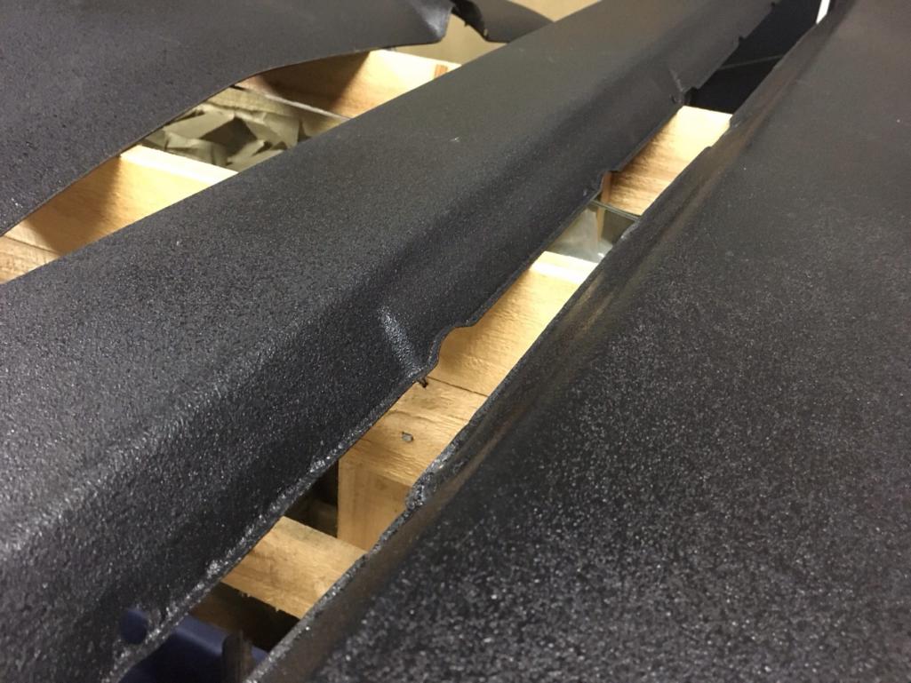

Here’s what I use, it comes out very close.

QUOTE(Garland @ Feb 20 2023, 10:58 AM) *
That is beautiful!
My 75 appears to have smooth valances and rockers.
Is the pebbled appearance correct?
