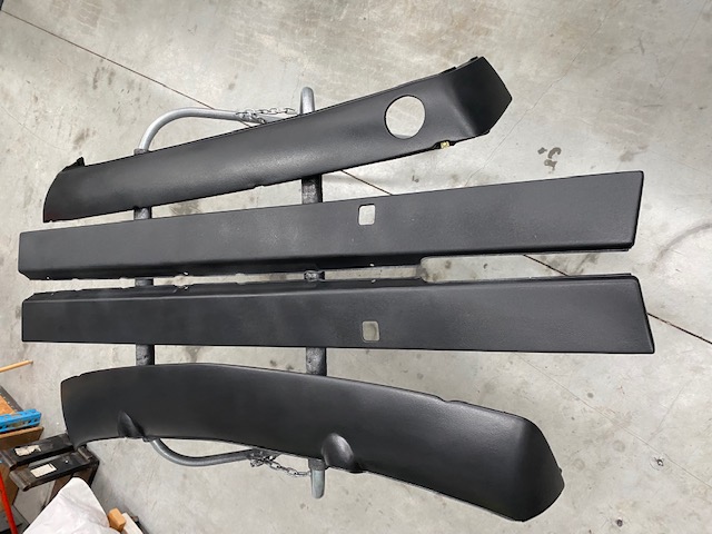

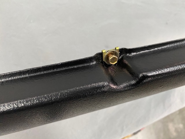

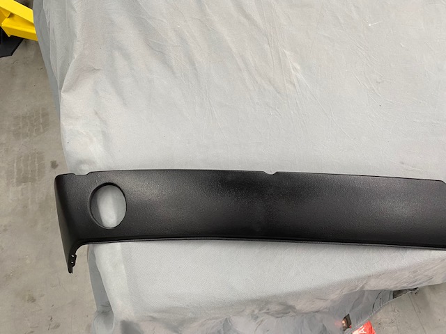

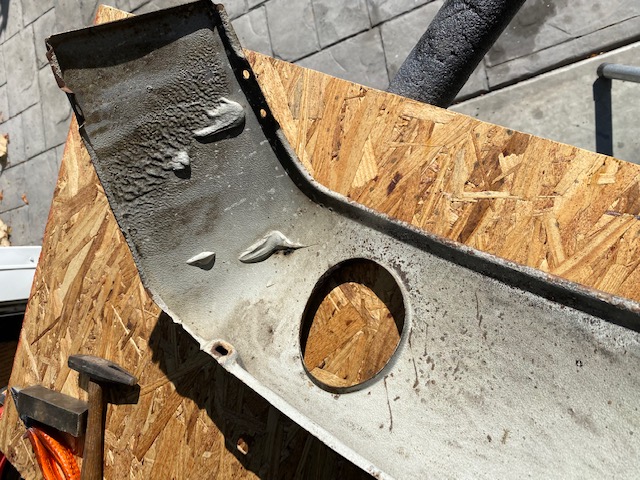

I just went through this process on my early 1970 914-6.
Rear valance inner finish is original only re-painted out side was re-textured and re-painted.
Both my original rockers and front valance had a thin coat of texture on them; light tan color similar to 911 fuel tanks only much lighter in coverage.
The texture was duplicated with Wurth body Schutz in tan and painted with SEM satin black trim paint from a gun.
A notable difference is that the rockers have a finer texture than the valances.
Also I have an original paint rocker from a 1975 car that has no texture so it appears they changed during production undoubtedly to save money.
With the re-plated original hardware they are like new.
A lot of work to get them right but the results are stunning in person, photos don't do them justice.
Attached Image Attached ImageAttached Image
aturboman
post Feb 3 2022, 03:28 PM
Posts: 171
Joined: 18-October 11
From: CA
Member No.: 13,687

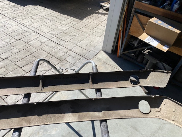

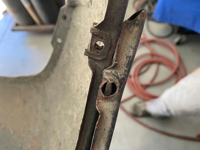

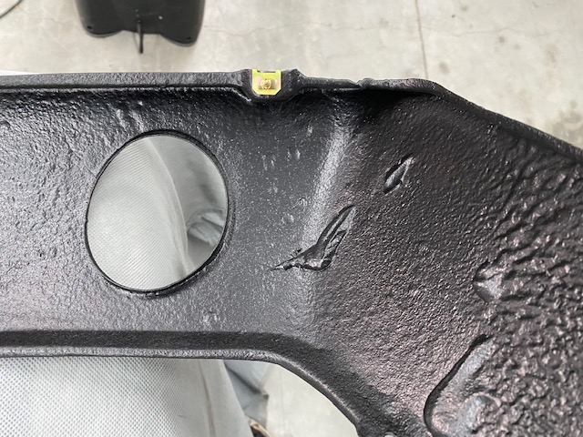

Here is the rear valance backside before painting, after pressure washing.
You can clearly see the texture from the factory.
Also a comparison of an early and late 6 rear valance; later versions have the reinforcing ribs
Attached ImageAttached ImageAttached Image

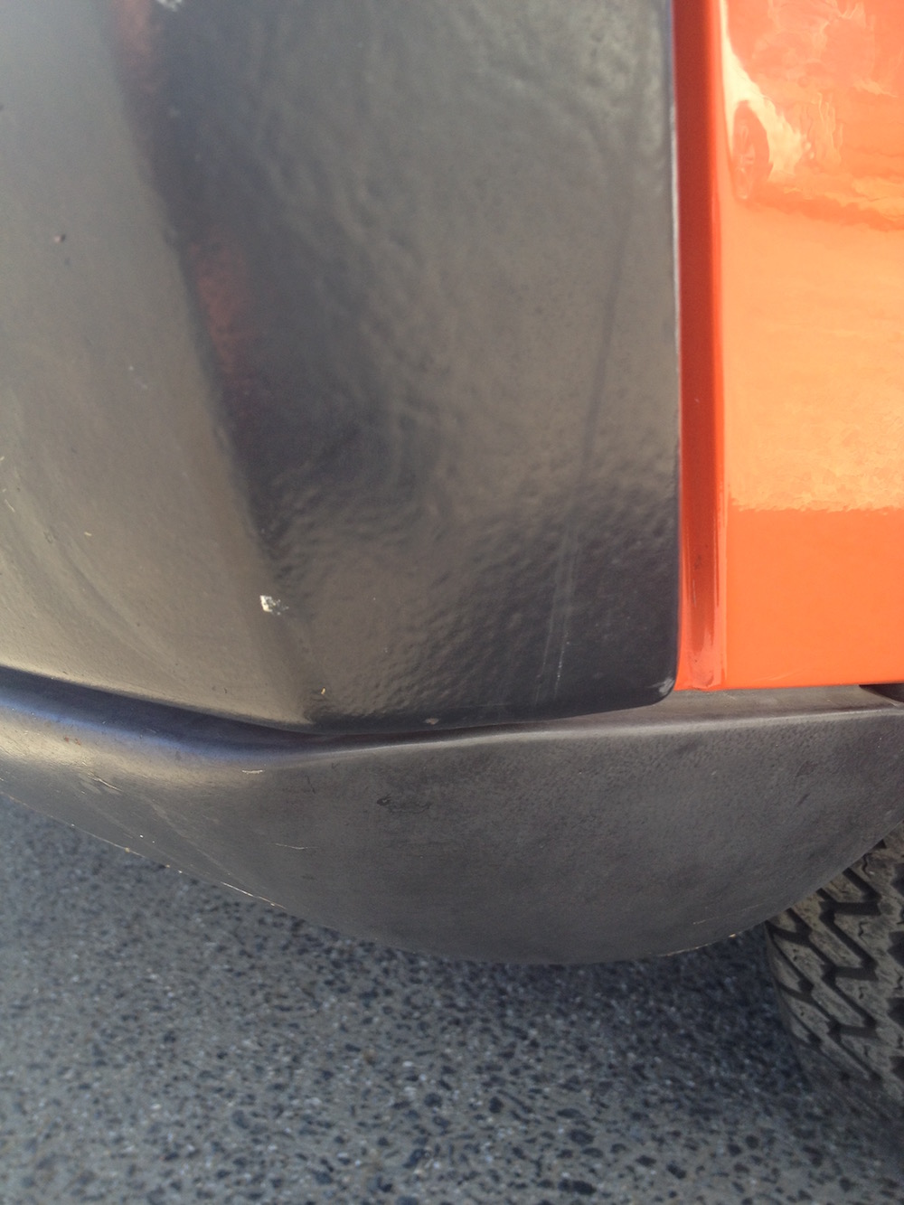

if its any help.
this is my 74.
original paint all round.
would describe the valence and rockers as a very fine sort of orange peel.
some kind of schutz.
bunpers are kind of the same but the orange peel is less fine and "larger" dimpling.
which ends up being smoother.
i figure both are some kind of stone guard paint.
