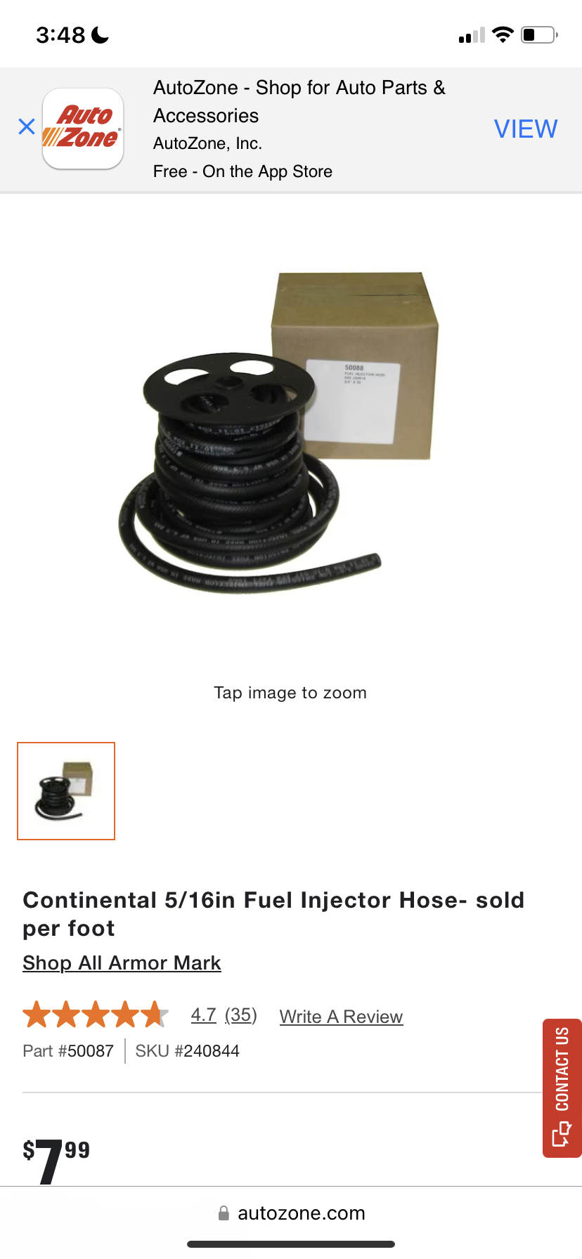

Amazon - buy Continental hose in bulk 25’ roll and resell? About $118 for a 25’ roll of 5/16” (8mm) line. I would avoid the no name or anything branded “Evil” on Amazon but that’s just me.
Looks like Autozone sells Continental brand “fuel injection” hose by the foot on-line? I would be surprised if they didn’t stock it in store. Just ask to see the hose and make sure it is marked SAE30R9. Doesn’t have to be Continental brand but iI would want it from reputable brand like Continental, Gates, Goodyear.
Seems odd to me that you can’t find it locally in your area?
