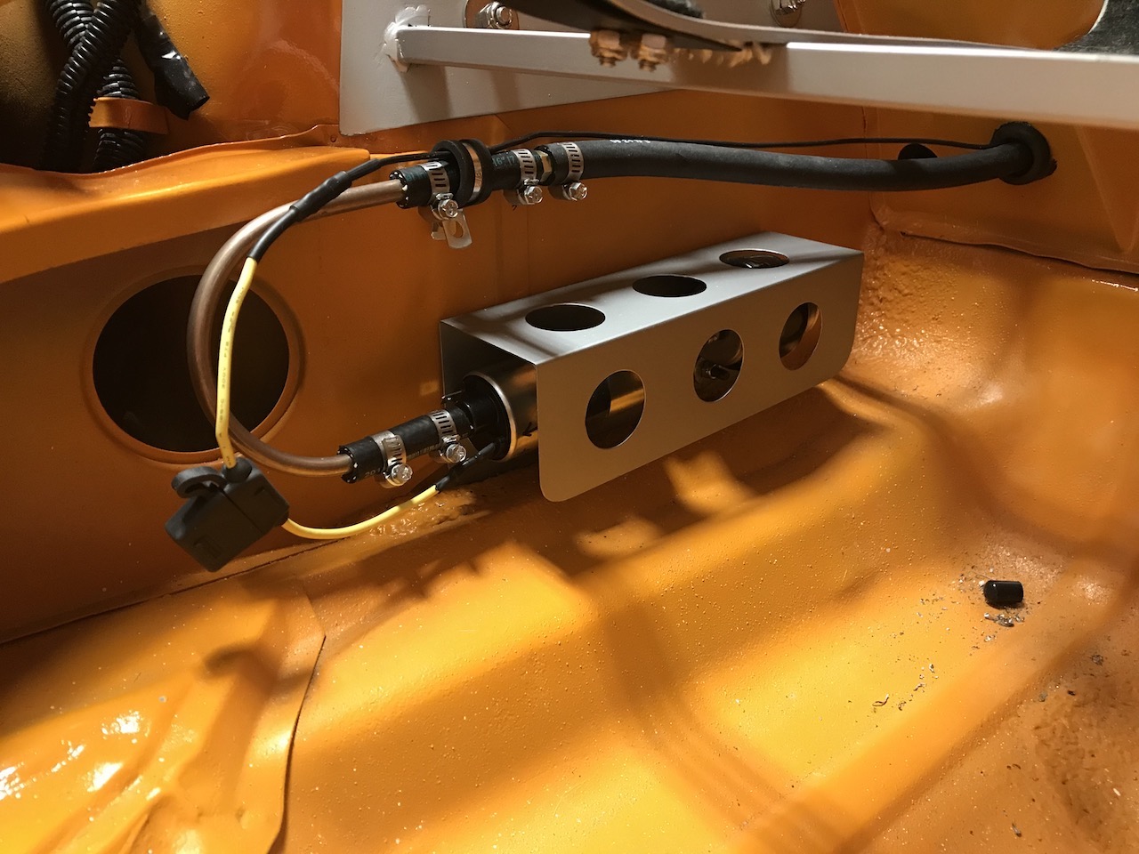

bossboy302. Living in Wisconsin, time on the road is less than six months and then a big nap each year. I love the PMO's, installed a inline fuse for the fuel shut off and MSD. Nice simple setup that I understand. Best, MarkAttached Image Attached Image
