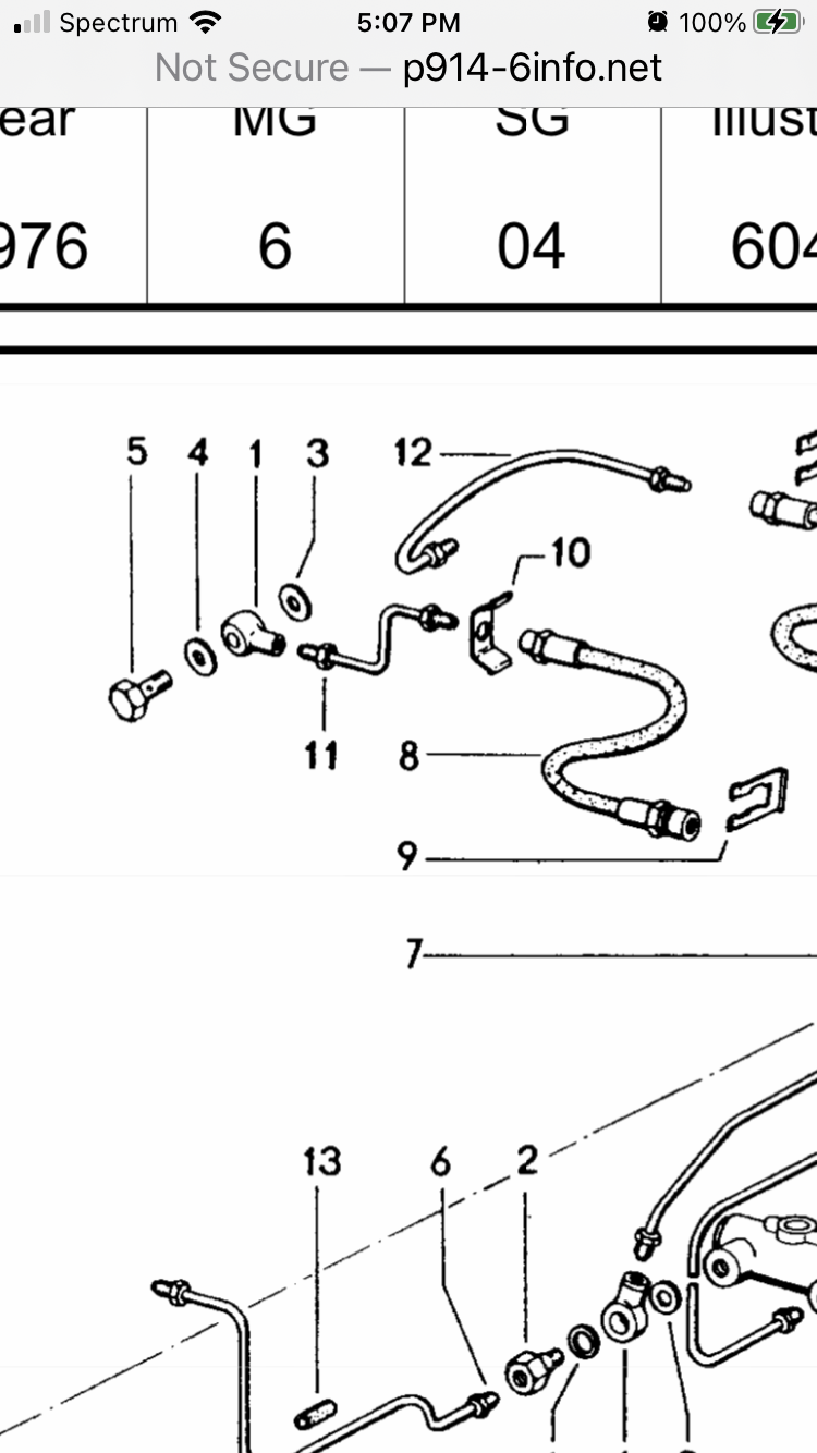

The brake line used a banjo bolt

The connection from the hardline to the caliper is a banjo bolt. No need to bend the line. It’s a very common way to attach the brake line to a caliper.

Many front calipers use the Banjo connection for a right angle direction change. It has a hollow bolt with 2 different copper washers and the brass banjo.

The items you need are listed in the PET
Numbers 1, 3, 4, 5

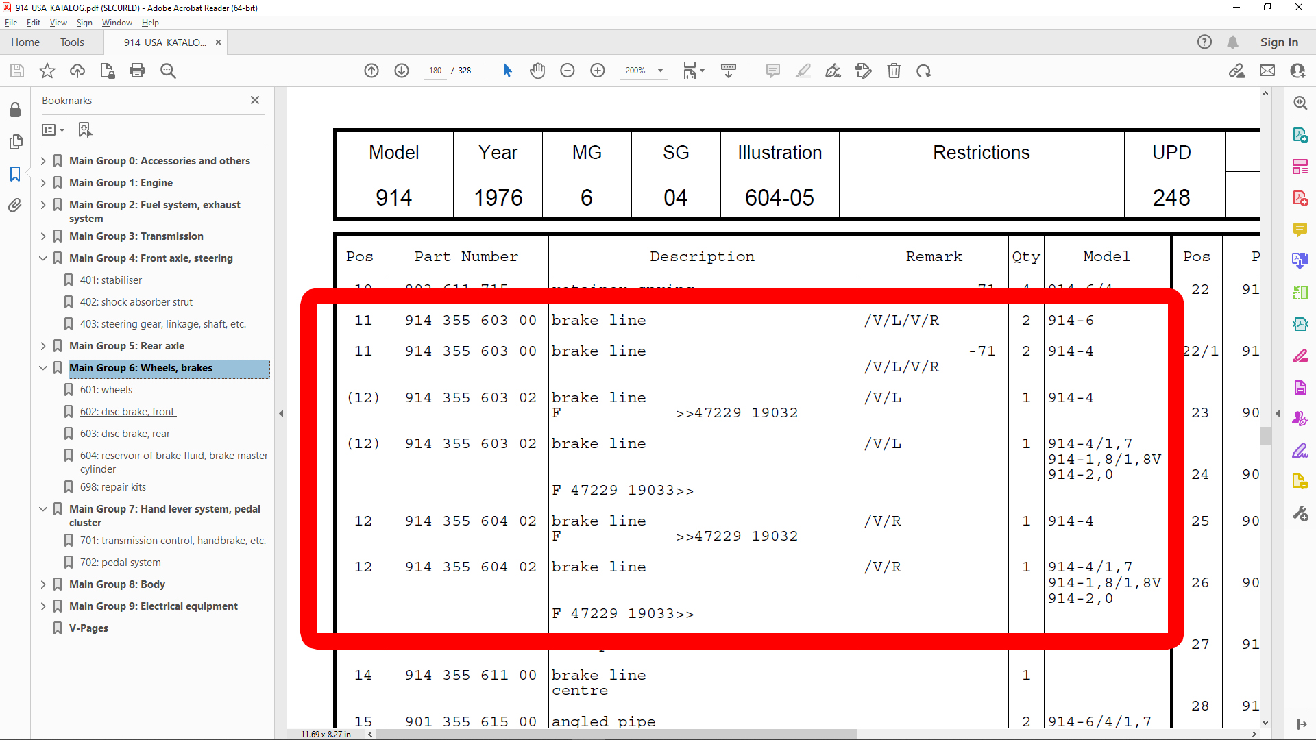

I'm having a similar issue: I want the brake line have a bend in it that allows it to go into the caliper without a banjo bolt. If you look at the PET, there are 2 hard lines that go into the front calipers. One has the 90° bend, the other does not and requires the banjo.
#11 is for cars up thru 1971 and #12 is for cars with VIN 19032 and later, if I'm reading the PET correctly.
I bought what I thought were the correct hard lines from PMB, but they are the same as #11, even though my order was indicated as #12. I could not easily find the banjo bolt and other parts on PMB's site. I will be calling them on Monday top get some clarification.

914 RZ-1 is Right.
The later front caliper, 73 on did not have the banjo bolt. Seeing how the correct hard lines should be $20 a pair, and the Banjo bolt complete set on Pelican and PMS are about $70, I think I'd just opt for the correct later set at $20 and not spend $90 for 8 inches of brake line...
I have 3 cars here that have this on the front...
Eric_Shea
post Mar 6 2023, 09:03 AM
PMB Performance
Posts: 19,304
Joined: 3-September 03
From: Salt Lake City, UT
Member No.: 1,110
As per Mike's post, you have a late caliper and an early line. You need to order the late lines and it will bolt right in. Banjo not needed or recommended for the late calipers.
https://pmbperformance.com/products/12-cali...14-72-8-76-pair
Keep in mind, the parts diagram shows the correct line, the photos are for representational purposes to show the various materials (OM Steel, Stainless Steel and Cohline Green). They just so happen to be the 914 355 603 00 line that you "don't" need so, that may be confusing.
