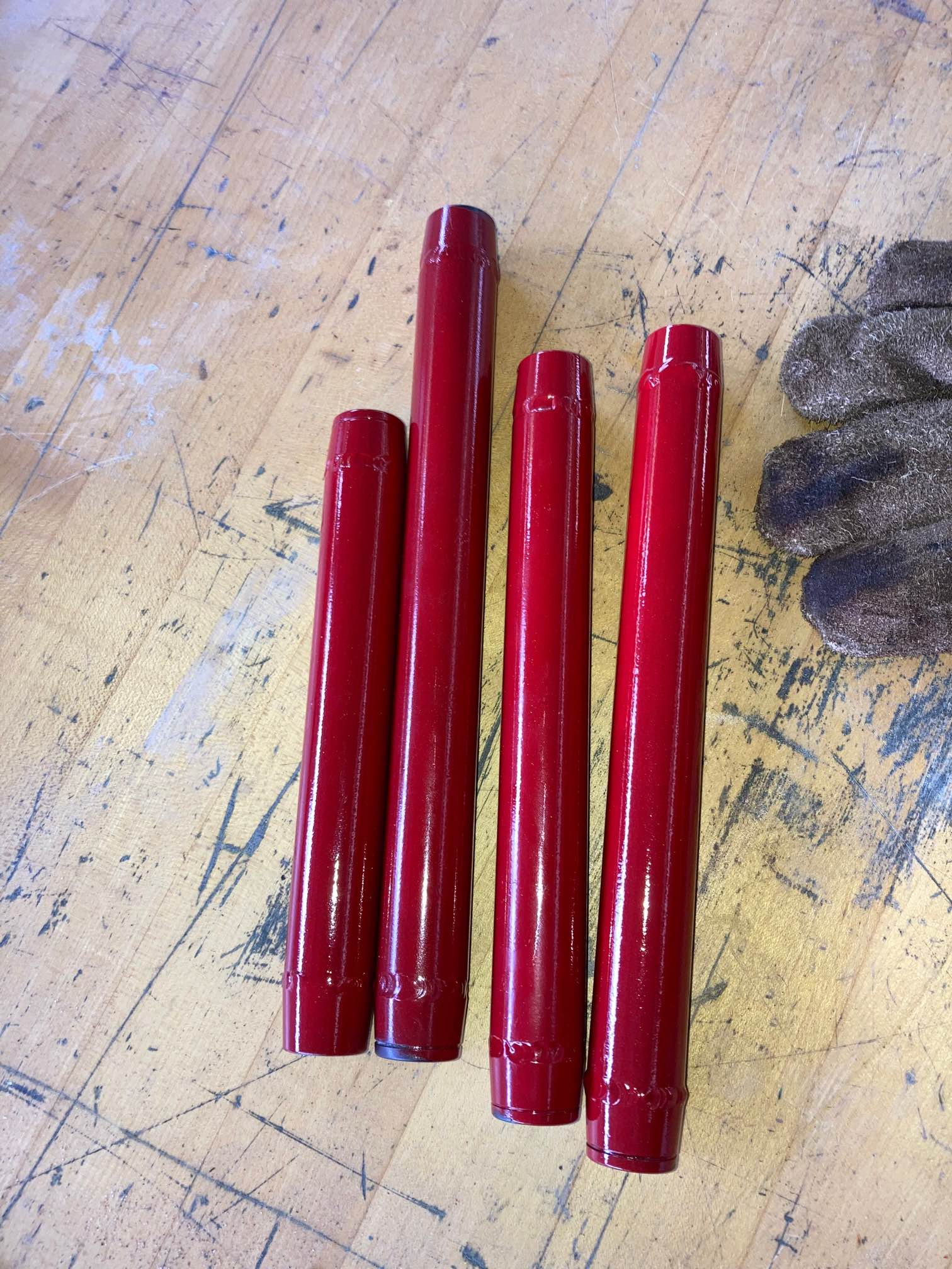

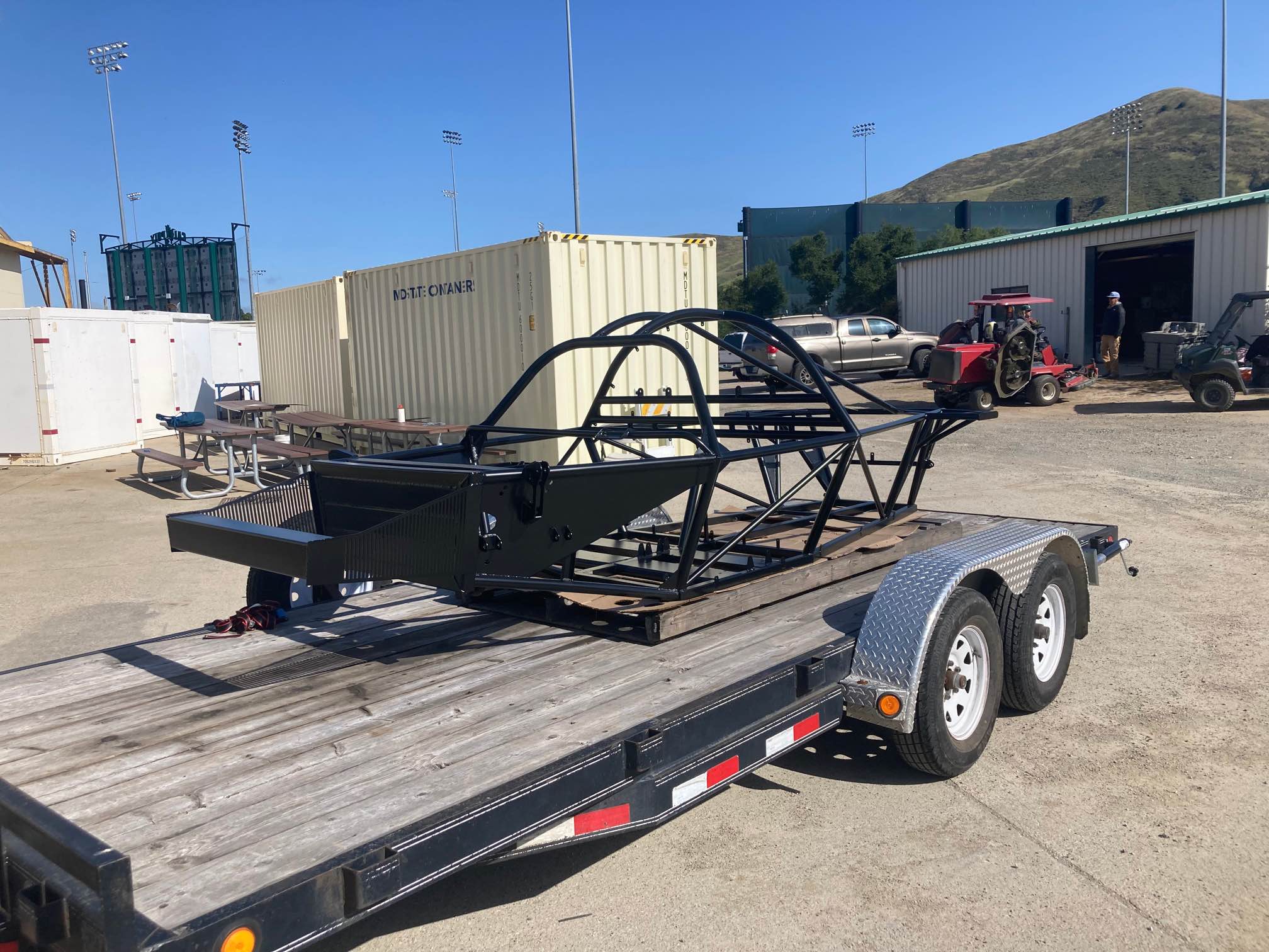

Next round of updates:
The chassis is back from the powder coater and it is looking sweet - pulled a few long night welding sessions with my buddy to finish it before it went off.
Or so I thought. Was then told by a member of our Aeroshell division that there is a giant plate that must get welded in. (IMG:style_emoticons/default/headbang.gif). Well I've heard POR15 is a pretty good match for satin black. (IMG:style_emoticons/default/dry.gif)
While it was away we took the opportunity to powder coat a few small parts ourselves - control arms, support plates, and other odds and ends.
If I had known how easy powder coating is I would have said we do the whole car ourselves! (IMG:style_emoticons/default/lol-2.gif) If only we had a furnace that would fit the chassis....
In any case, we are hoping to have a rolling chassis with power by the end of the quarter.
