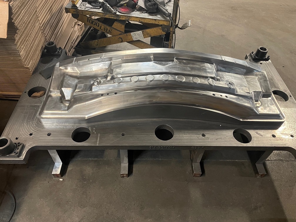

Porsche did weird things like this all the time. A generic part that would fit all MY with a little bit of modification.
Here is a sneak preview of what is happening. I am still a ways out from having it ready, but this is what is coming down the pipeline for 914's
Pete

That’s awesome. So many are rusted or damaged. Pricey for m sure but look at what 914’s are selling for these days.

Would love to see a video of how these panels are made.

And I'd like to see the monstrosity CNC Mill that does the work. (IMG:style_emoticons/default/drooley.gif)

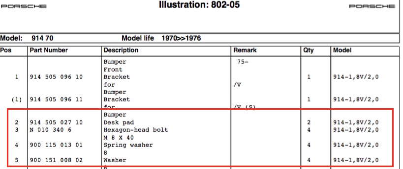

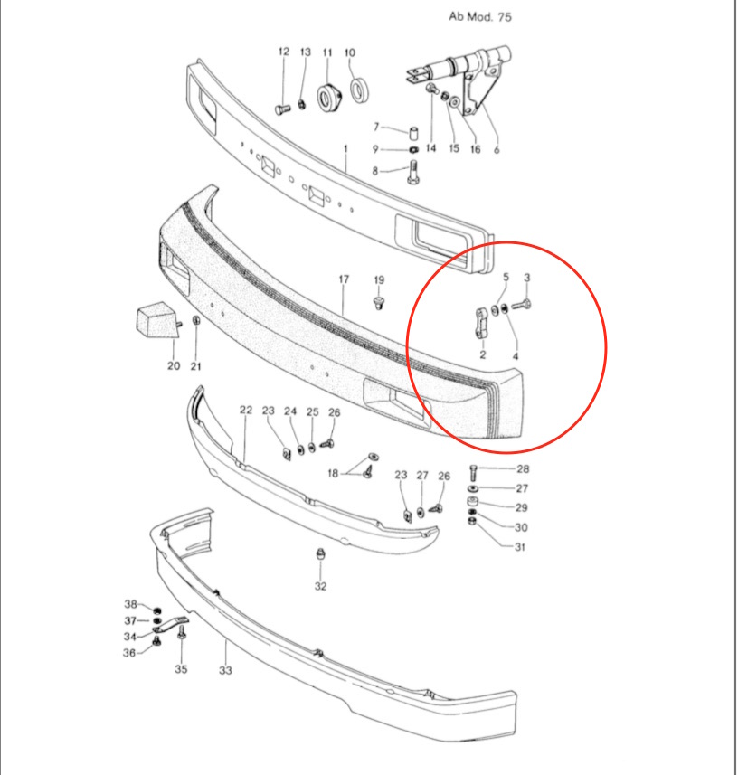

i have two parts books for the 914.
a euro parts book and a USA one.
if you look at your USA parts book it has the same parts diagram images as the euro edition but does not list some of the parts numbered in the listed columns.
thats because they are euro parts. it works in reverse for the euro catalogue.
the USA parts are in the diagrams but not in the listing.
euro parts catalogue for the 75 bumpers.
the dog bones are listed. the collision pistons are not.
the euro parts catalogue does not list the front latch panel as being different to the 74s.
gives it part # 914 502 031 12
the USA parts catalogue lists the front latch panel as 13 rather than 12.
mind you that does not explain the extra lip on the 75 and why they would list the 74 as the same as 75 for euro cars. they still had the big rubber cover that needed to hook on to the panel. (IMG:style_emoticons/default/confused24.gif)
but there is a bit going on with those front latch panels in the parts catalogue if you compare the two different editions of the parts book.
