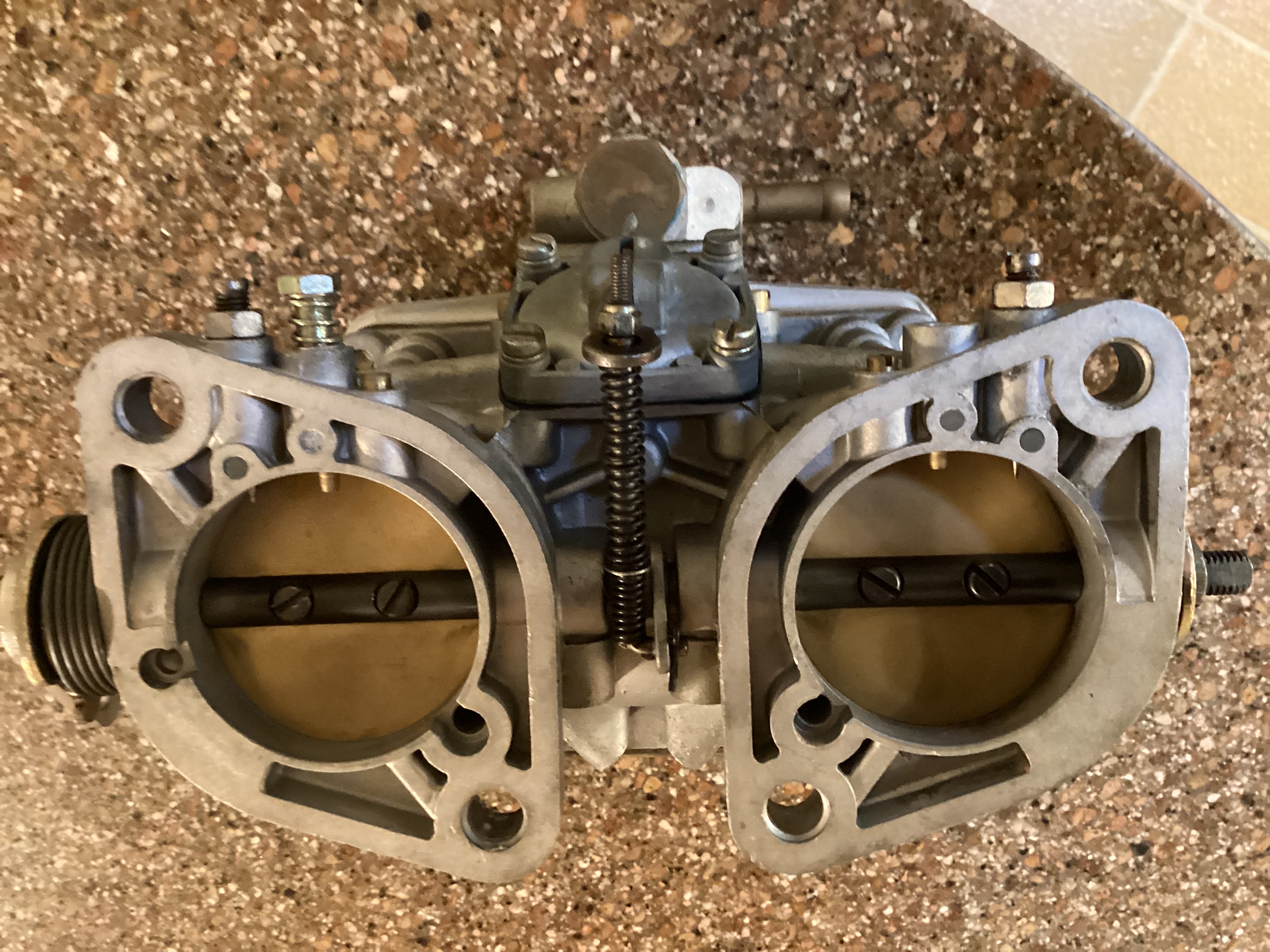

On the bottom of the Webers note the threaded rod. If the adj is too tight the pump jet can dribble. Thomlinson’s Weber book is first rate. I found the Dell manual lacking. Attached thumbnail(s) |

ACN website does leave a bit of the door open for them to return, but I think it has been more than 6mths that it has been closed.
Yes, someone mentioned the pump rod adjustment. They could not remember the setting. But is was to count the threads (probably above the nut). I think he said, like 3 threads??? This one has quite a few more. That book is very popular, and out of stock, even on ebay. I found a HAYNES on ebay for $15. I got that coming. and a PDF version of Dellorto Tuning Manual by John Savage that I downloaded. |

Can you compare the exposed threads side to side? Match the side that does not dribble.
Does the jet in ? dribble when the pump is energized and the engine is not running? If so, you might try backing the nut on the offending side off a bit. Every time you adj something on the carbs, wait a moment for the adj to take affect. They don’t respond like FI. What flavor of fuel pump are you using? |

Can you compare the exposed threads side to side? Match the side that does not dribble. What flavor of fuel pump are you using? Just a quick fuzzy picture yielded similar threads on both carbs. 11 to 12 threads on each. Pump is also from ACN. Do not think ROTARY is a brand. I believe Carter is a similar design. But I mounted it under the tank on the frame of the Drivers side. |
