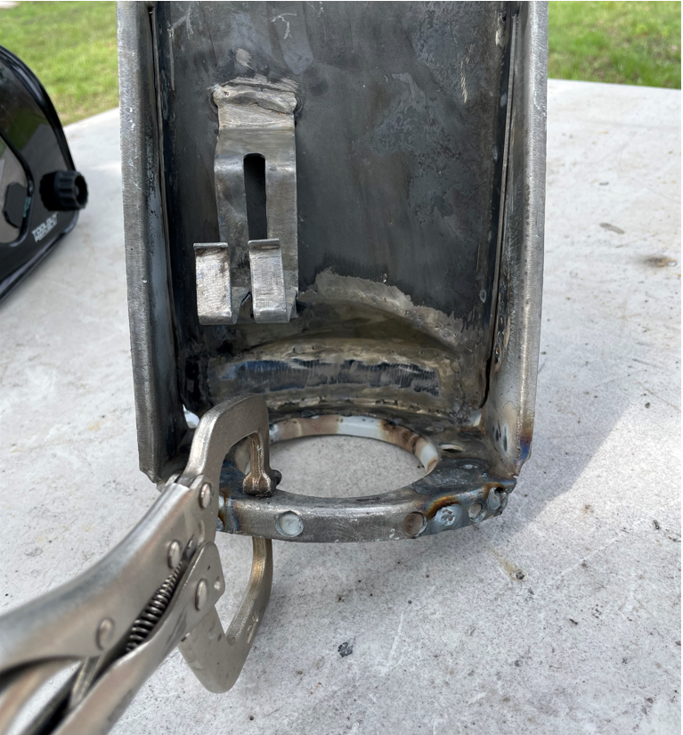

After cutting the new 14 gauge sheet metal, measurements where made and a metal brake was used to create the three simple 90 degree bends.
Here's the part welded on. Note the rust holes on the other section.
The bottom section with the metal replaced and welded in.

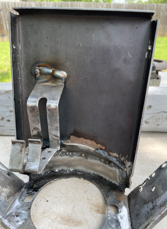

Final welds for the filter mount and clean up before final assembly.
Joining the two pieces. This process was simple but took a lot of time. Had to keep the heat down, especially in the front section that you see here.

Final View with rust preventive paint and weld-thru primer. Not too bad for an amateur. This thing is now rock solid!!
