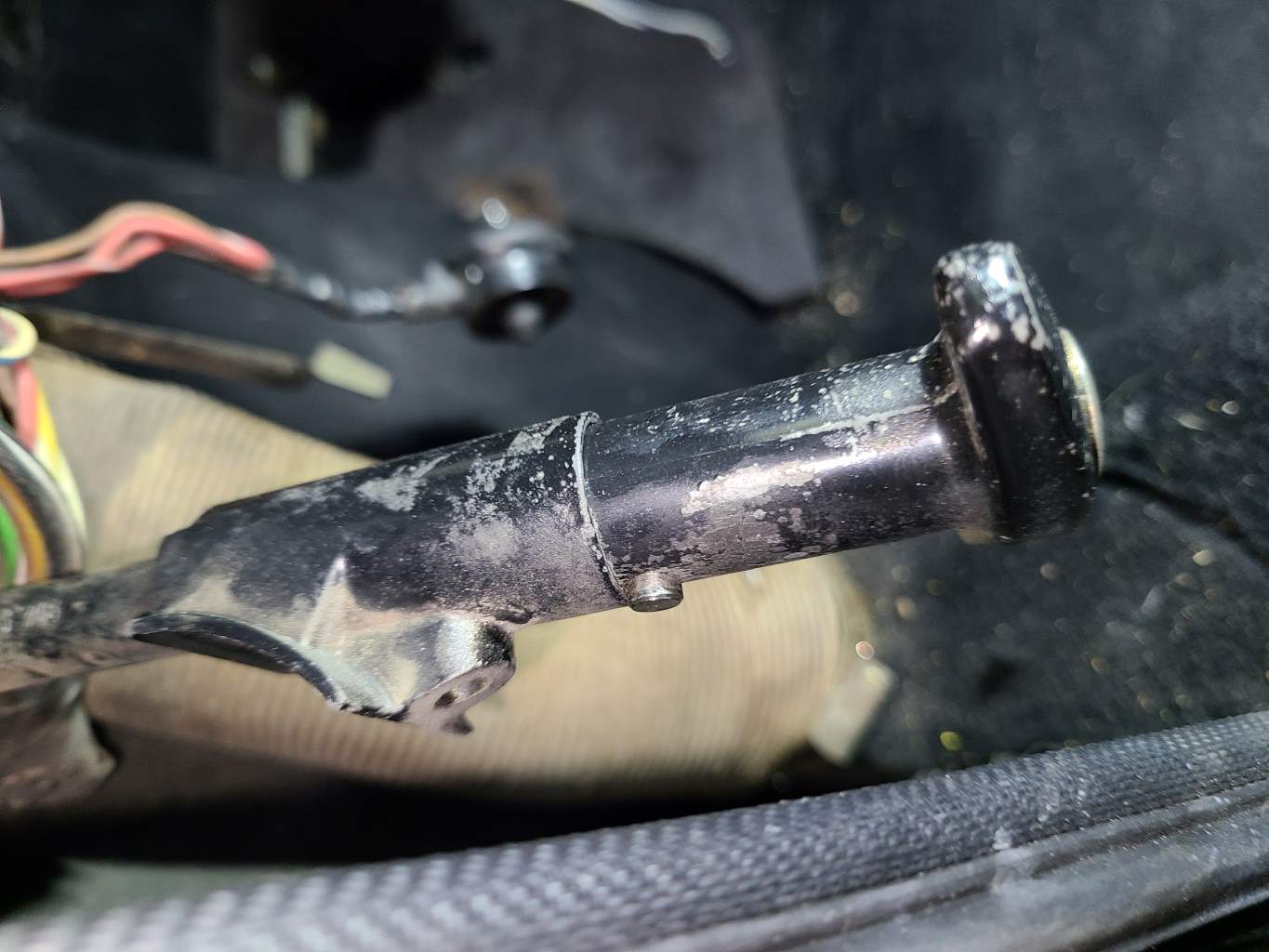

My car was disassembled for painting many years ago and put together hastily. Most things I dig into need hardware, or adjusting or replacement. The front trunk handle is the latest.
It never looked like a stock handle should. There is a chrome cylinder, 5mm to 6mm in diameter sticking up a bit from the handle. That stops the handle from going into the handle mount so the whole handle sticks out a bit and wobbles. When I took it apart, I noticed the small stop screw on the handle slider is not installed.
It does function correctly, just with a wobbly handle in the holder, the holder mount is tight to the car body.
Questions
Do I just press that small chrome cylinder down until it is even on both sides? What does it do?
What are the specs for that stop screw? Cant see any details in the PET.
Will I have adjust the cable or sleeve when I get it put back together correctly.

Wow! I did not know I was playing stump the World today. 100 views and no suggestions yet. How about a pic? Maybe that will help.

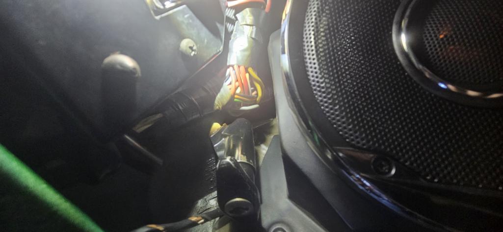

@NARP74 Went out into the garage. Here is what mine looks like installed on my 74 1.8. When the hood is closed the handle should be recessed in the cylinder/mounting bracket. I can pull mine apart if needed to get the stop screw dimensions as it's not listed in the PET. That exposed pin is the lock pin when the key is turned to the lock position that prevents the front trunk from being opened.

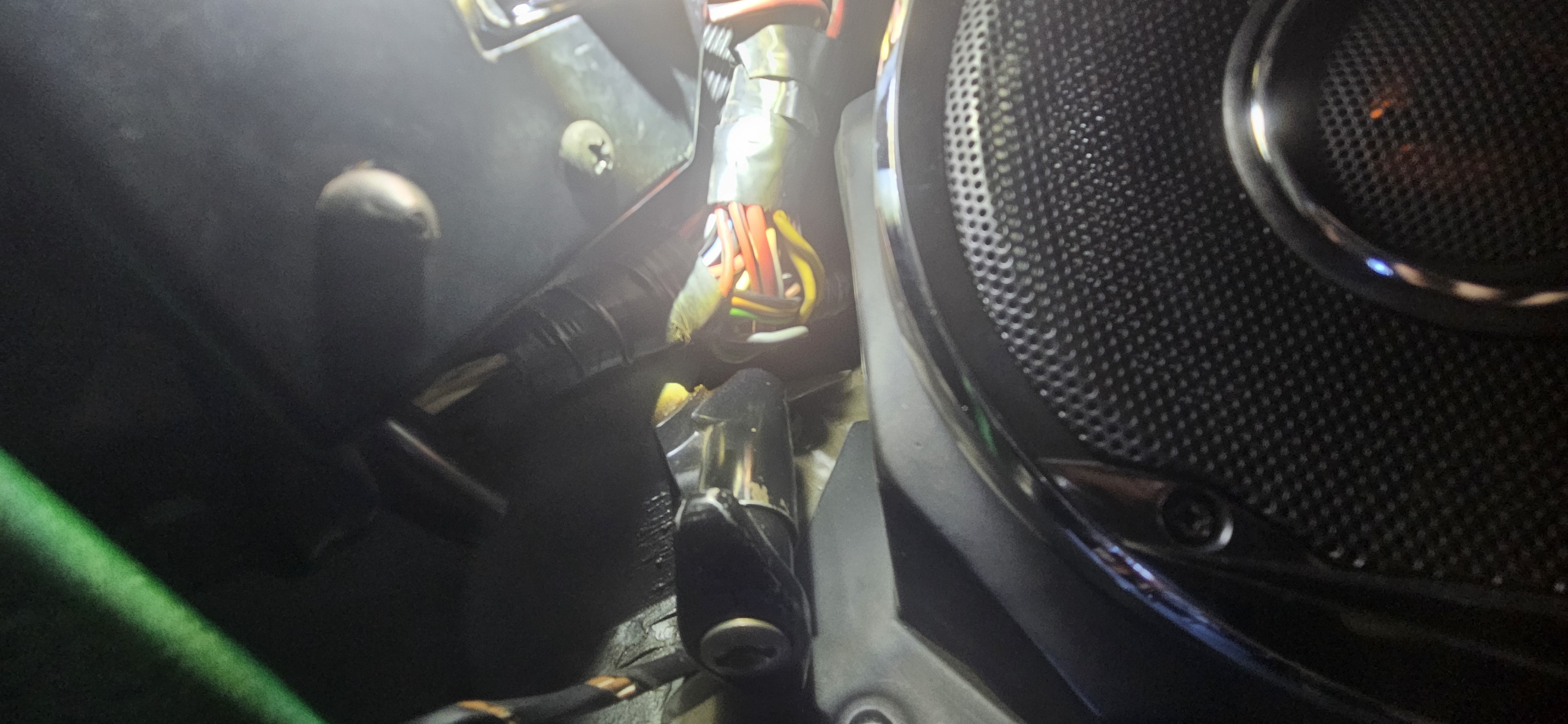

second photo of orientation of the release handle when the hood is closed.

Is it just locked? Looks like the lock pin is out blocking it from going back in.

@L-Jet914 thanks for the pics, that is what I am trying to get to.
@GregAmy , some pics in there showed what I needed to see.
@East coaster I think that is exactly what is going on.
Now to see if I have a key for it.

No way to write this without it sounding like a steamy novel, there was insertion, fiddling, lube, full penetration and manipulation, then success! I found a key that works, got the lock barrel to move and then I could slide the handle fully into the receptacle. Need the specs for that little stop screw and then I can see if the cable and sleeve need to be adjusted and put it back together.
