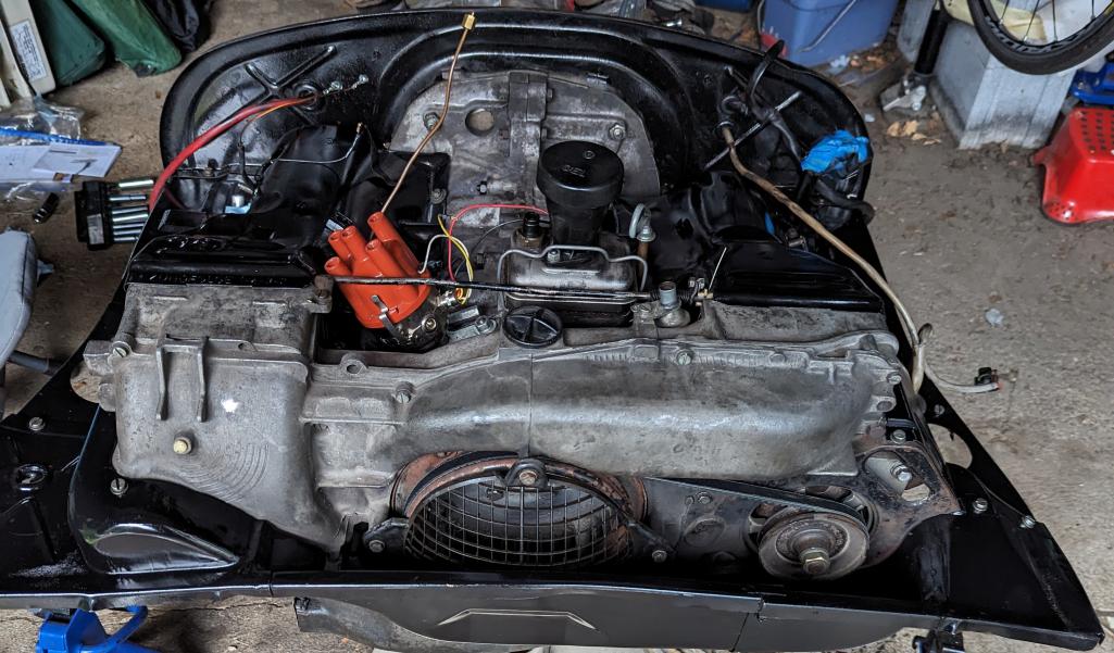

New oil cooler installed. Along with the new sleaves, pistons, and valves (2056, somewhere near 8.4:1 compression).
Question for the hive mind. Should I put the heat exchangers/headers on now or wait till it's in the car? It is not on an engine stand.Attached Image

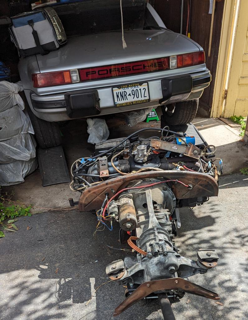

And a little protection...
barefoot
post Aug 24 2023, 05:12 PM
Posts: 1,484
Joined: 19-March 13
From: Charleston SC
Member No.: 15,673
Without an engine stand, you can tilt the engine up on the valve cover (with good padding) & install the upper H/E, then tilt on other valve cover & install the other, Install the muffler hanger loosely. You can do an air leak test on one tube at a time with it's exhaust valve closed.
Easier than balancing the H/E's on your knees while trying to install overhead. (IMG:style_emoticons/default/headbang.gif)
Good luck

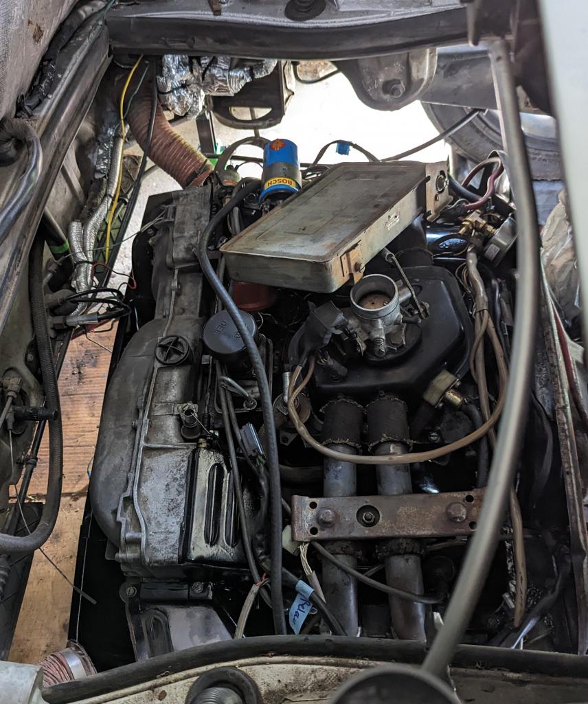

I think I am going to put it in without. No damage, the car is in a nice position for me to work on it comfortably laying on my back. Without the exhaust I can have better access at all the cabling, heat stuff etc.

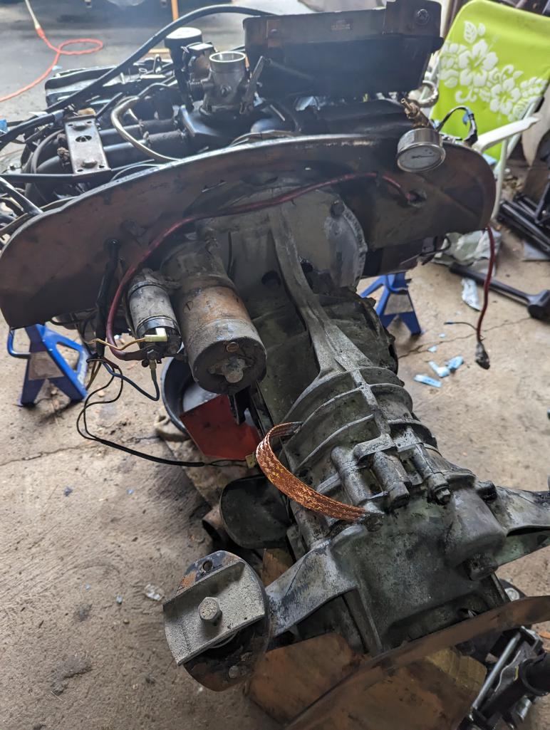

So shiny.

Guess who forgot to do the ground strap before I put the cvs and the exhaust back on... it could have been so easy....

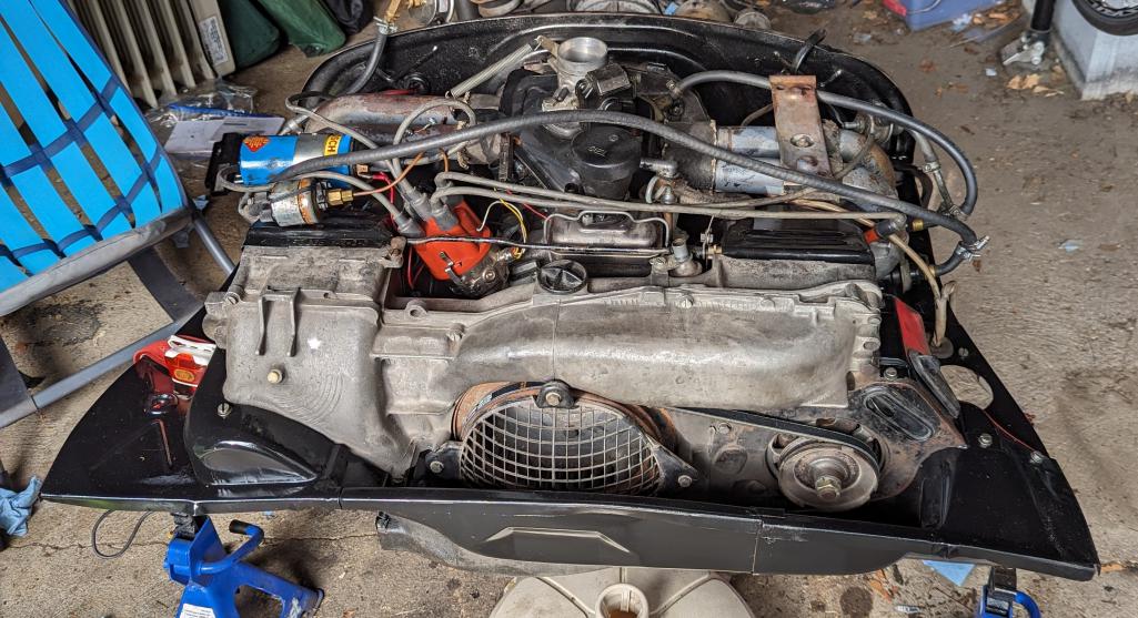

Put it all together this morning up top, turned over maybe 20 times and fired up
