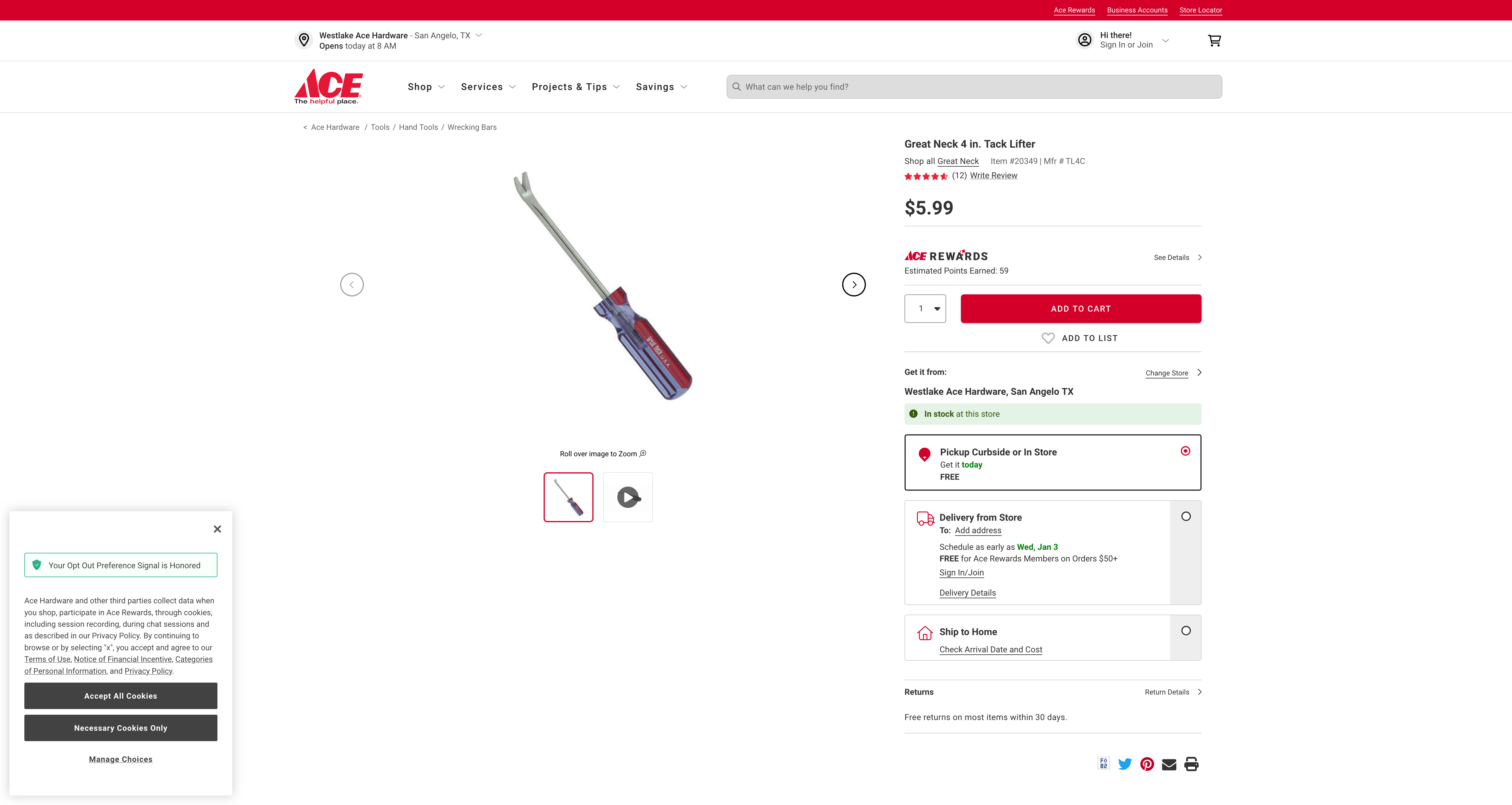

914Sixer
post Jan 2 2024, 06:46 AM
Posts: 9,562
Joined: 17-January 05
From: San Angelo Texas
Member No.: 3,457
My go to tool

Superhawk996
post Jan 2 2024, 09:26 AM
Posts: 8,042
Joined: 25-August 18
From: Woods of N. Idaho
Member No.: 22,428
Forked trim removal tool like 914sixer posted. Rock back and forth - walking it off the pin.
